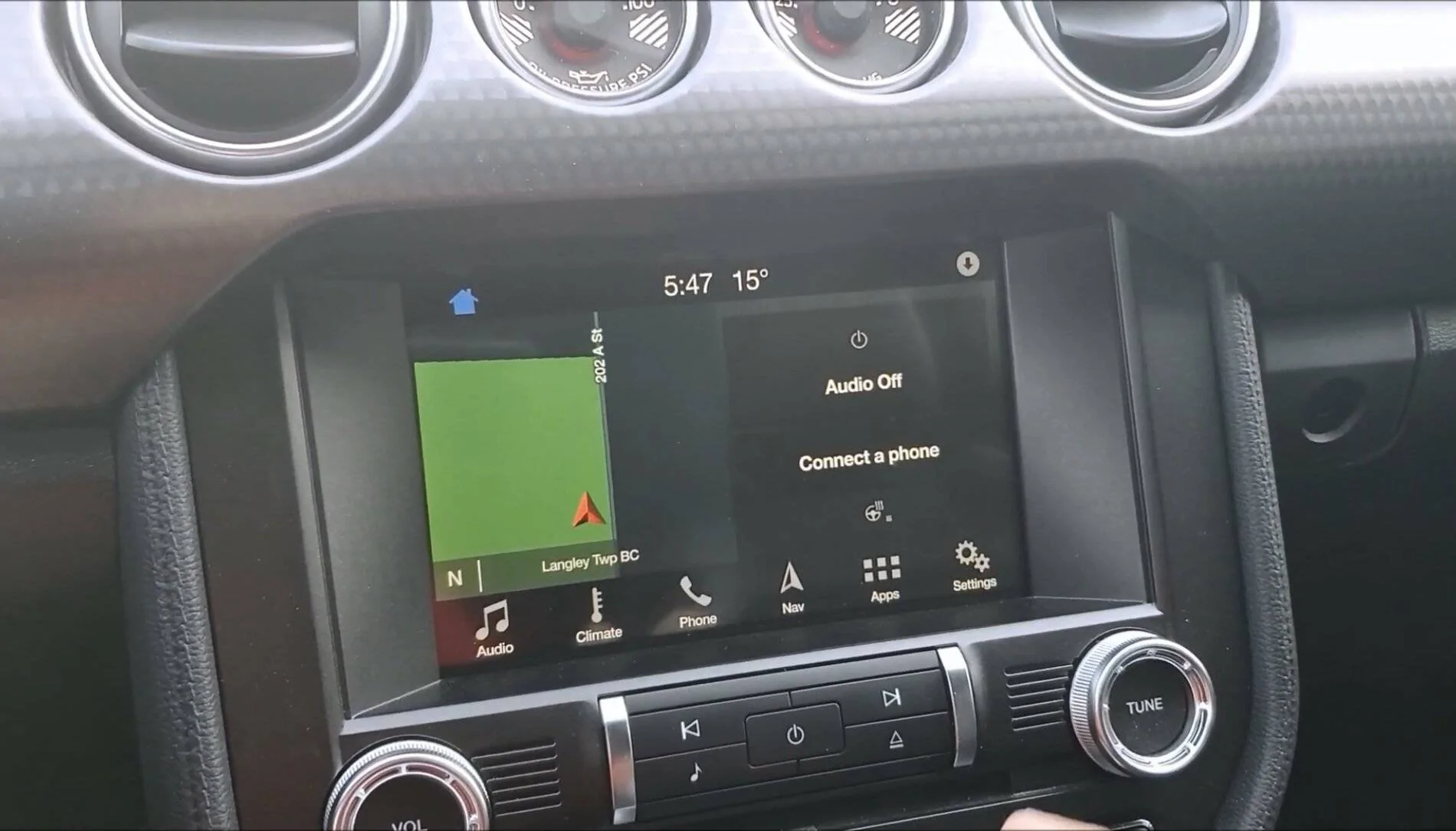

Changed 7D0-02-01 from xxxx 06 to xxxx 10, and got the FP start-up animation (which is exactly what this code is supposed to change), and no GT500, or anything else. Plus it goes great with my dark gray theme:like:. But no shut-down animation with my Lincoln theme, which is perfectly fine with me; I just didn't want any more blue screens :). So the shut-down animation is apparently dependent on the combination of the 2 codes (7D0-02-01/03-01), since there's no specific code just for that, like there is for the start-up (or boot up) one. I actually liked not having a shut-down animation, but would not mind the FP one. Happy both the blue pony and blue Ford animations are gone:clap:. Hope this helps gang.

So the Ford Performance animation is the one with the cobra head and FORD PERFORMANCE under it?
Correct. And the cool thing is now rather than the screen just turning bluish when you open the door, the FP screen pops up. Maybe that's instead of on shut-down with my theme. Does this happen with the Mustang theme as well? Or is it only on shut-down? Just curious.
By the way, my screen shuts down starting at the middle (horizontal line), then black filling up and down, stopping at the top row (where HVAC temp is) for a moment, then going all black. Looks cool too.

What theme is this? Is it possible to have a black theme combined with the stock pony flash screen? I do not want to see ford logo on shut down!
