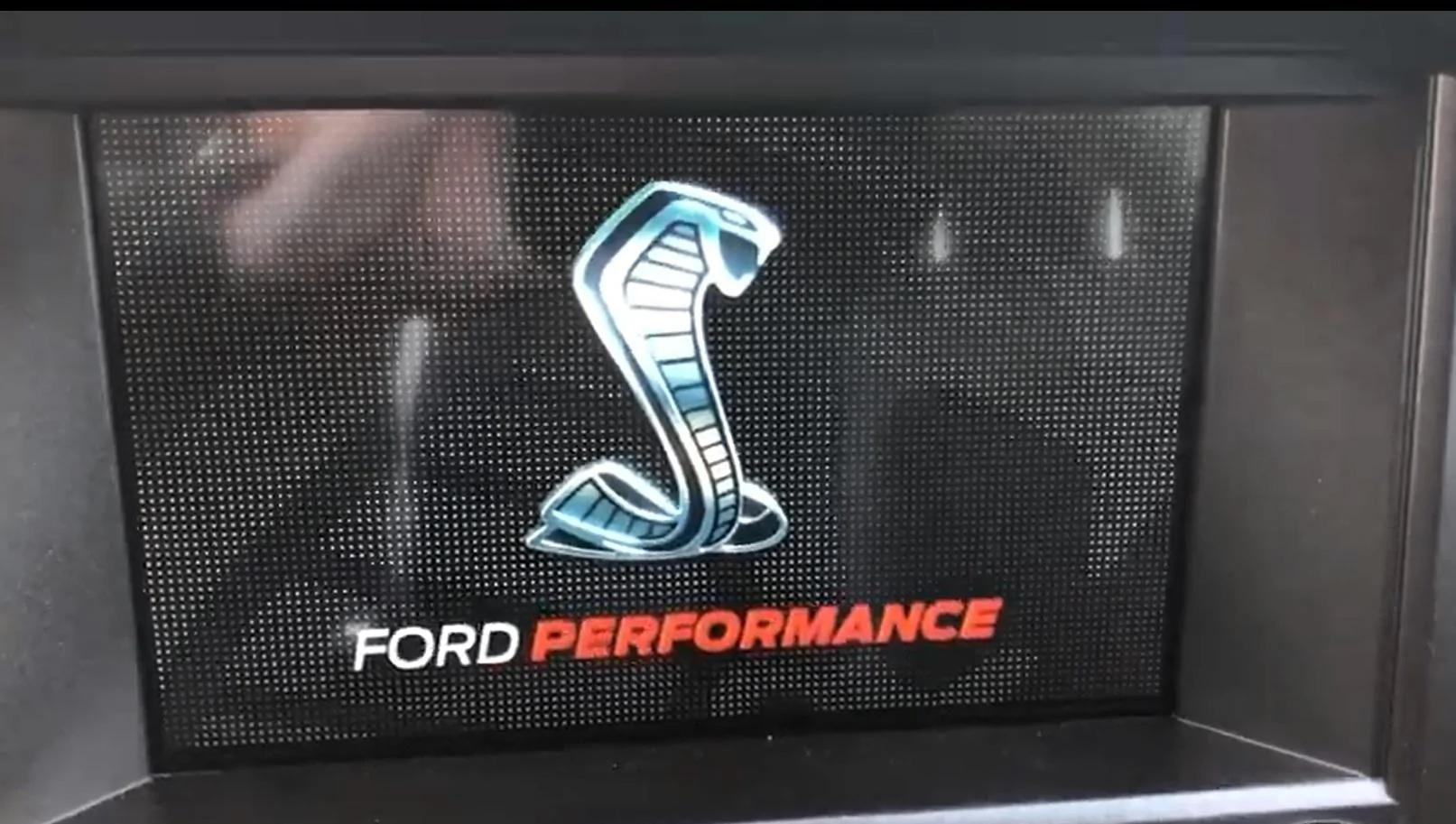

What theme is this? Is it possible to have a black theme combined with the stock pony flash screen? I do not want to see ford logo on shut down!
This seems to be the night theme from V3.3 and earlier. You can't get it in V3.4.
Thank you. I have 3.4 and thats a huge downgrade. Black theme fits much better to the digital dash :(

Yes. Just like pic in first post. Its called Ford-EVO
Hey there,
Is it possible to enable the above theme on Sync 3.4?
If yes, What would be the code combination for this in start and shutdown?
Everytime I enable a Ford Performance logo, I end up with a Blue Ford Logo.
I managed to keep the GT350 for now, But doesn't feel right..
What's the code to enable in start and shut off - the image you have pictured above?
Any help is much appreciated!

Hey there,
Works on mine with 3.4.
Ford Performance ScreenAPIM7D0-02-01 xxxx 10xx xxxx
Ford Performance Screen continuedAPIM7D0-03-01 xxxx x0xx xxxx

Hey there,
Hey just want to ask did the codes give you the Ford performance screen on start and shut down ? I have 3.4 and just went into apim configuration and changed it that way. I have ford performance on start up and that blue ford oval at shut down ..when I open doors I also have ford performance.
Can you confirm changing pictured codes work ? Thank you
