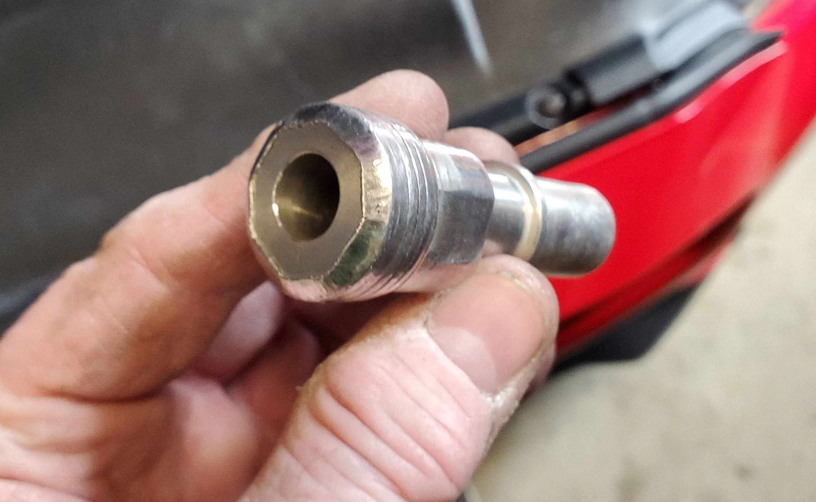

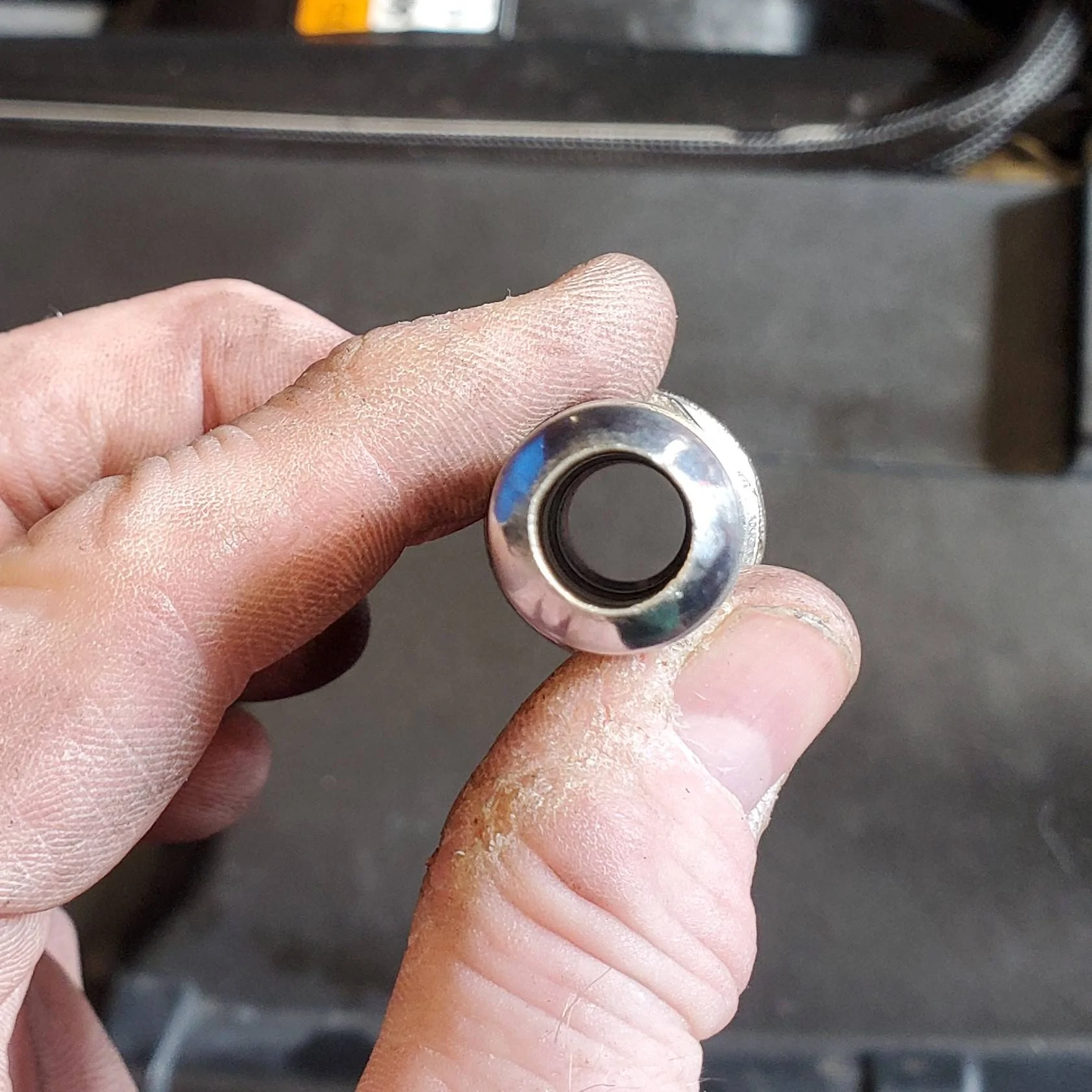

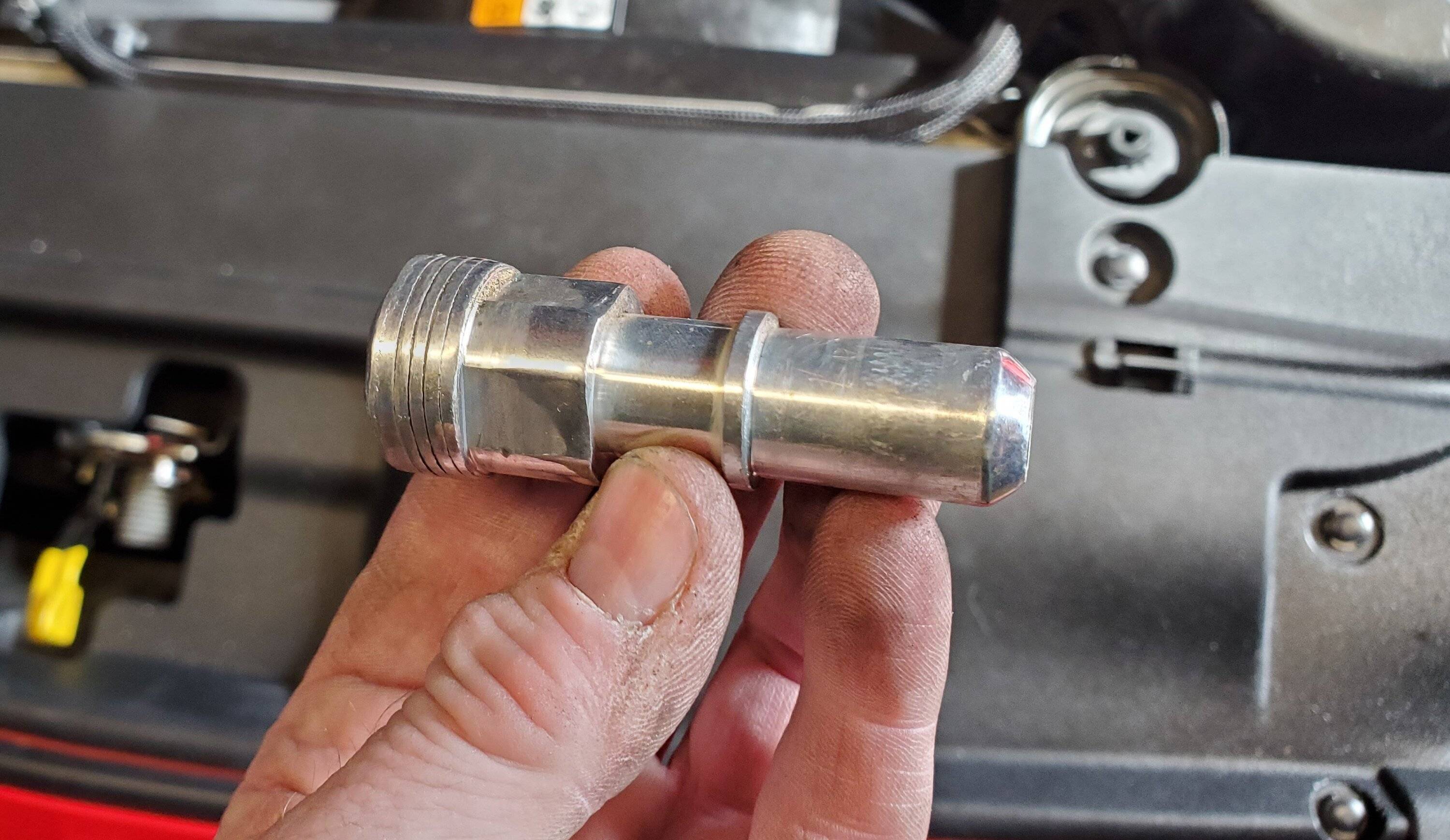

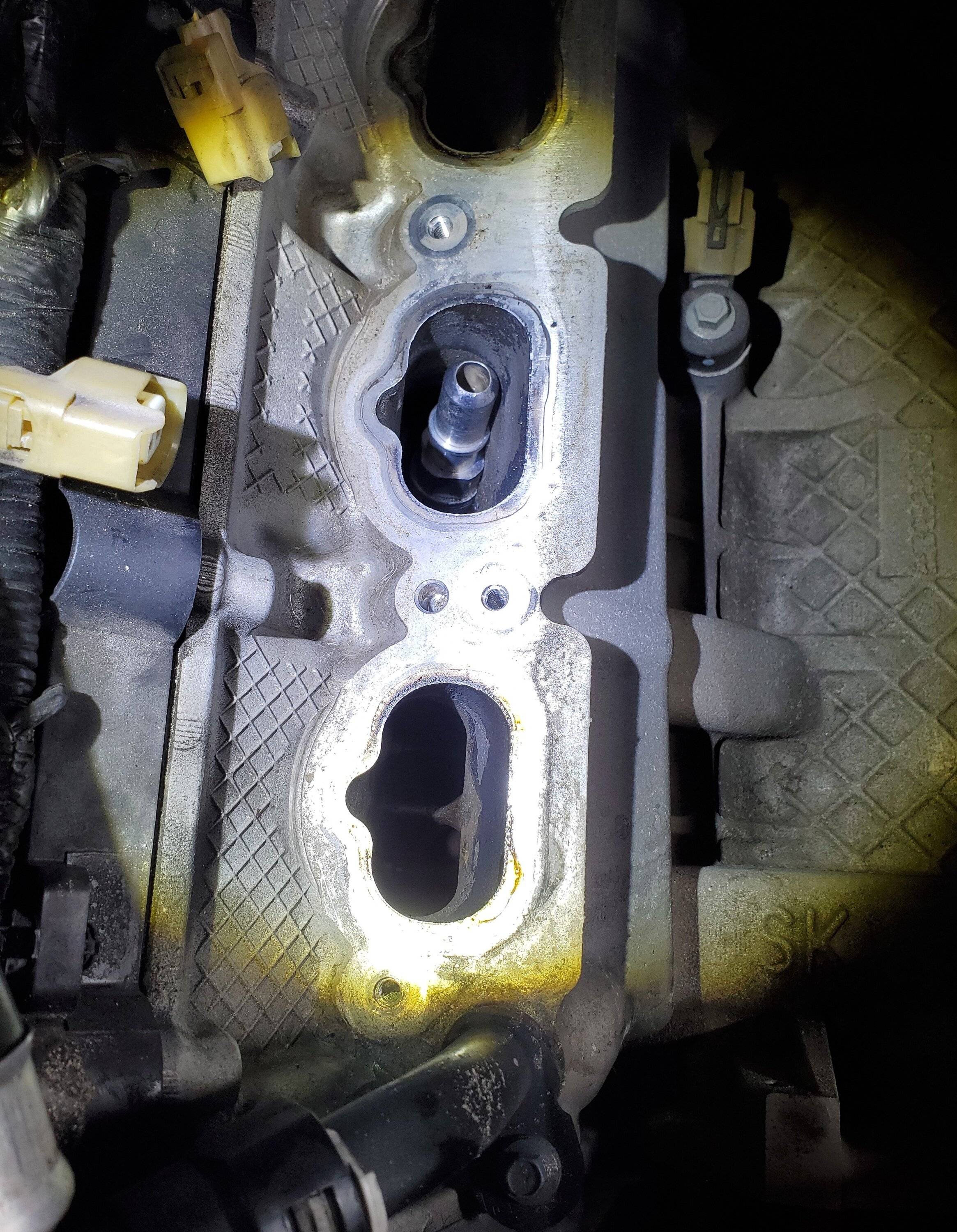

Okay, I do believe I am now pissed off. I am replacing the 2018 intake that is currently on the Mustang with one from a 2016 GT at the same time as I am doing the Lund 91 tune. I am also replacing the 47 lb injectors with new stock ones. I have new plugs to go in it too and plan on changing the oil shortly after it's up and running again.
So, I mosied on out to the workshop this morning to remove the existing 2018 manifold so I am all set when the 2016 manifold arrives. No issues removing the 2018 manifold. However, when I lifted up the intake I thought "That's odd... what is that shiny piece that is just sitting there in cylinder 6?". I pulled it out and then thought "WTF????".
So, WTF is this? Looks very similar to the end of a garden hose.

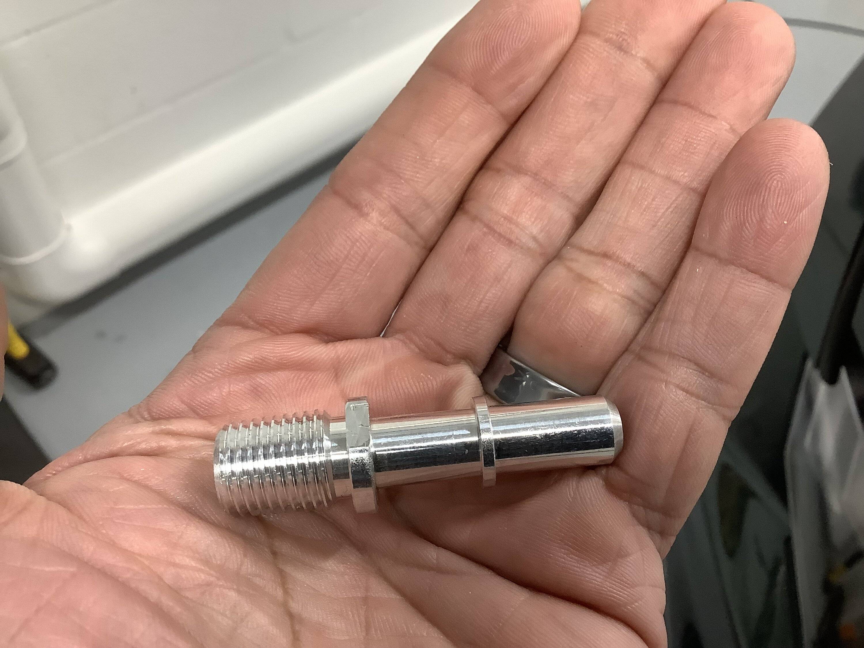

Wow! I can understand your frustration. That‘s a very large nipple to have been missed by whomever installed the intake manifold. I wonder if it was a blatant case of sabotage? It looks like a nipple for a CAI. In fact, here’s one from my PMAS that looks similar to what you found in your engine.
I’ll bet that thing rattled like crazy and caused your knock sensors to go haywire and pull timing. Definitely a valid reason the be pissed.

Sorry for your troubles, that is absolutely ridiculous. Whatever that piece is, it looks like it took a beating on the large end.

Just for good measure, I’d be inclined to hook a shop vac up to each port and make sure they’re all clear of debris.
Yup, already done. I hit every nook and cranny I could reach. Lots of sand in spots, almost like this car lived in southern Florida. Up here you'll find rust and cheese instead.
