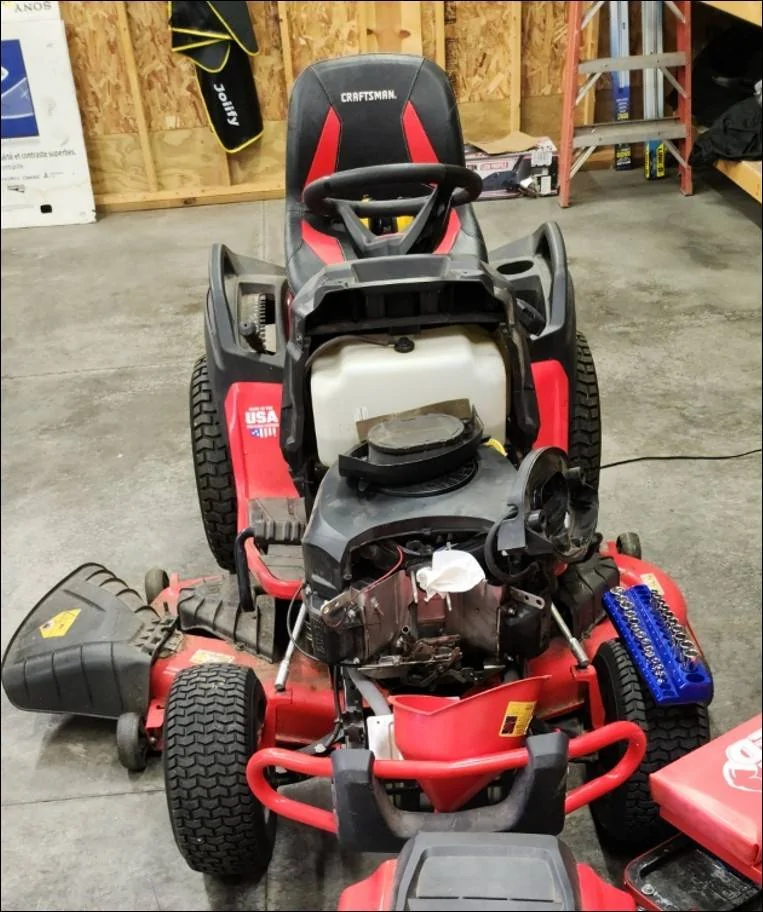

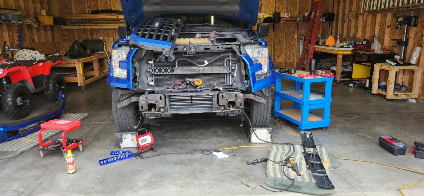

While I collect parts for the digital dash project, it's time to try to catch up on a few other lingering projects like the faulty Rostra Front Zome front parking sensors on the F150 and the fueling issue on the lawn tractor that causes it to stall out on sharp left turns only. No sign of any wiring issues, the carb has been taken apart and cleaned and new needle and gaskets are on the way. And I have new front brake calipers and rotors I still need to install on my wife's Kia, but my lower back is sore and it's too hot/humid out. And I can't work on the newly inoperable rear parking assist camera on my daughter's Fusion until Sunday at the earliest when the aftermarket camera is due to arrive (no high hopes it works worth a darn). Gee, too bad I can't cut the 1.5 acre yard now either.
