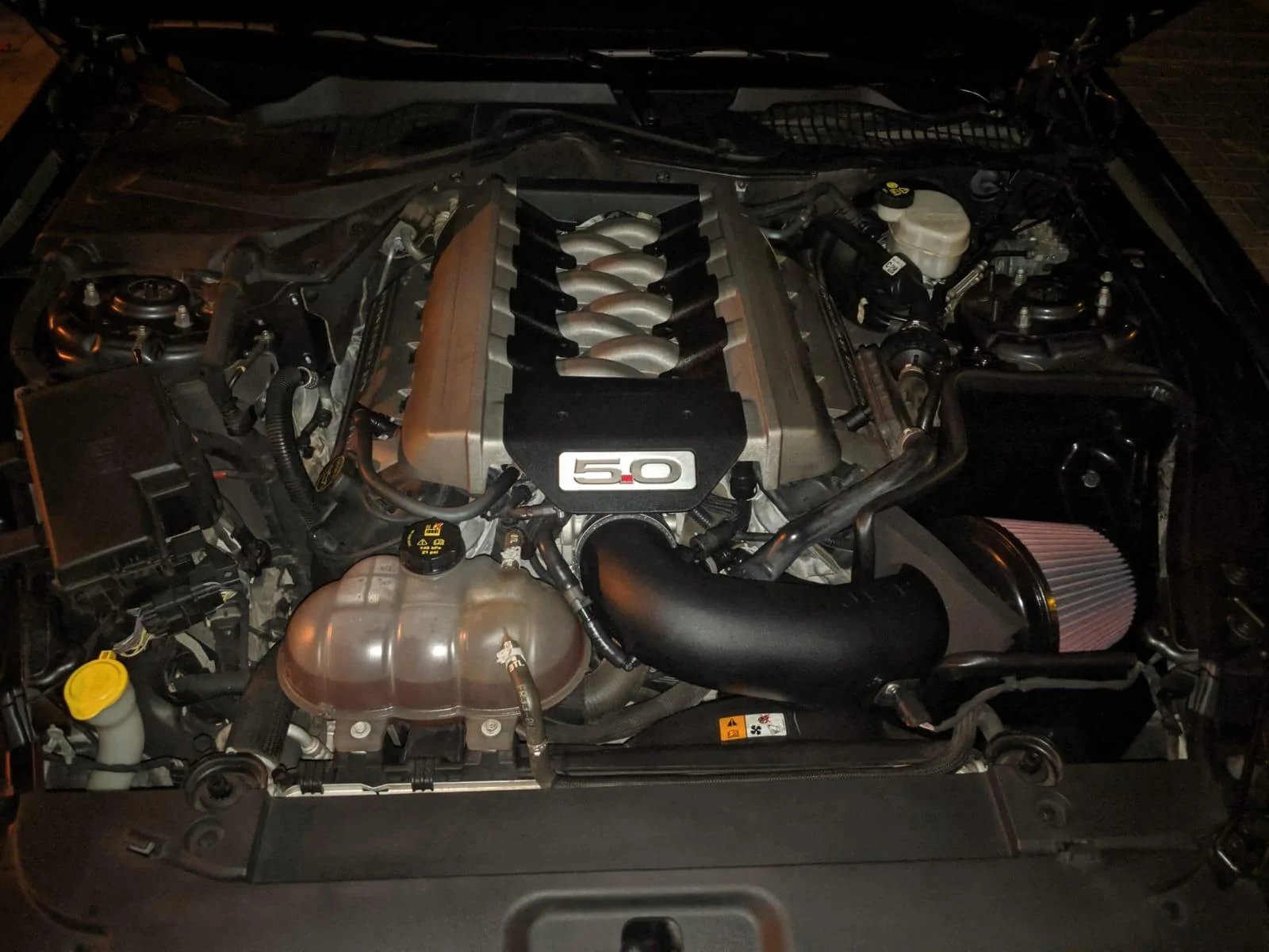

Header on, Cold air intake on and the chin lip is on.

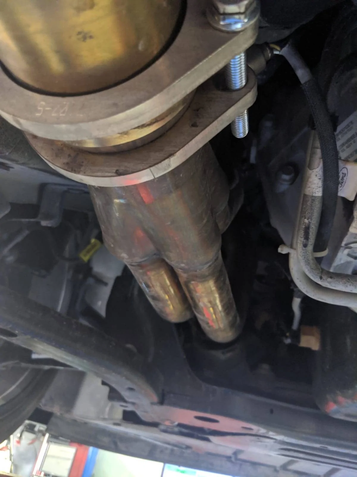

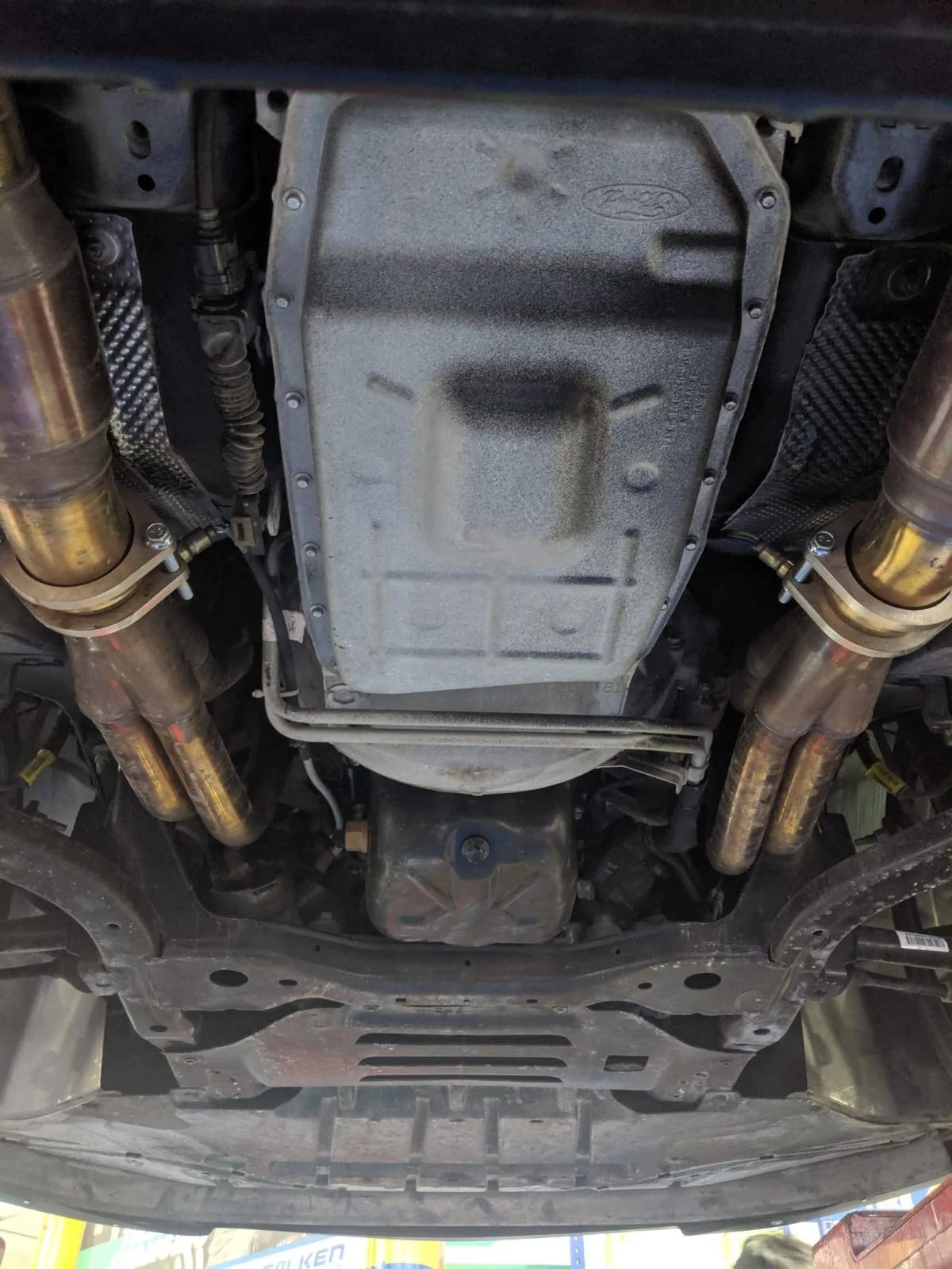

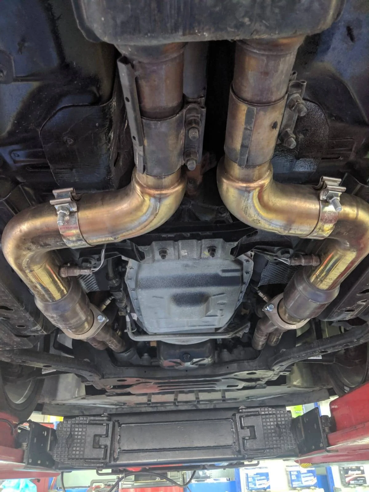

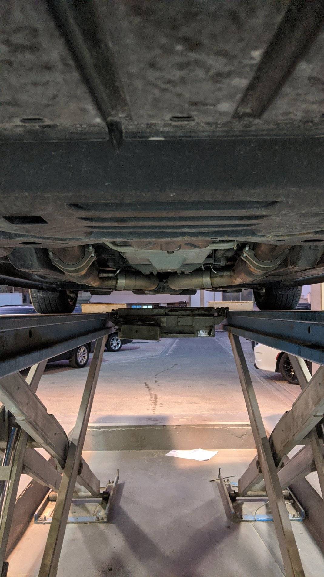

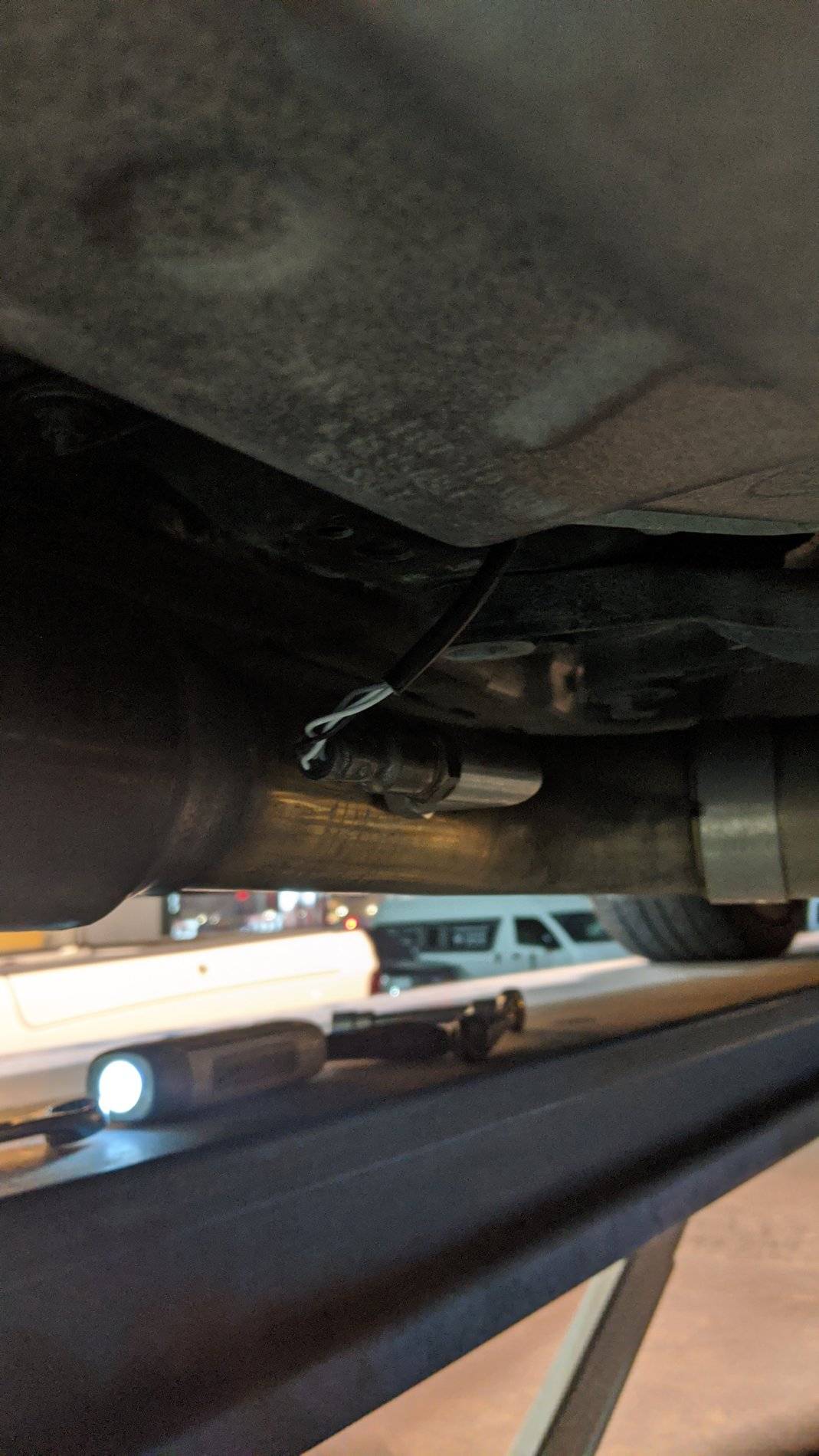

Here is photos for the headers from underneath the car, fitment was nice, was time consuming according the shop
Currently I am facing the code P0420 for the O2 sensors, Just ordered a big daddies spacers hopefully it will fix the issue.

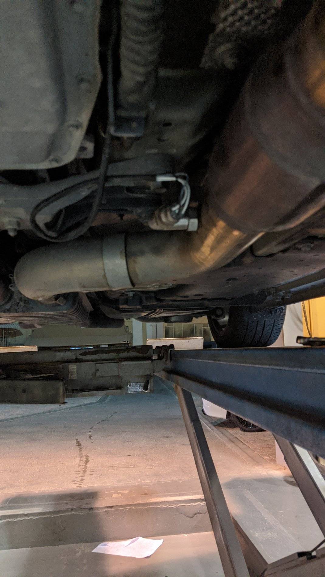

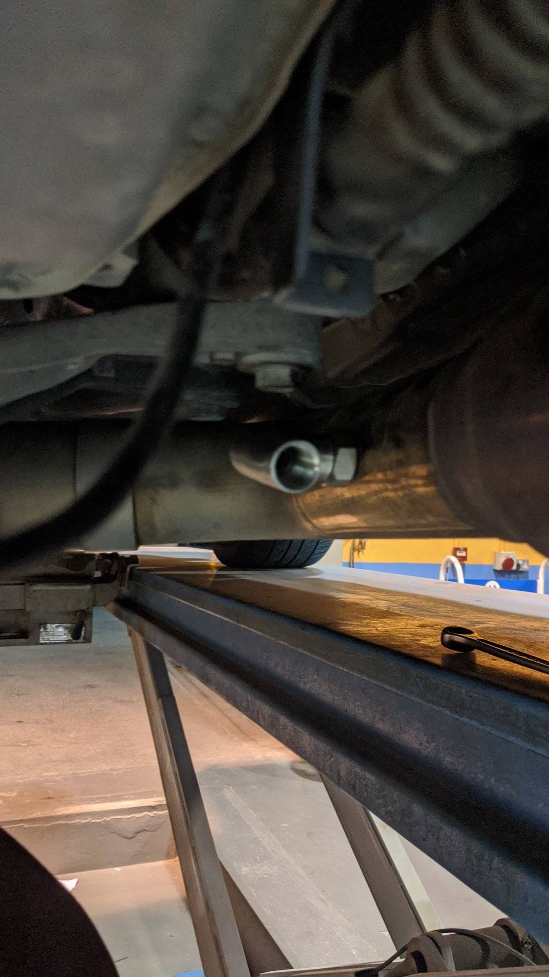

O2 spacers added to solve the high 420 code
Airlift 3p kit purchased and installed and tweaking it atm to fix issues with the bushings
to fix the O2 spacers in the pipes I had to take 2 bolts off the transmission mount one by one and still short about 2mm so with some pulling on the pipes was able to rotate the spacers in place.
and here is some more photos for spacers
Cleared the codes and drove the car for about 1000 miles so far with no issues .
so I assume its gone hopefully , if they comeback i would add the mini cat to it.

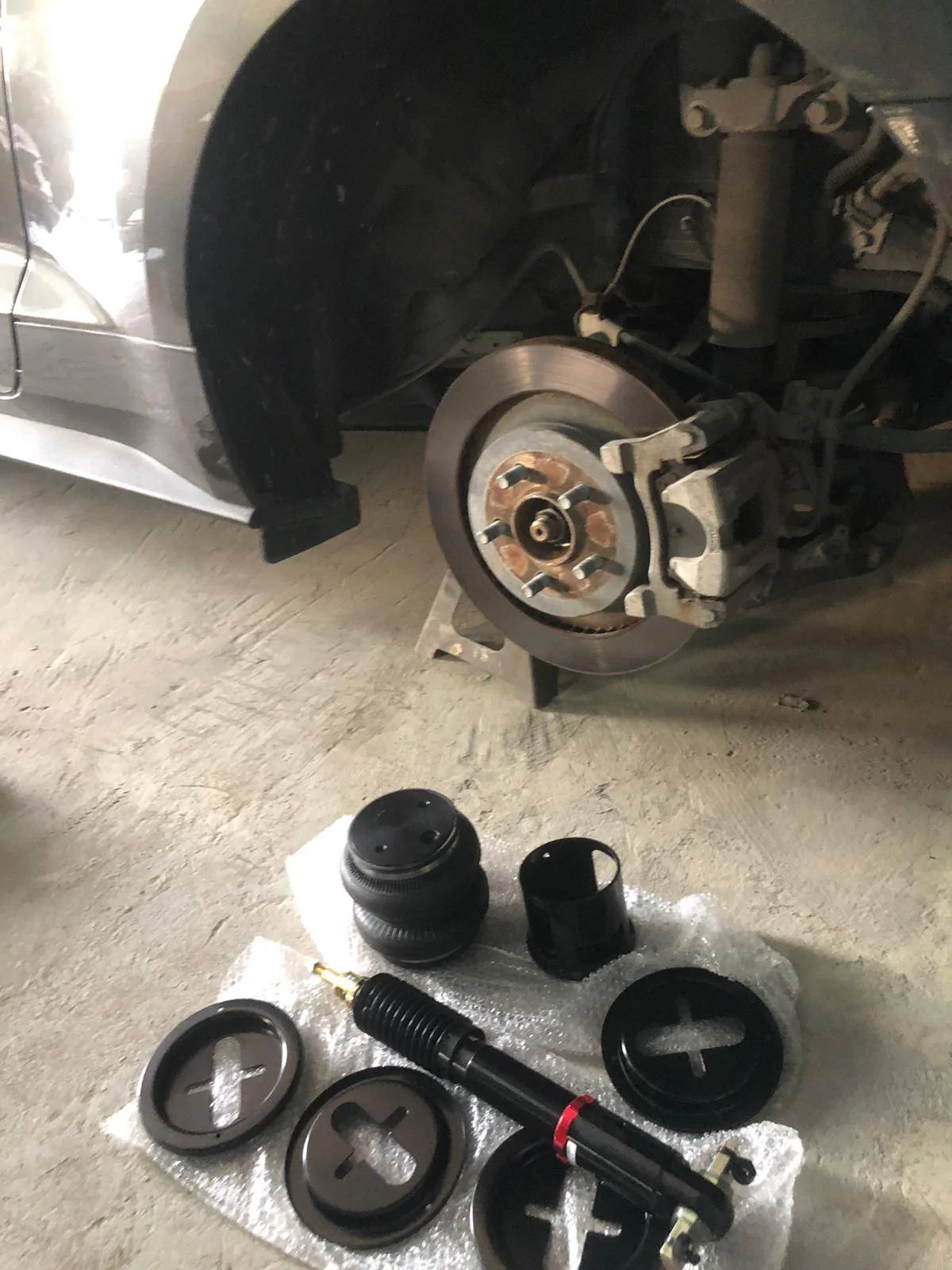

I had the 3p kit for few months till I actually had time to get it fixed into the car
took it to a friend's garage who did many universal kits on multiple cars.
the next day he called me the car was ready-ish ...

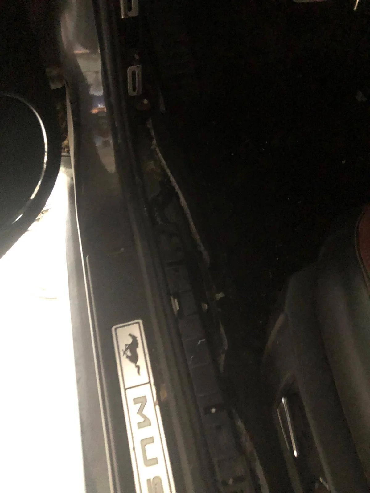

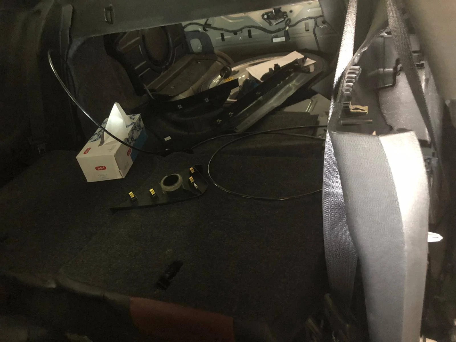

all hoses passed inside the car under the carpet and panels
The trunk is not exactly done we had the airtank and compressor mounted on a wood plank for the mean time since I am planning on putting everything inside the wheel well

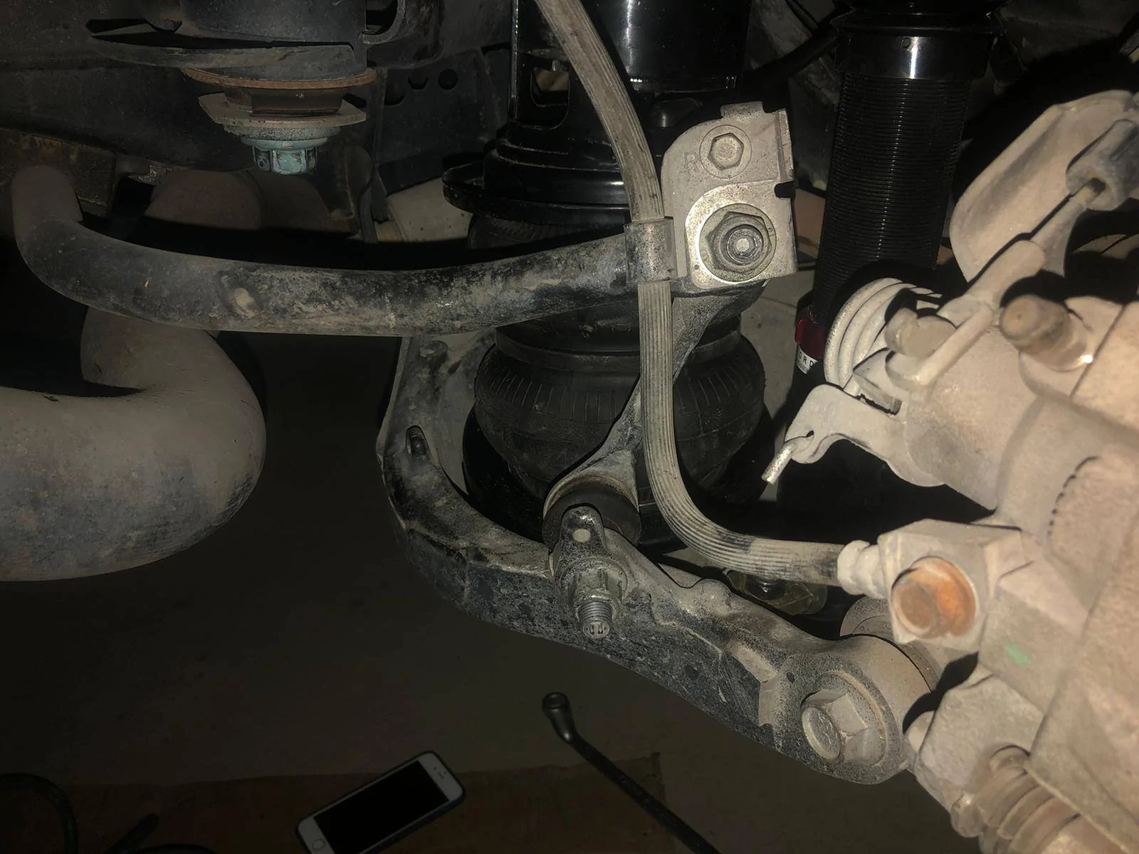

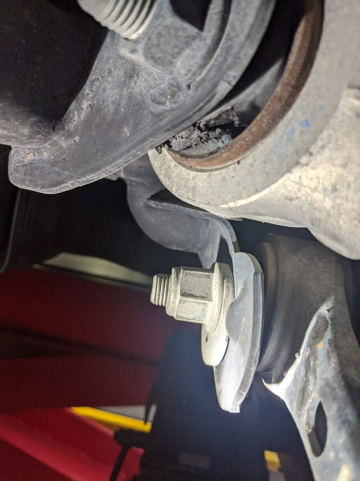

an issue I am facing now is the control arms bushings .
couple of weeks into the kit the driver rear side bushing gave up.
and couple of days ago the passenger side.

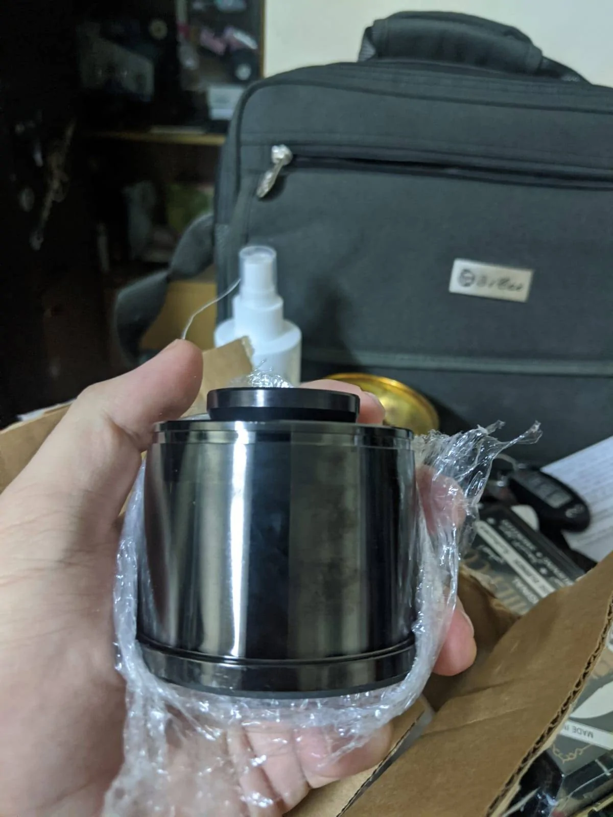

luckly I already ordered the BMR bushings and they come in pairs .
and will take it to get fitted next week

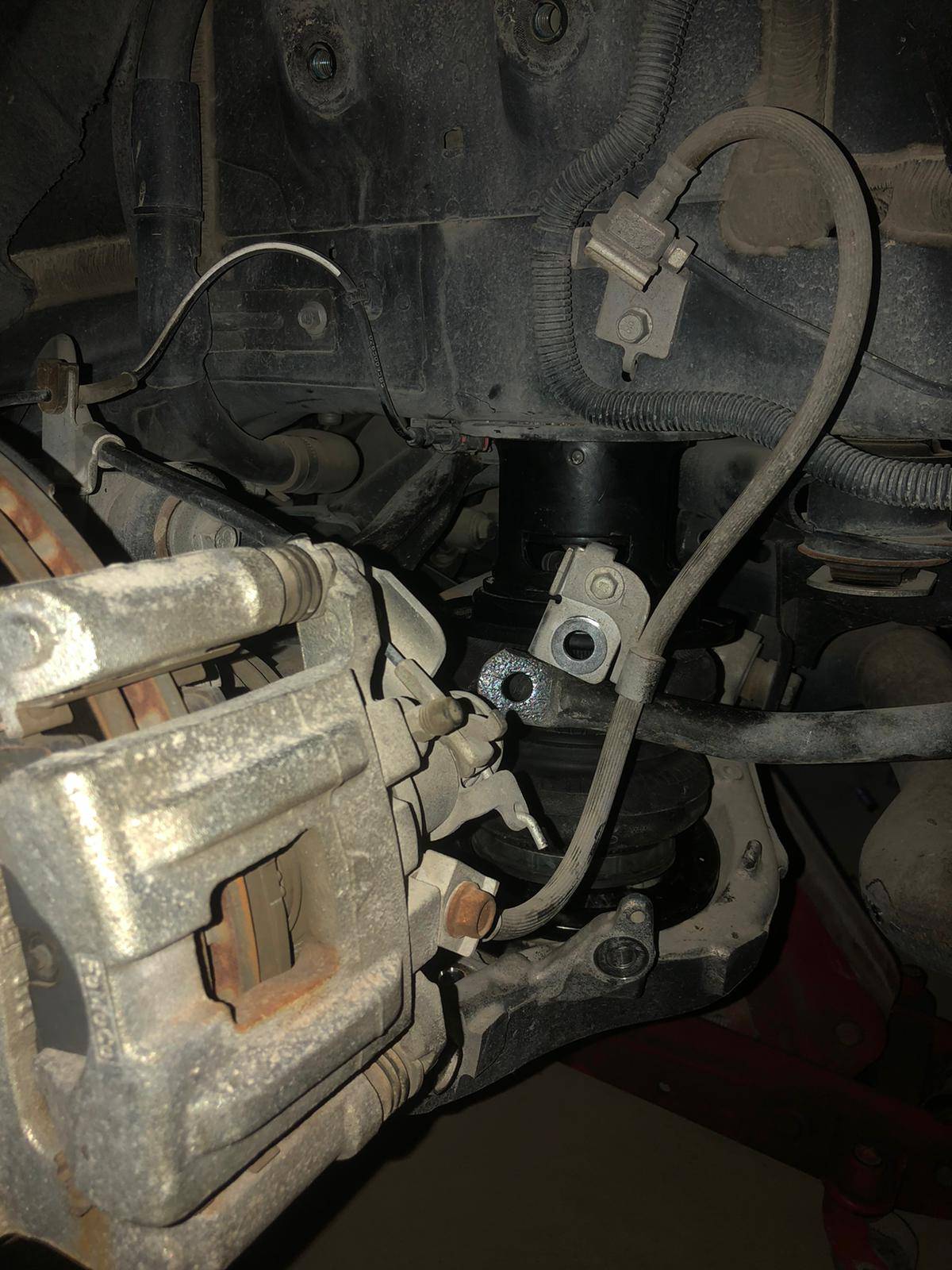

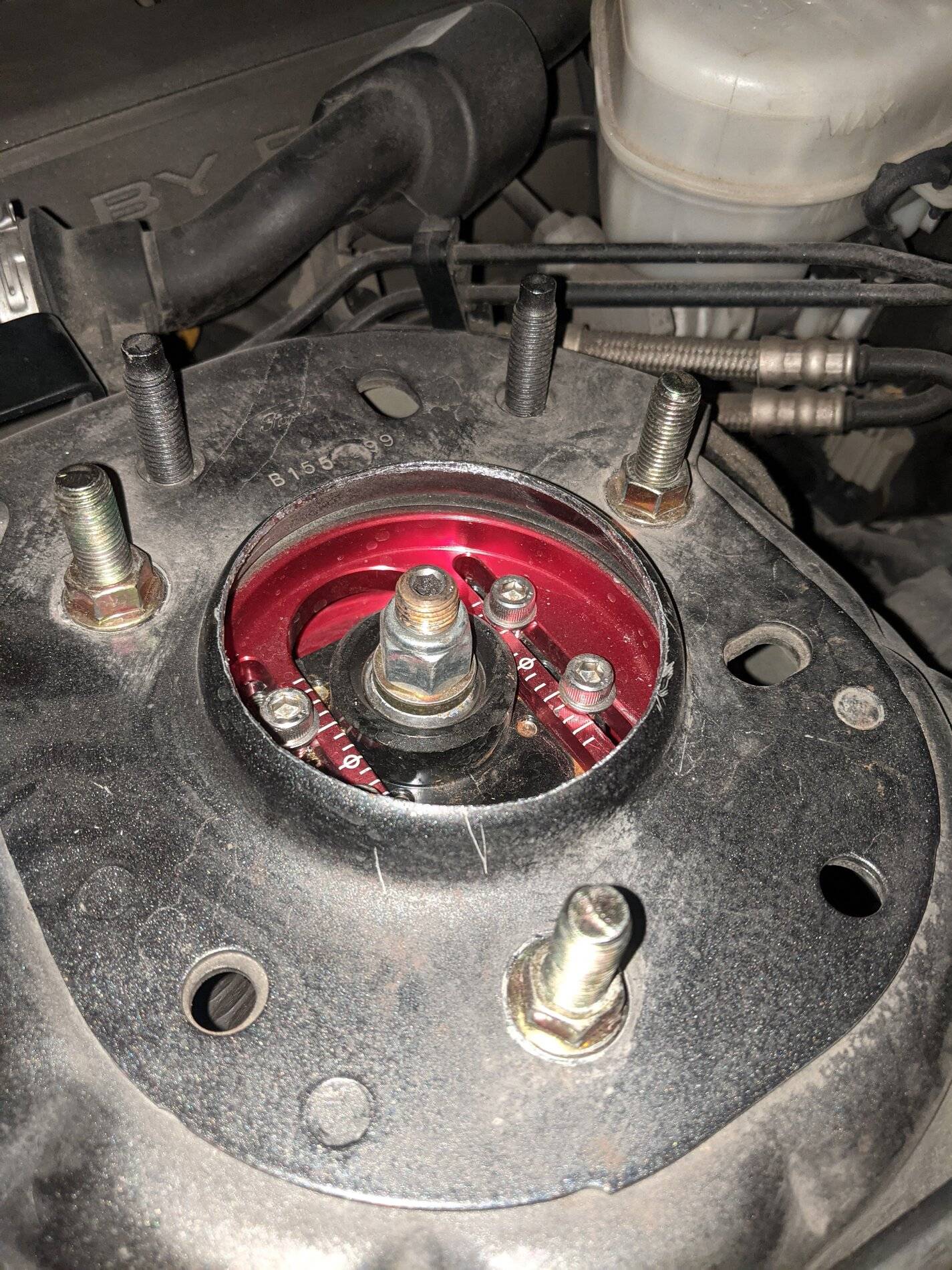

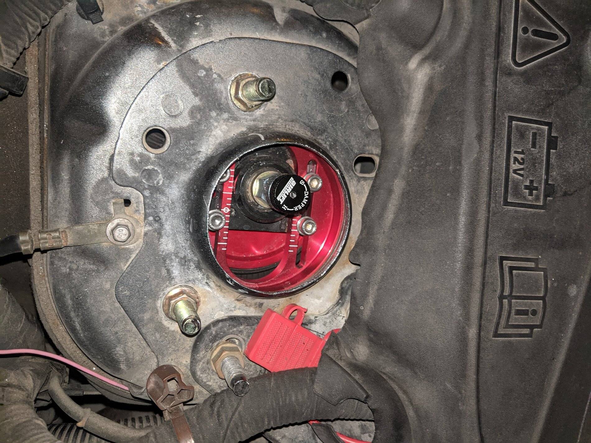

Another issue faced me when I wanted to do the aliment was the bolts placement and our small strut tower opening.
as you would not be able to reach it
after contacting Airlift seeking advice and with multiple email with Scott , such an amazing dude and helped me a lot..
I decided to cut the top of the tower.
and since it was the weekend and the garages are closed ... and I could not drive the car pulling left .
I decided to use my trusted Dremel and do the worst cutting job in history of cutting , but its big enough to reach the bolts..

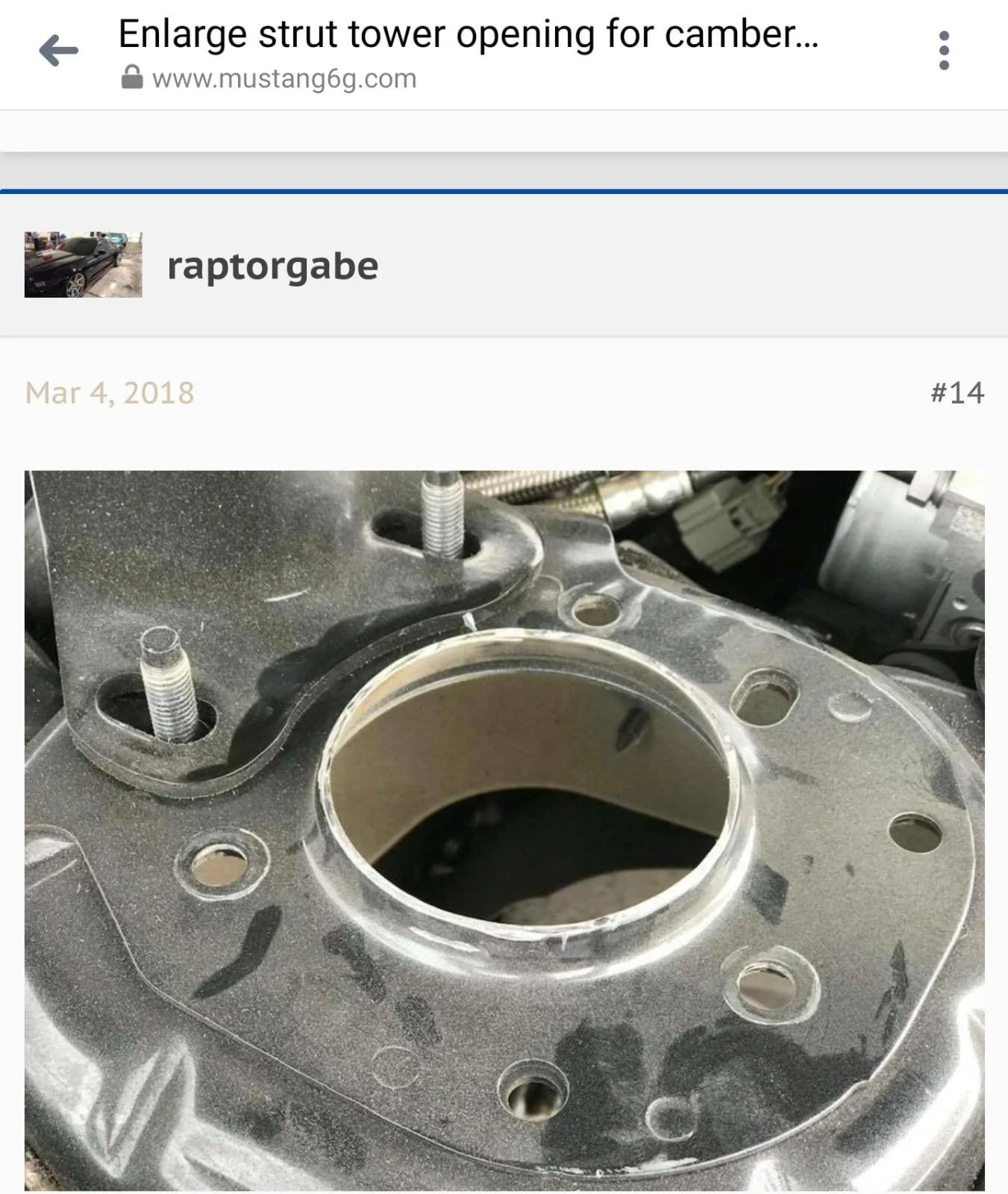

and ofc I wont leave it like this ,... in a couple of days I am taking it to the workshop to get it cut in a clean way such as this post I found .

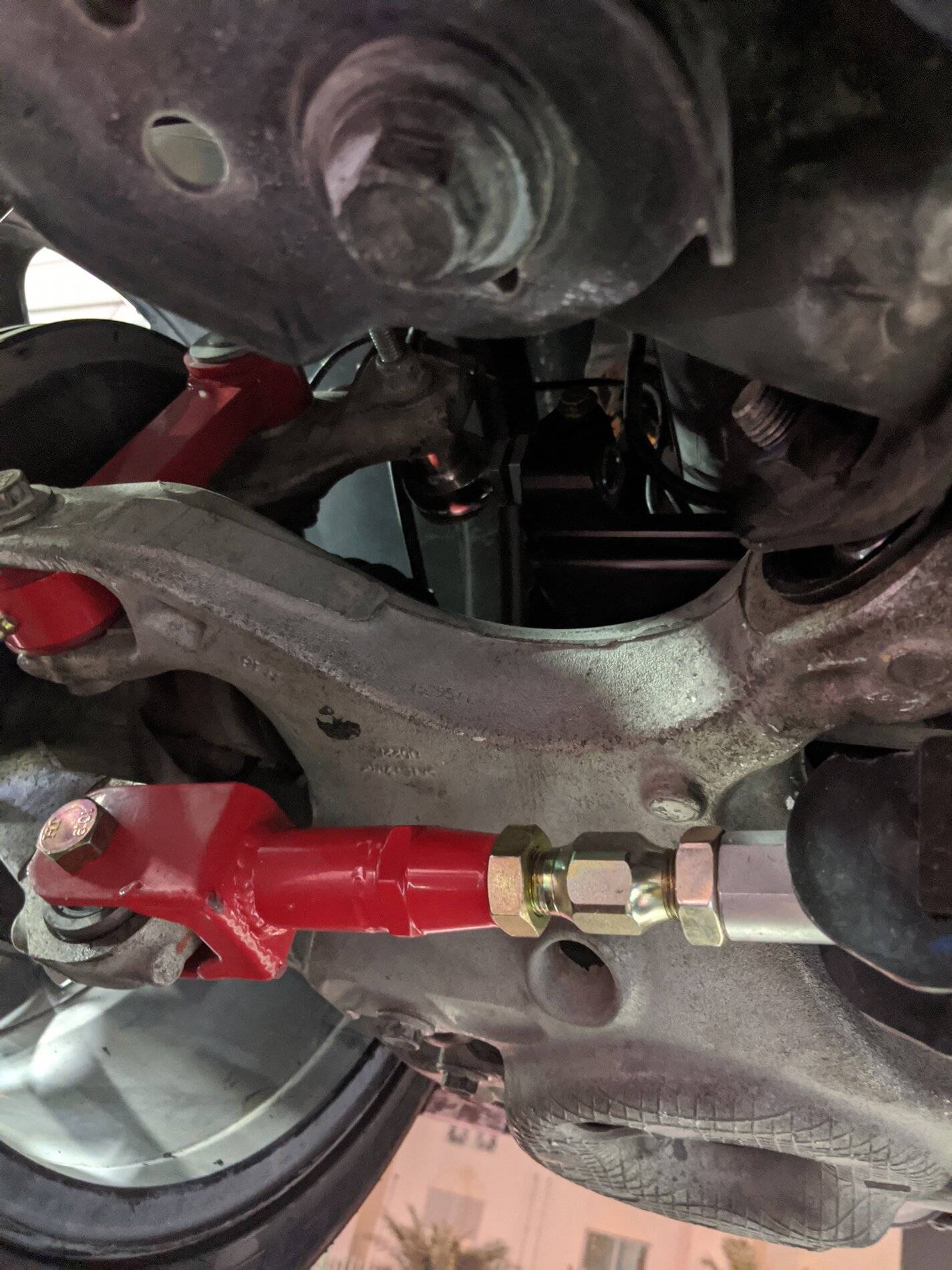

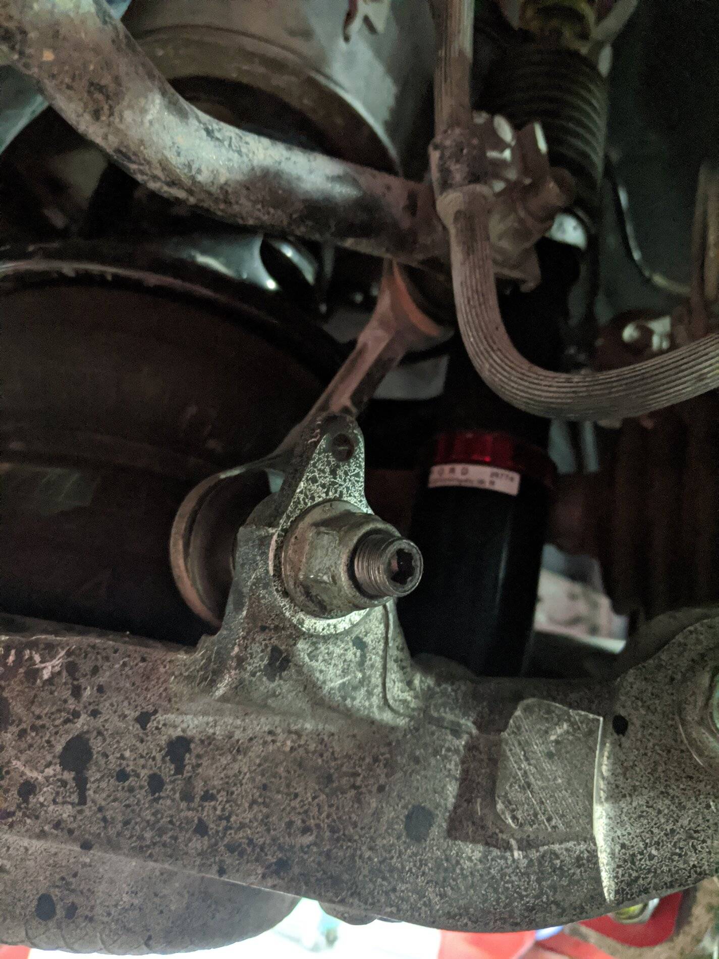

The clinking sound from the back turned out to be multiple busted bushings ,
I am talking control arms , vertical links , upper camber arm , knuckle to toe link
so I ordered everything from CJponyparts and AmericanMuscle and waiting for delivery , ( except that the upper camber arm from BME is now out of stock ) after I ordered it , hopefully it will be restocked soon .

BMR rear bushings and upper rear camber kit etc
Fits everything on the car

I did fix the horrible cut in the front and it looking clean now , and I installed the damping knobs , sat then to 7 clicks from soft side

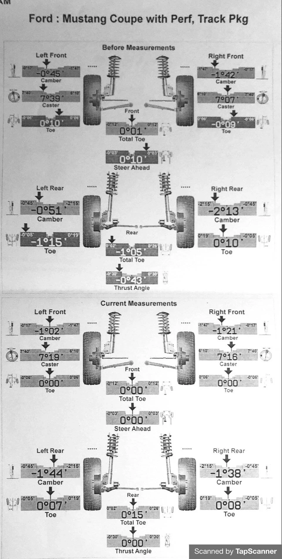

Alignment paper before and after
