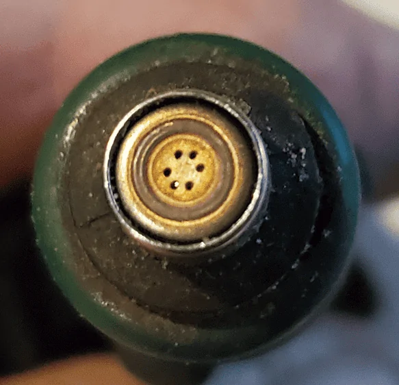

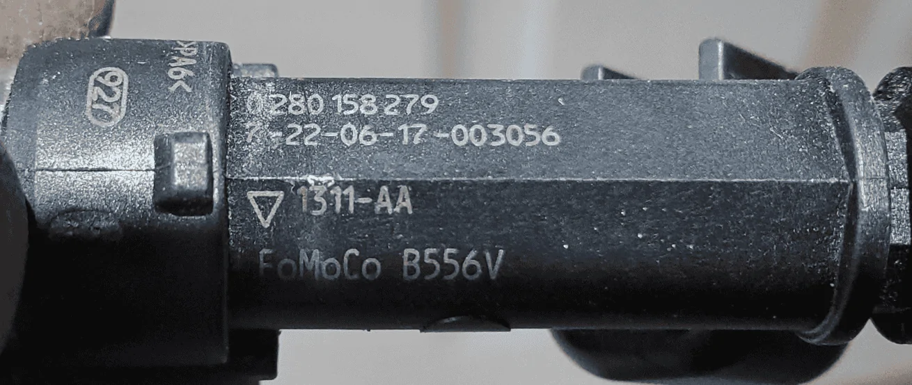

I pulled the injectors and it looks like they are 47 pound, just like what I was told is used with an E85 tune.
I was also told that the part number by itself won't necessarily tell you for certain it is a 47 lb injector but that the injector has to have 6 holes. The ones I removed do all have 6 holes.
