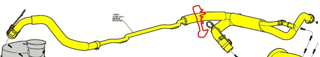

If this diagram is remotely accurate, I am definitely missing some things.

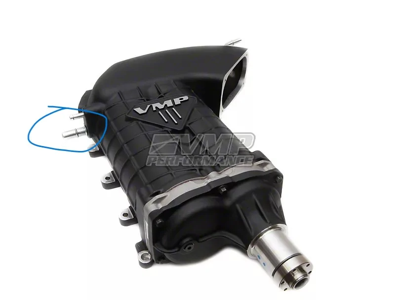

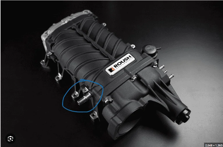

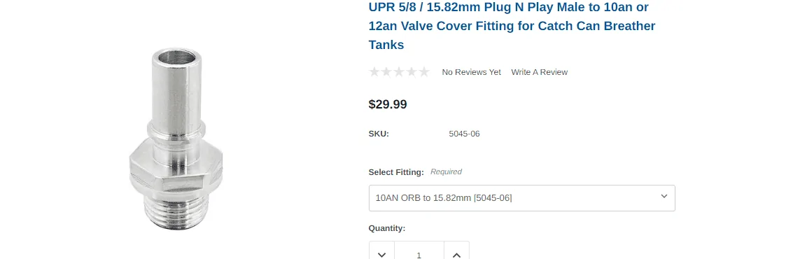

Looks like a fitting used for a catch can, or one of the fittings on a Roush or VMP supercharger. How it ended up inside the intake is the real mystery.

@SheepDog I think you nailed it! That looks exactly like the nipple on the Roush SC. With that being said, it‘s possible that The car was boosted at one point in its life and perhaps the previous ow er removed it to recoup some cash. I still can’t help but lean toward possible sabotage because it’s just too big to have been missed when installing an intake manifold.
The OP is on top of things though and I am confident that he’ll get it sorted out soon.

Looks like FR3Z-2420-J has the connectors I need. What is on the car now is the tube to the left at my pitiful attempt to depict a saw.
I hate having to keep getting these little parts but I hope to keep this Mustang for a long time and, to paraphrase my Dad, not be penny-wise and pound foolish. And I am sure, were he still alive, he would throw in a dumb-ass barb or two. All said with love of course.
