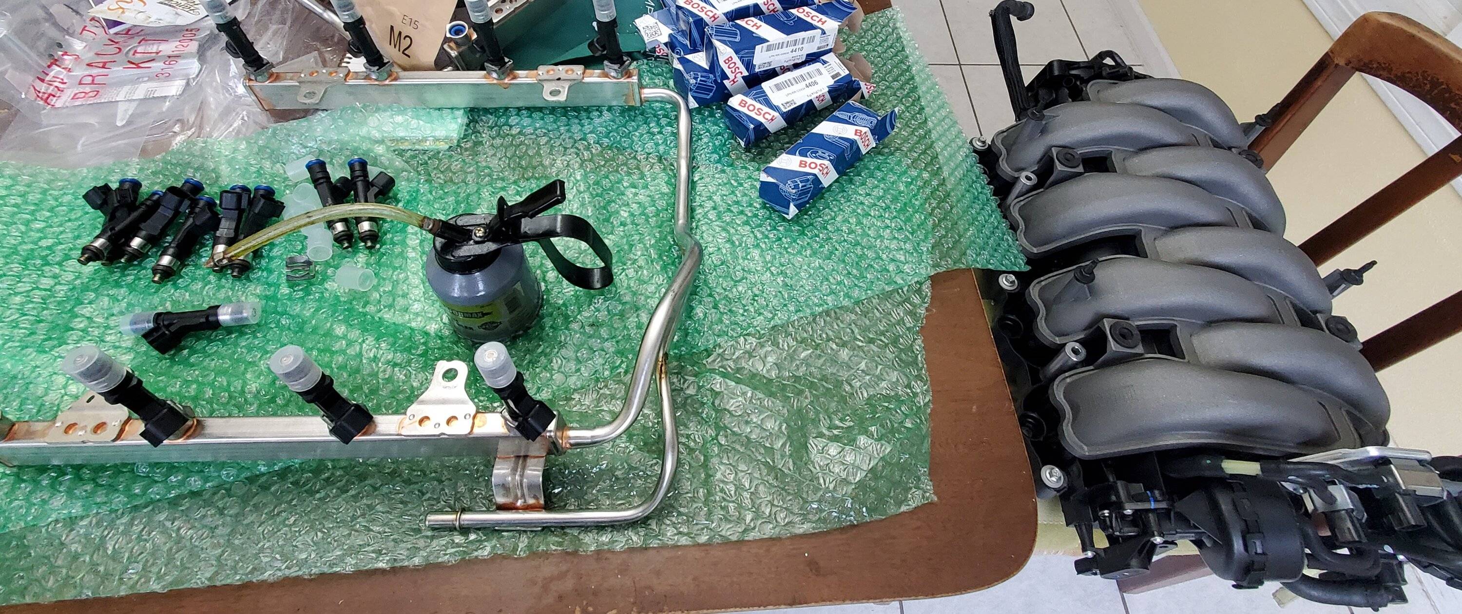

My "new" 2016 intake manifold has been cleaned up, looks like new. Thanks to another forum member for hooking me up! The new fuel injectors have been installed into the fuel rail and the fuel rail attached to the intake. New Fel-Pro intake manifold gaskets are now in place too.
Ran out of time today but tomorrow should see me reinstall the intake itself, hopefully re-connect the various vacuum lines to the right spot and also re-connect the connectors to the back of the intake that were not attached to the 2018 intake. At least none of the wiring was cut up or spliced.
I got a bunch of emails from Lund on steps I have to take to install their tune but I have not read them yet. I will do that before moving on to the tune. I hope the Lund tune works okay. They've been getting pounded on here pretty hard lately and it has me worried this is just another fiasco waiting to happen to this Mustang. I doubt a tune can get much more basic that what is needed here so I hope that means it will be smooth sailing.
My plates, registration and title arrived in the mail yesterday so maybe that's a good omen. Or maybe it will just make it easier to identity the car after it blows itself to bits when I next try to start it. Could really go either way at this point.
A dining room table is the perfect spot to do this type of work, as long as my wife is at work that is.

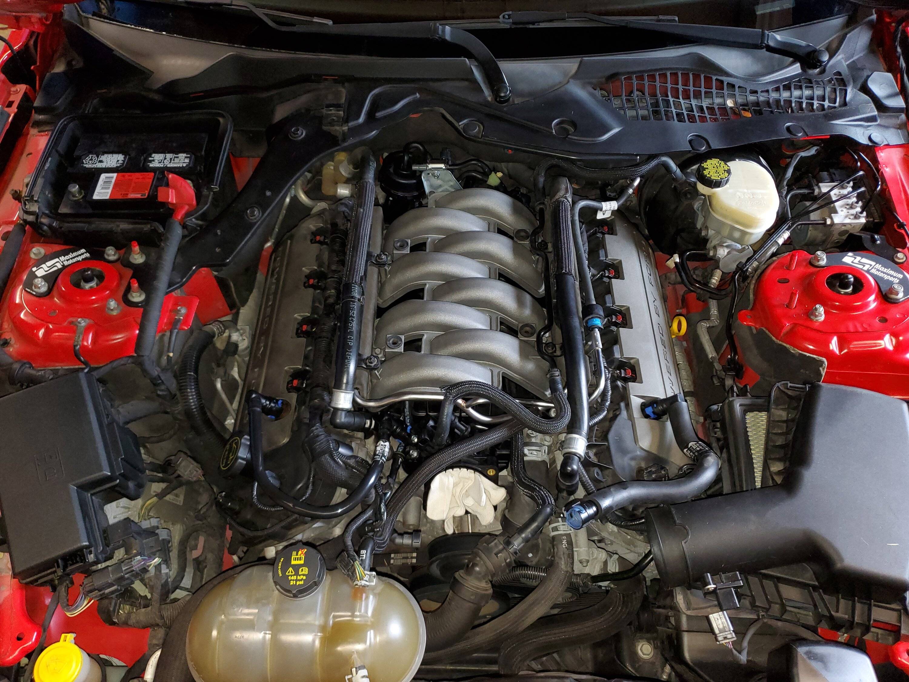

I was able to install the replacement intake this morning with no issues. Fuel rail, injectors etc are done. I did hit a road block when I went to install the throttle body. I forgot to get a new throttle body gasket for the 2015-17 intake. !@#$. The TB gasket on the 2018 intake is a bit too big to fit the 2015-17 intake. I did check the part numbers and the TB that was installed on the 2018 intake is FR3E-9F991-AA and that I am re-using now, is for a 2015-17 intake. The bolt pattern for the TB is the same on both intakes.
With any luck I can find this gasket locally here today.

I took a little break to regroup and reassess and I am feeling better about things now. Beautiful wife, healthy, happy kids, nice home, great job, okay health, etc... My youngest reminded me about the Tubthumper spirit I have and to channel it now. Kids are pretty insightful at times.
The TB gasket is not available anywhere locally today so I will be getting it on Tuesday. I think I have now gone as far as I can go without having the TB installed.
Now it is a Sunday afternoon and my plans are zero (i.e. finish the Mustang). Nothing pressing to do outside or inside, no important projects or deliverables due at work tomorrow, house to myself (except for 4 cats temporarily staying with us)... And the Moto GP race is on the DVR, a few football games on the tube, and some cardio work to get done. I think this Sunday afternoon might turn out well after all.

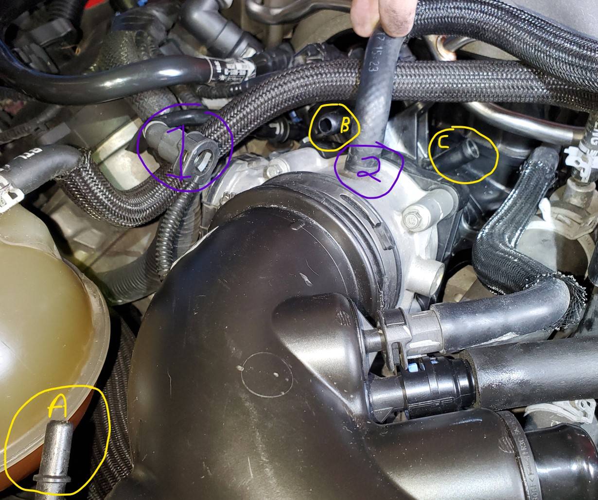

I was able to pickup the TB gasket at a local Ford dealer today and got the TB and factory air tube reinstalled. There are a few connections I am unsure of. I am also reasonable sure at least one of the hoses (#2) has been shortened or otherwise mucked with.
Nipple A is on the stock air tube.
Nipple B is the vacuum canister purge valve.
Nipple C is on the intake manifold.
Hose #1 originates at the back of the 2015-17 intake and runs under the runners, exiting at the front left corner of the intake. It'd really suck if this one is not supposed to go under the runners, rather over them but I'll deal with it.
Hose #2 goes to the brake booster. Its I.D. is too small to fit over nipple C and is too short to reach nipple A. But I seem to remember seeing a picture somewhere showing the line 2 being connected to nipple A on the air tube but I could be wrong. If so, I will need to pickup an appropriately sized hose to do this.
I've been searching for pictures that show these connections but ones not depicting an aftermarket CAI are few and far between, at least based on my search results so far. Does anyone have a link to a picture that might help me resolve these last few connections?
With a little bit of luck, I will be trying to start this... bundle of joy... either tonight or tomorrow.
