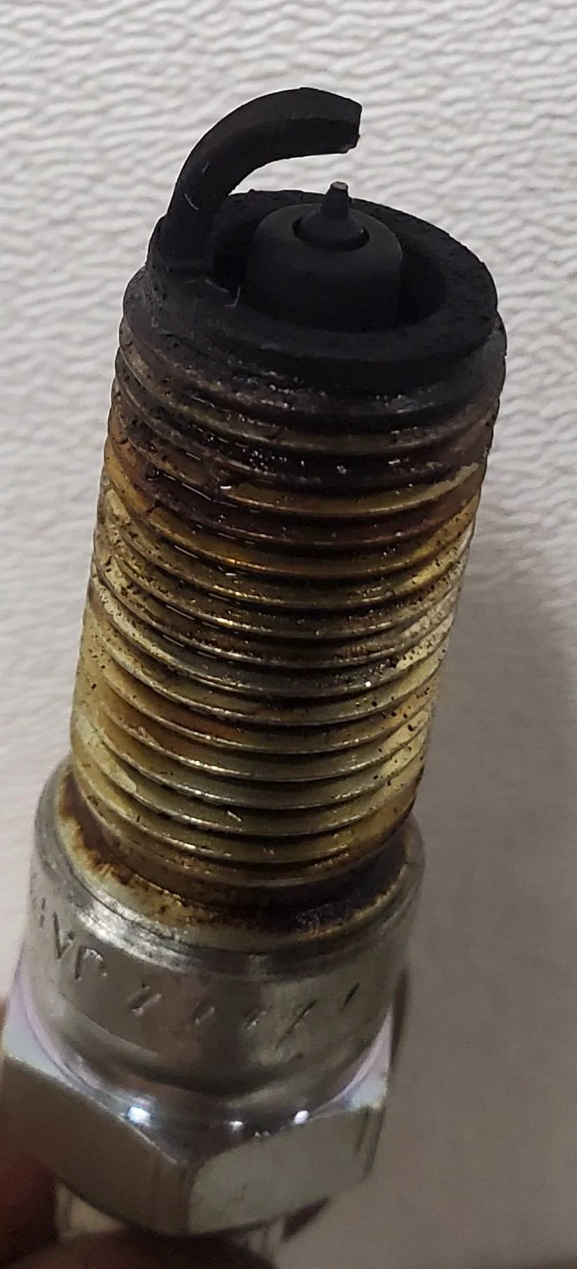

The plugs were covered in wet soot and smelled of gas. I'd say it is running a bit rich.

Did you reset the gaps when you pulled and cleaned the plugs? Were you able to get them really clean?

Yes and yes. They were nice and shiny clean and adjusted. I will probably have to do it again before I make another attempt to start it.

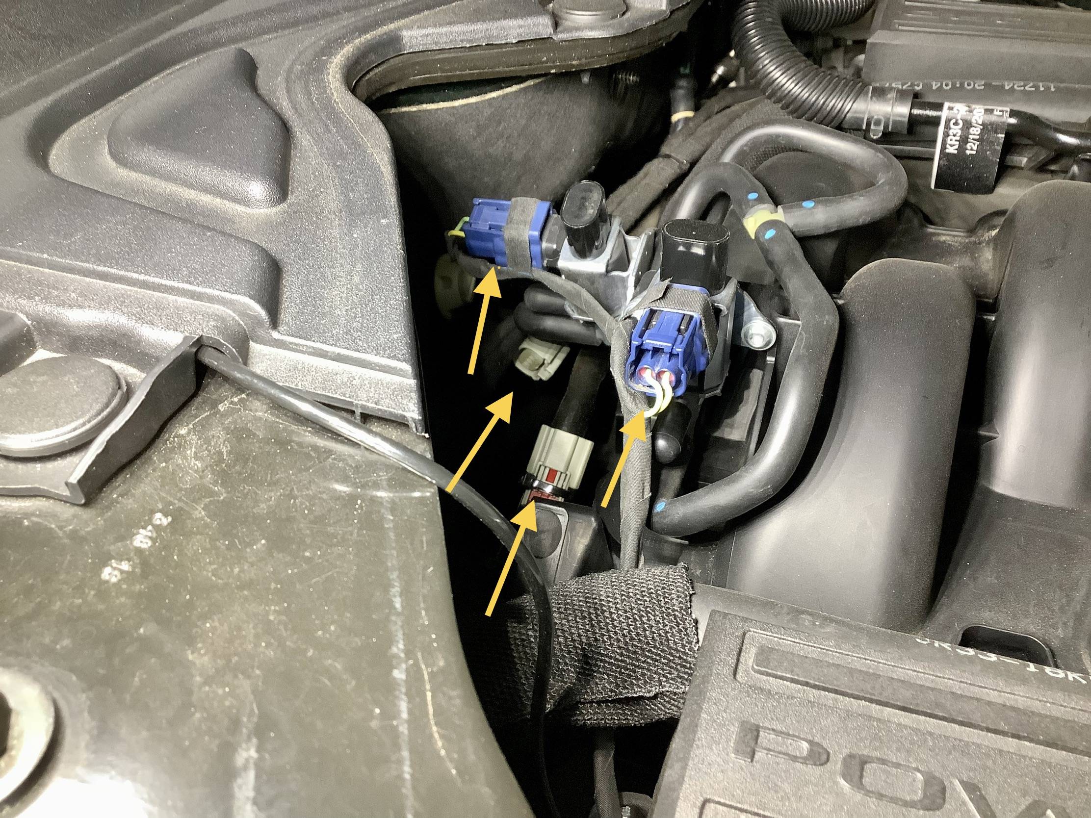

When you pull the IM to inspect the injectors, I suggest taking the time to zip tie the IMRC connectors to the main wiring harness to prevent rattling around and possibly creating a false knock that will be detected by the knock sensors underneath the IM. Here are pics of how I did mine.
I reinstalled the two actuators onto the IM, capped off the vacuum ports on each and plugged in the two connectors, so that I only had to worry about zip tying the remaining two.

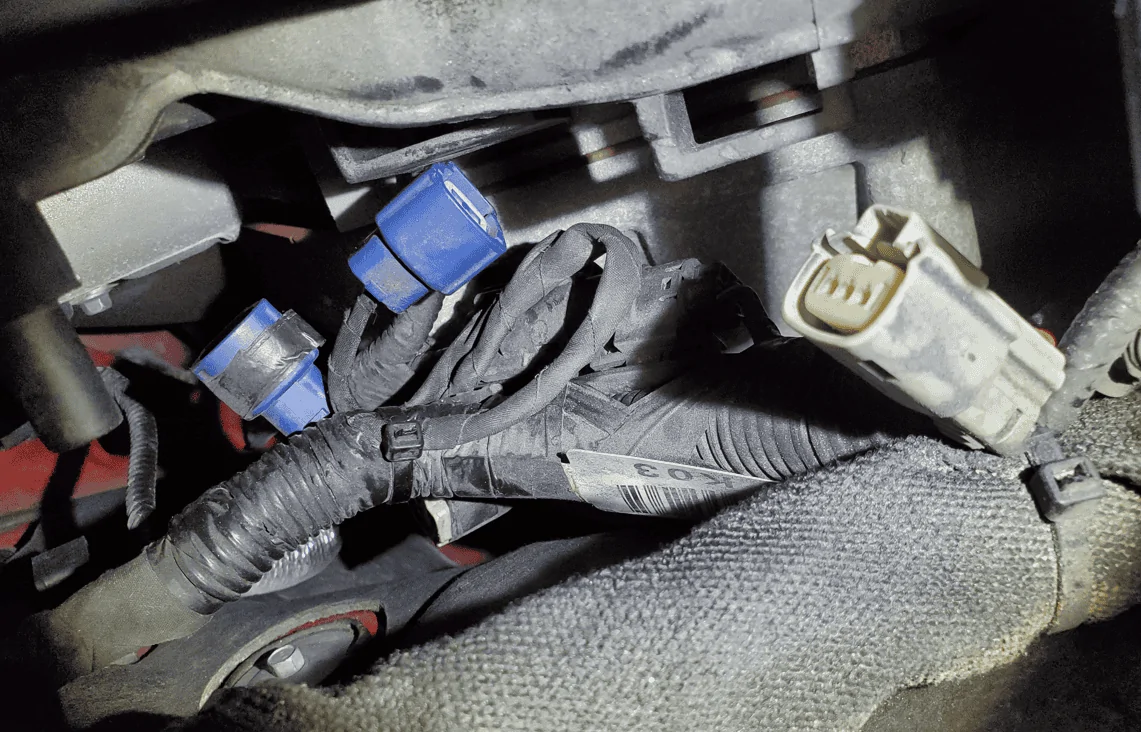

None of the four connectors at the back of the 2018 manifold currently installed are connected to anything and are zip-tied out of the way. I was told that is because the tune currently on the car, whatever it is, has locked the IMRCs so the plugs do not need to be connected. I hope the PCM is not completed locked by whatever tune is on it now so that I can't install a new tune. That'd be no fun.

I pulled the plugs again and gave them another good cleaning. They had no carbon on them, just wet from fuel. I then added a full 32 oz can of VP Octanium to the roughly 14 gallons of 87 octane in the tank. Then I cranked it without touching the throttle, with the throttle wide open and in between. Absolutely zero difference to the behavior before adding the octane booster. Maybe it's still all sitting in the gas tank and the fuel rails have not been visited by it yet.
