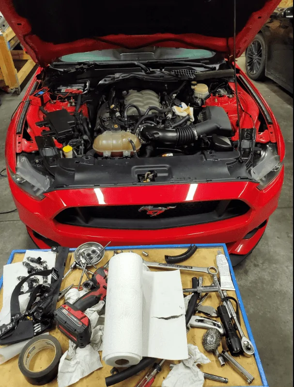

Since you’re going as far as you’ve gone, I’d consider cleaning the 47’s if you’re going to reinstall them and tune around them (even if it’s a 93 tune). Also pull the pump and change the filter and maybe even the pump (based on what the flow test reveals) to give yourself peace of mind that you’re all good on those fronts.

I think I am the point now where I have my ducks in a row and am ready to buy the 91/93 tuner/tune to see if we can get this beauty going.
Stock 2015-17 intake manifold
Stock throttle body
Stock (i.e. no) CAI
Eight new Bosch 62408 fuel injectors
Very clean NGK iridium spark plugs, .051 gap.
BBK long tube headers
BBK hi-flow cats
Annoyingly loud MBRP cat-back
Hmm, if an engine is running as rich as this one, can O2 sensors get fouled up with carbon like the plugs? I found out the hard/expensive way what a rich-running engine can do to cats when a problem on my 95 GT trashed the cats in a very expensive aftermarket exhaust.

If running poorly, it can foul the O2's.

Leave everything as is and get a tune for 91/93 octane. You don't need to replace the intake manifold or the injectors. It will run fine once you get the E85 tune out of there.
Don't make it more complicated than it needs to be.

Oh boy, SCT X4 vs HP Tuners RTD+?
Looks like the recommended/required one depends on where you buy the tune. Lund is HPT, Palm Beach dyno looks to support either, Wengerd Performance supports several different ones. I am sure they are all superb for my basic needs, which is to have the car start properly, run well and be reliable.

I have a set of stock injectors and fuel rails from my 2018 that I am willing to give you if you want them. Just cover the shipping.
Oh I think I am going to take you up on this overly-generous offer. I just found out that I am not supposed to use these brand new, just purchased Bosch injectors even though they are supposed to be equivalent to the Motorcraft ones. Sometimes parts like this come out of the same line just in different boxes, sometimes not. I was just trying to get ahead of the game a bit. Can you DM my with the shipping cost to Wisconsin zip 54944 and a charity you'd like me to make a donation to on your behalf.

Pretty sure his stock 18 injectors are different than Gen 2 injectors.
Ah, I did not know that. Still, I appreciate the offer to help me get out of my current hole.

Just have Lund tune for the parts you have.
