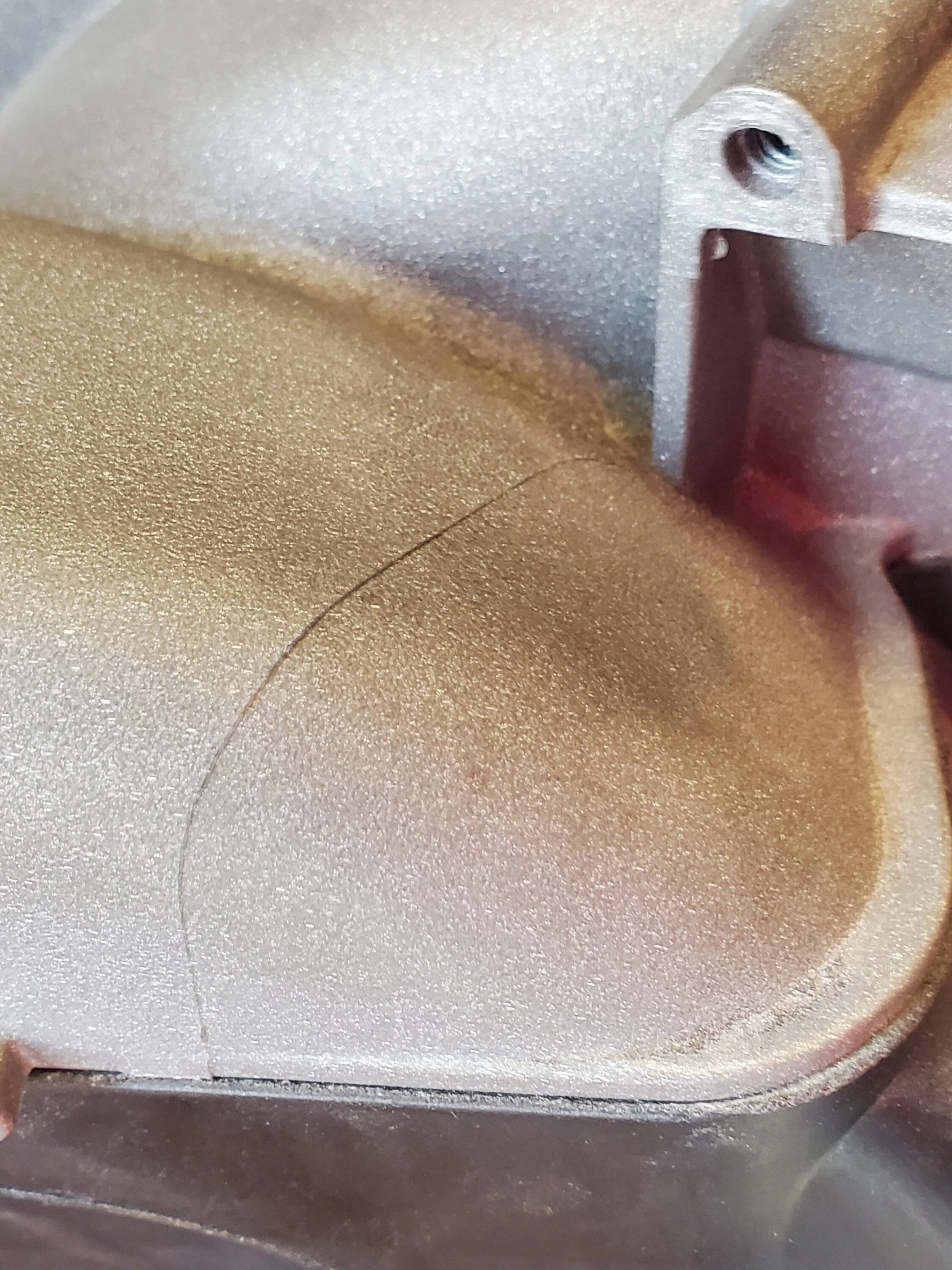

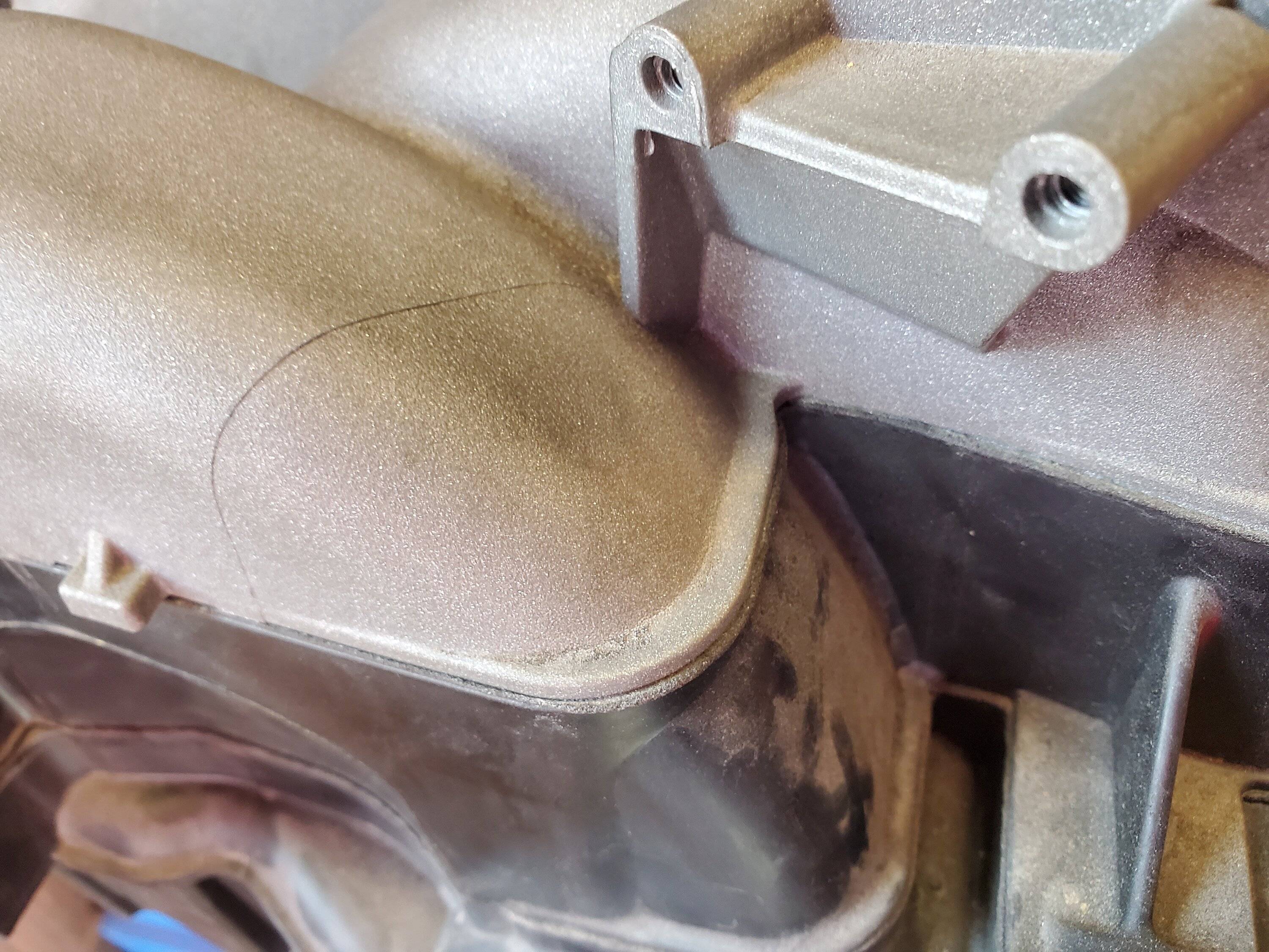

Okay, now this one this morning made me laugh a bit. I figured I could at least recoup a bit of lost money by selling the 2018 intake and 47 pound injectors that came on the car since I've reinstalled the original intake and injectors. I was taking advantage of the nice, late October Wisconsin weather and was starting to clean up the manifold. As I was blowing the dust off of it and looking at it closer, I thought I saw something on the one end runner that was probably not supposed to be there. Does anyone want to buy this intake now?? :)
