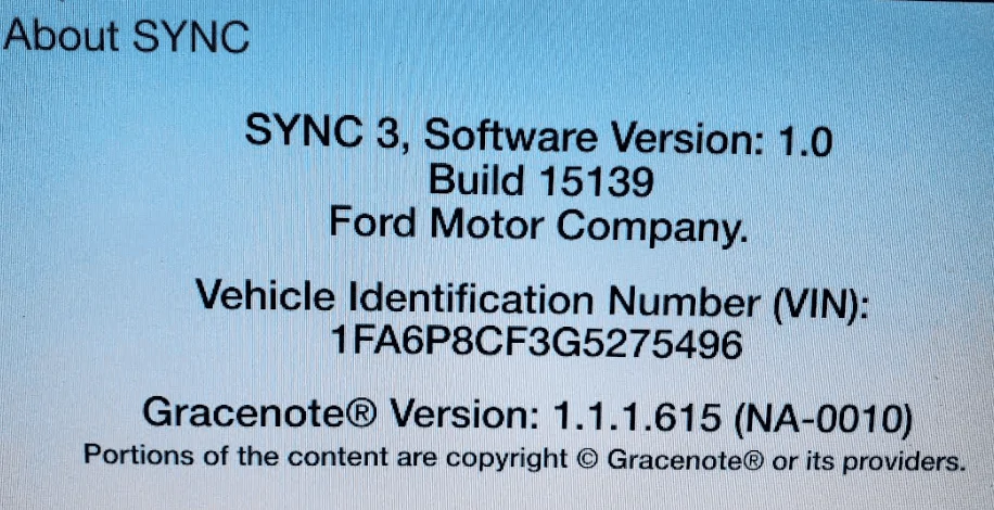

It looks like the SYNC on this Mustang hasn't been updated in ages so I figured I'd do something "easy". It usually takes about 30 minutes to update SYNC on my F150 and my daughter's Fusion. So far, the Mustang has been at it for an hour and 10 minutes. I don't know if it's really that slow or if it is stuck. I hate just letting it sit there idling for that long, but at least it is idling.
After about 40 minutes of idling, the new vapor canister check valve started loudly clicking like a meth-fueled woodpecker so I temporarily unplugged the electrical connector to it. Hope that didn't somehow freak out the SYNC install.
A new car cover arrived yesterday so it's quite nearly time to put this away for the winter. Mint Auto Sales has still not made the call they were going to make 3 days ago. I am not waiting by the phone.
Well, the update ran for 1 hour and 25 minutes, then this. I was only updating SYNC, this car does not have navigation. I created the file via the SYNC page on the Ford owner site. Oh well, I'll retry later. Maybe try CyanLabs this time, although in theory it should be the same file. I'll also get a different thumb drive ready too, just in case.
This car is going to make me work for every millimeter of progress I make towards making it what it already should be.
