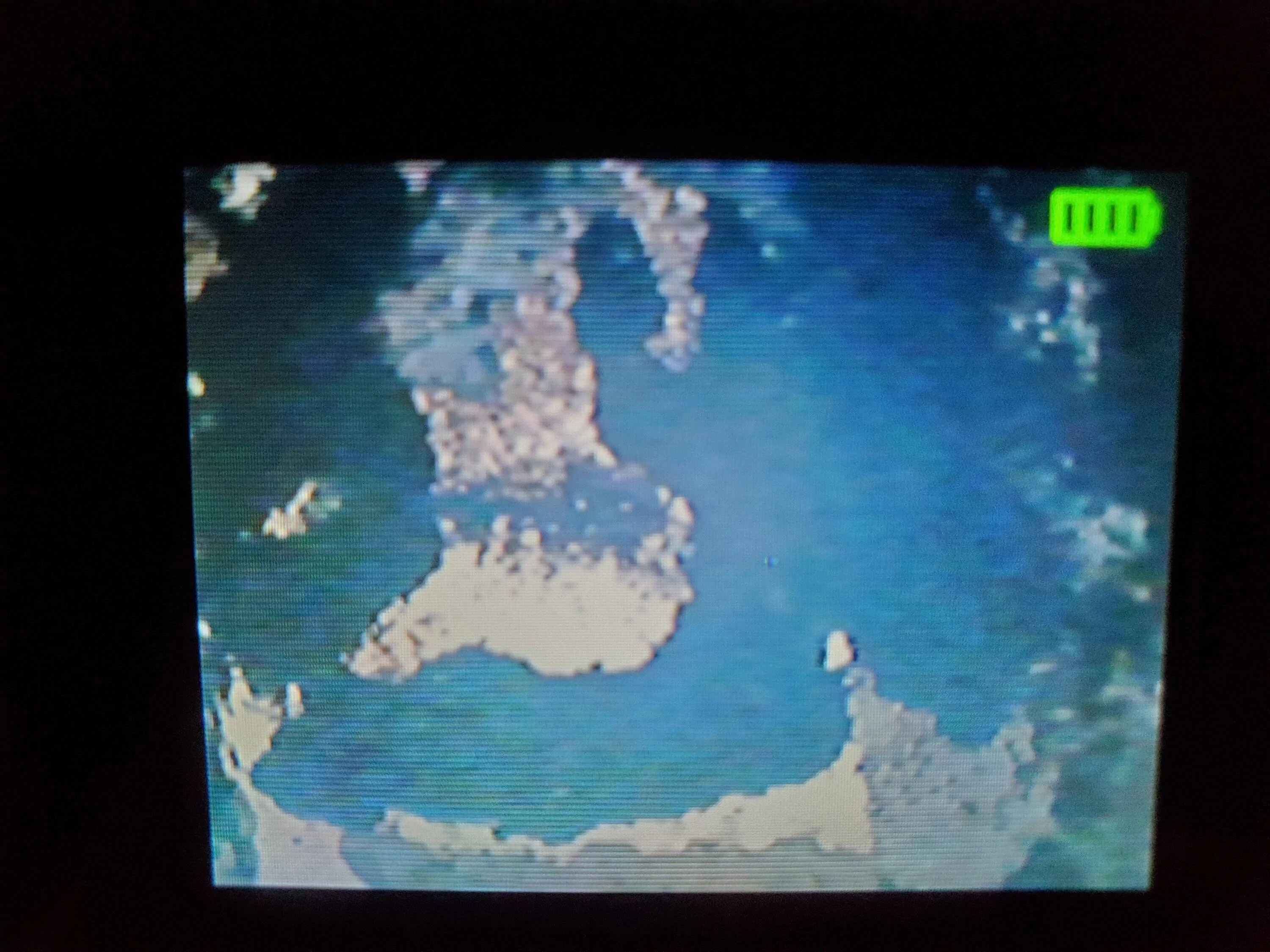

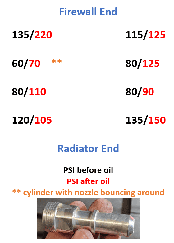

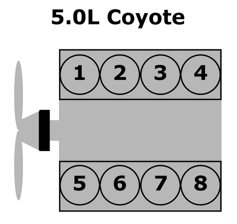

Still have not heard back from them. I will be pinging them shortly. In the meantime I picked up a bore scope from Autozone and did some scoping. I'll post pics shortly.
I squirted a bit of oil down each cylinder and re-did the compression test. The lowest value is still the cylinder where the foreign object was bouncing around on top of the valves. Based on the cylinder number diagram I found, cylinder 1 right is front left, cylinder 5 is front right. In this case, the values for cylinders 1 and 4 don't make much sense to me in that cylinder 1 is lower with oil and cylinder 4 jumped from 135 psi to 220 psi. Except for the drastic jump is cylinder 4, none of them are anywhere near what they should be. :(

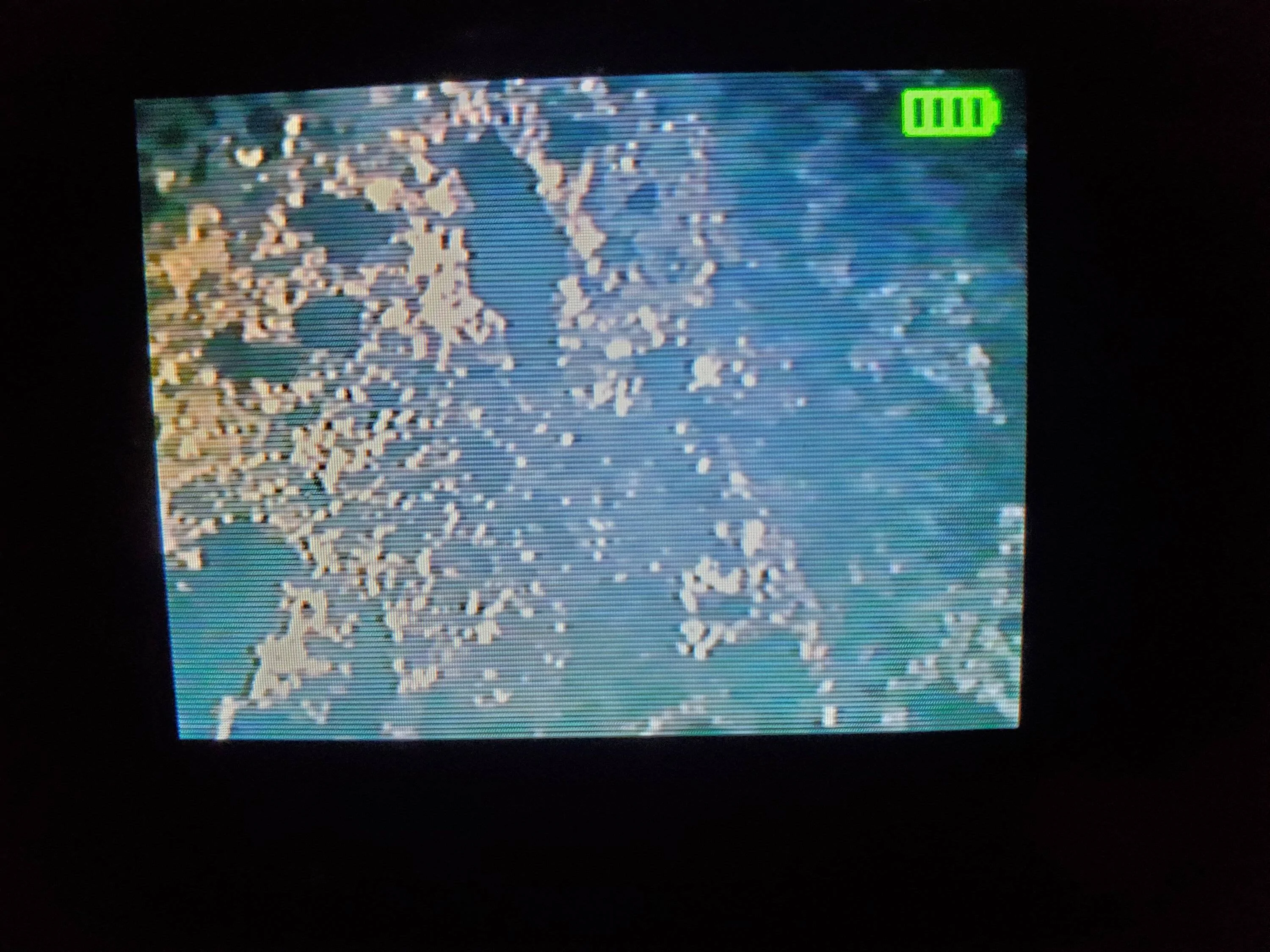

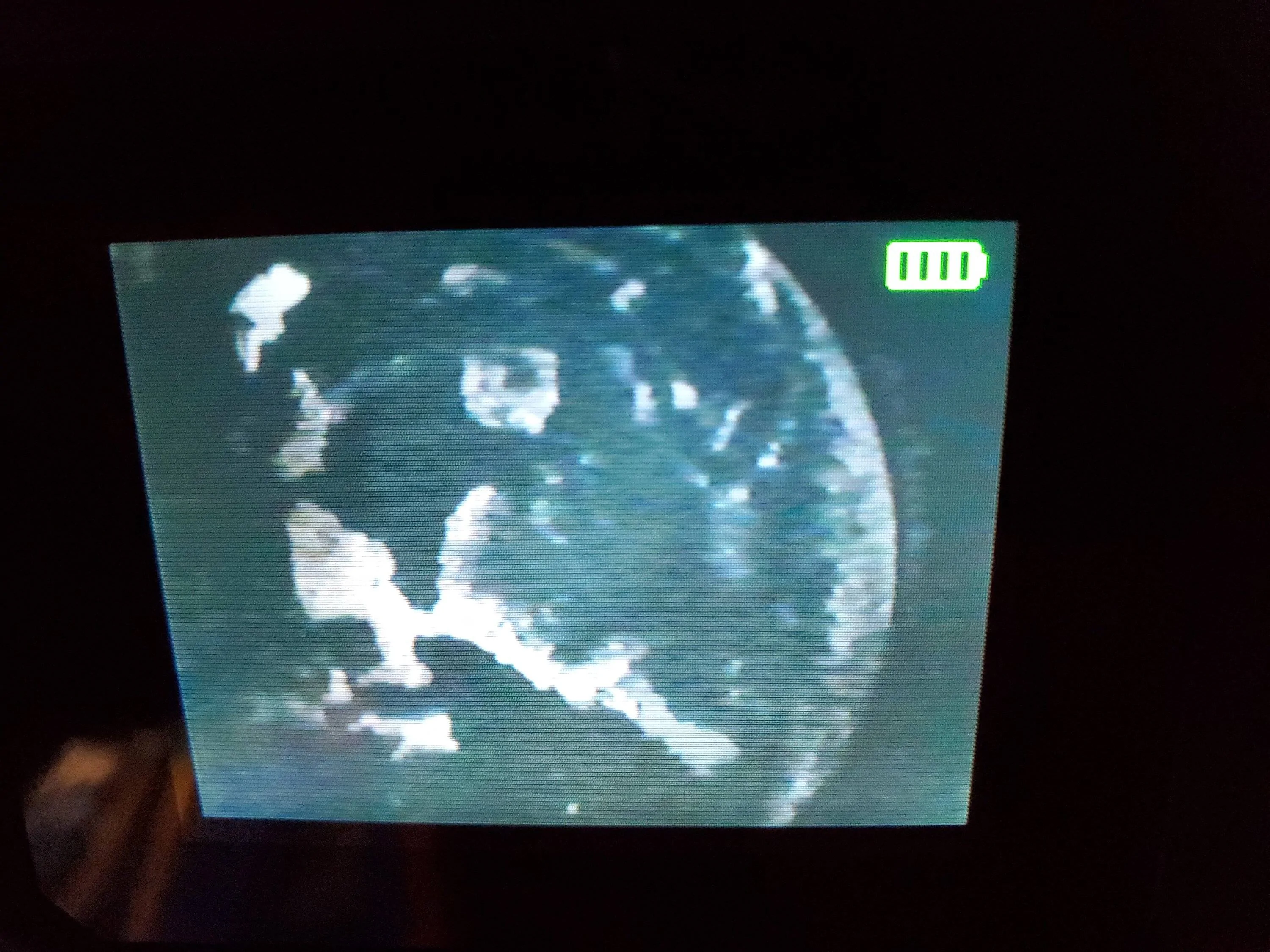

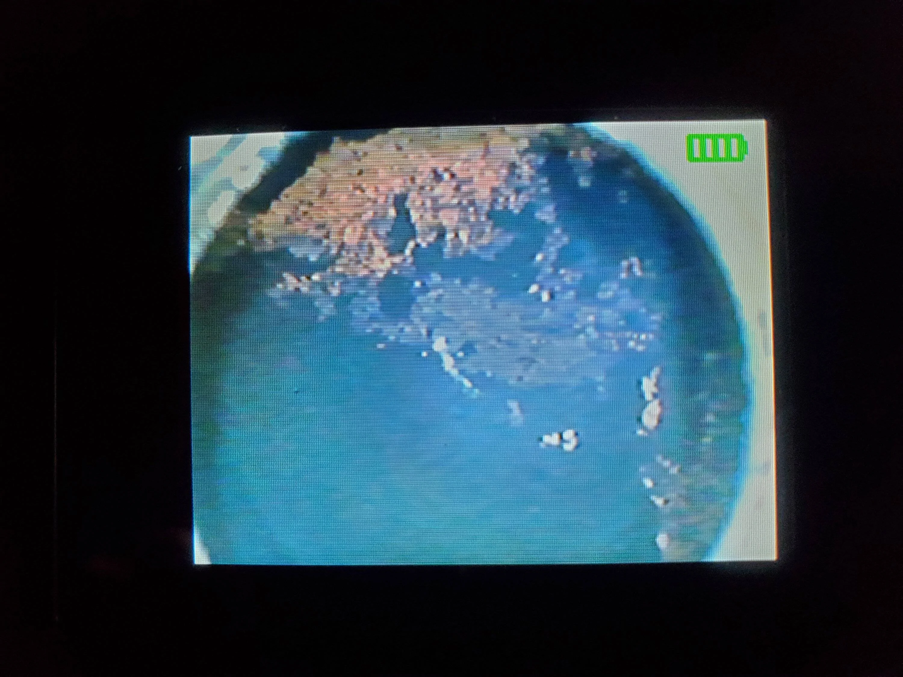

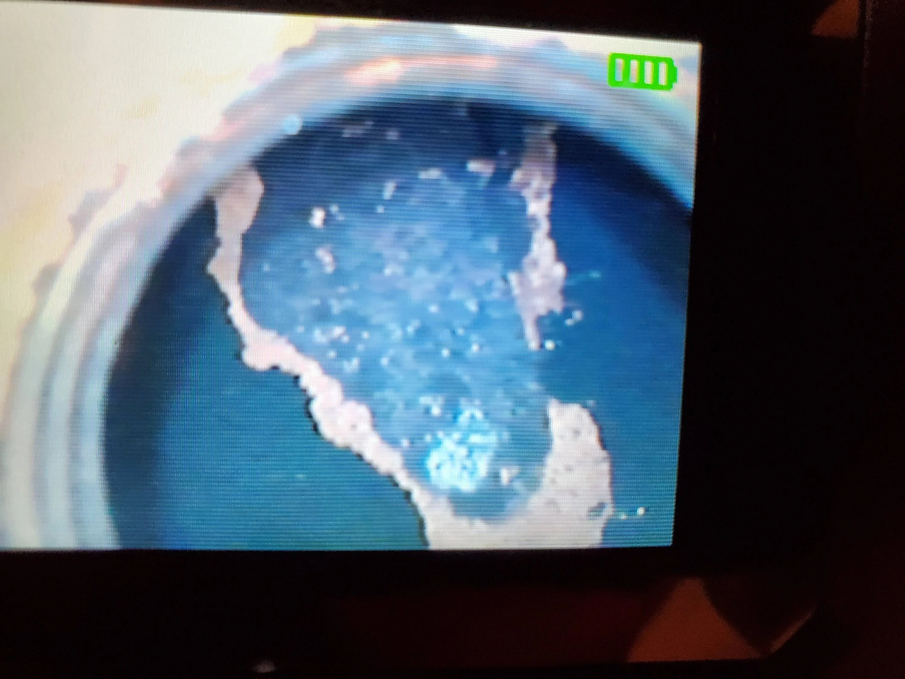

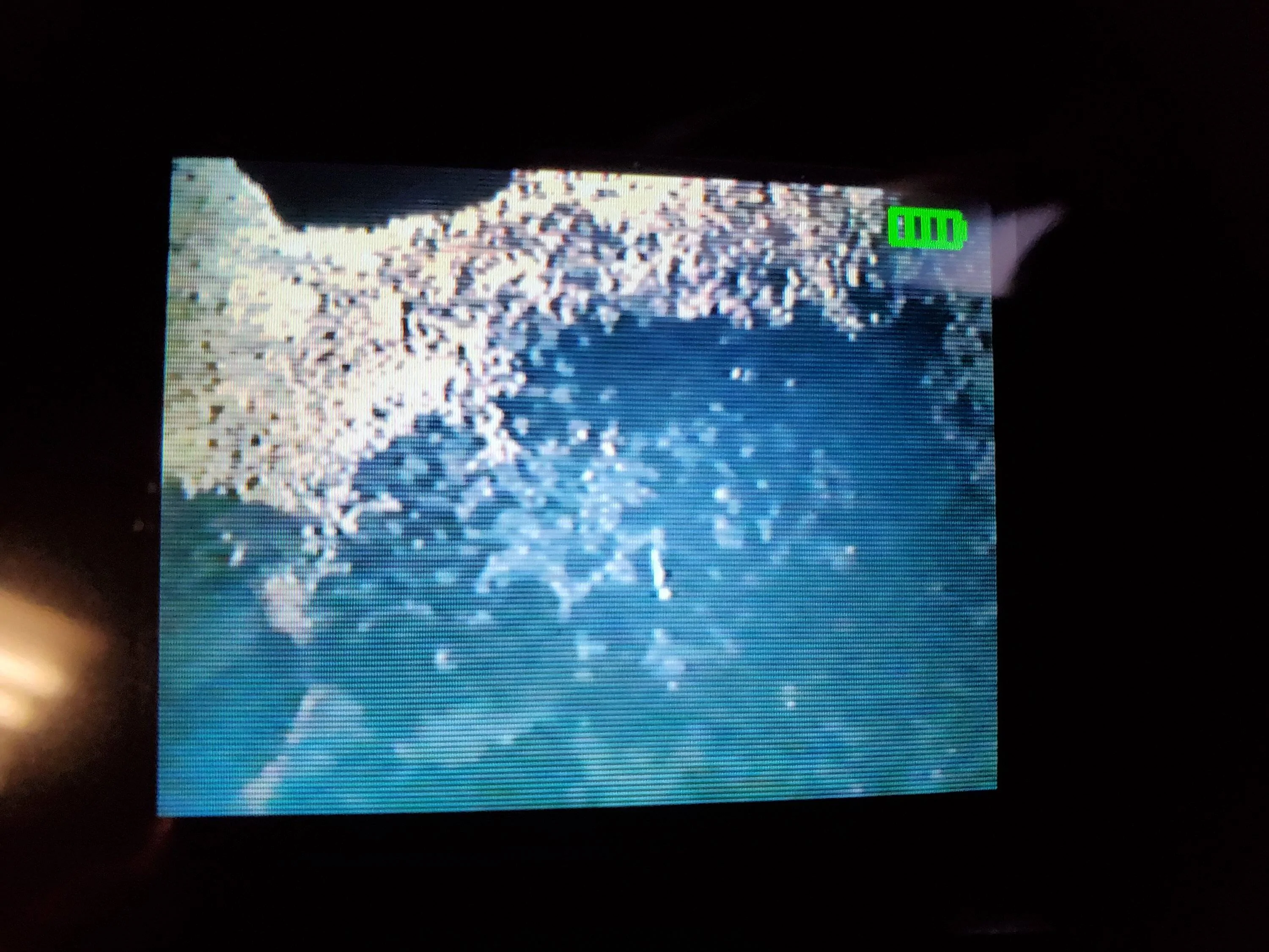

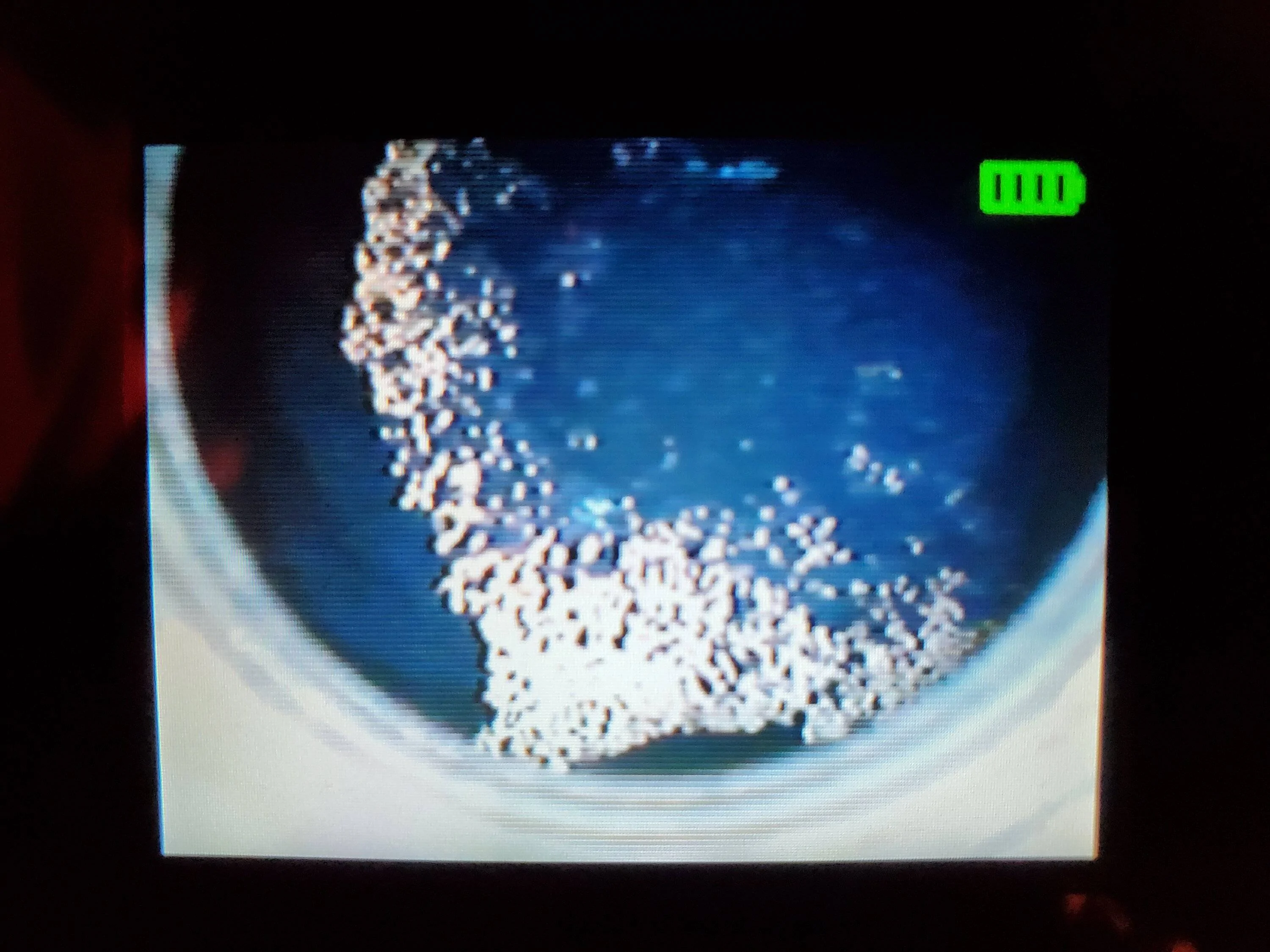

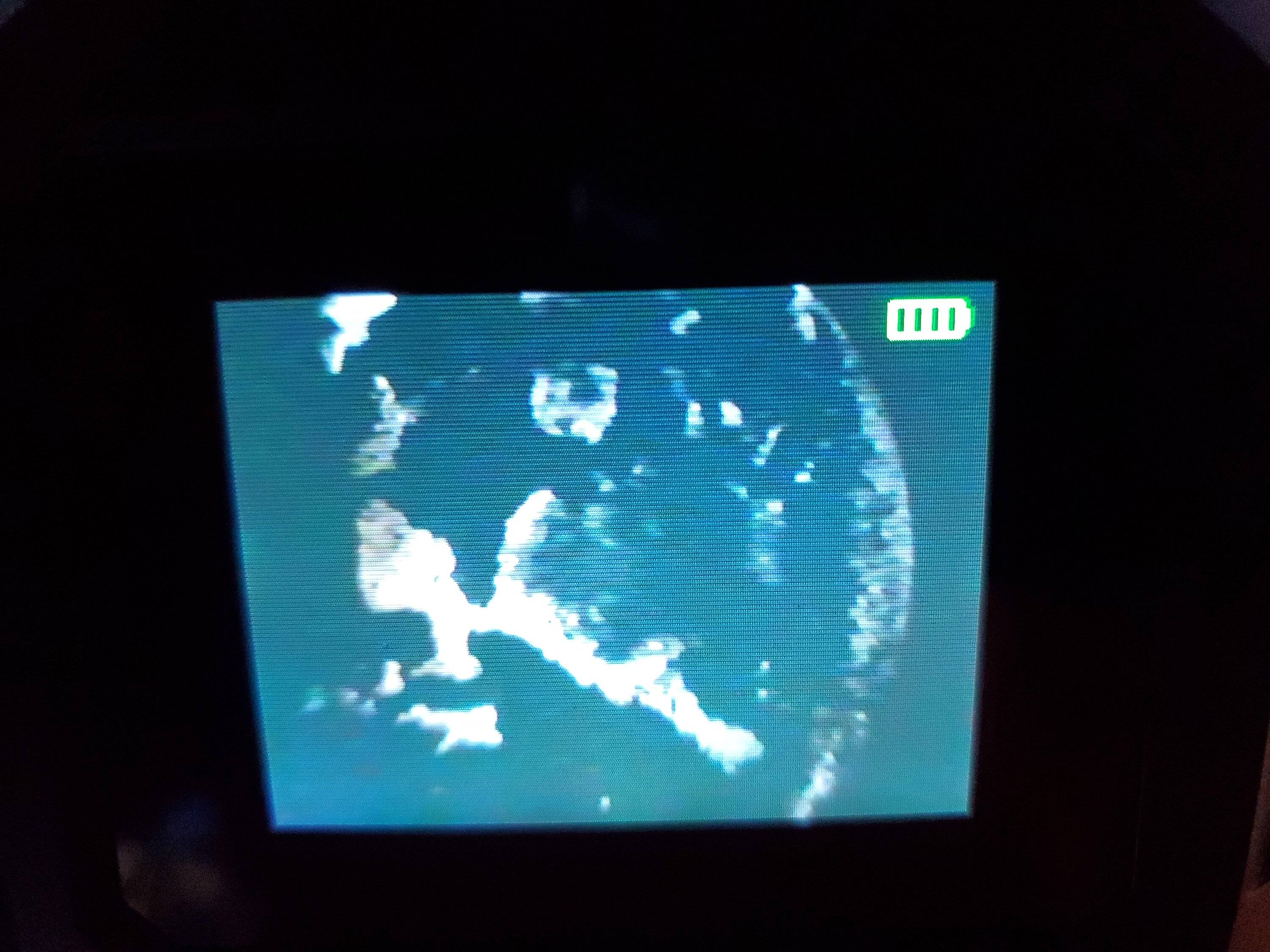

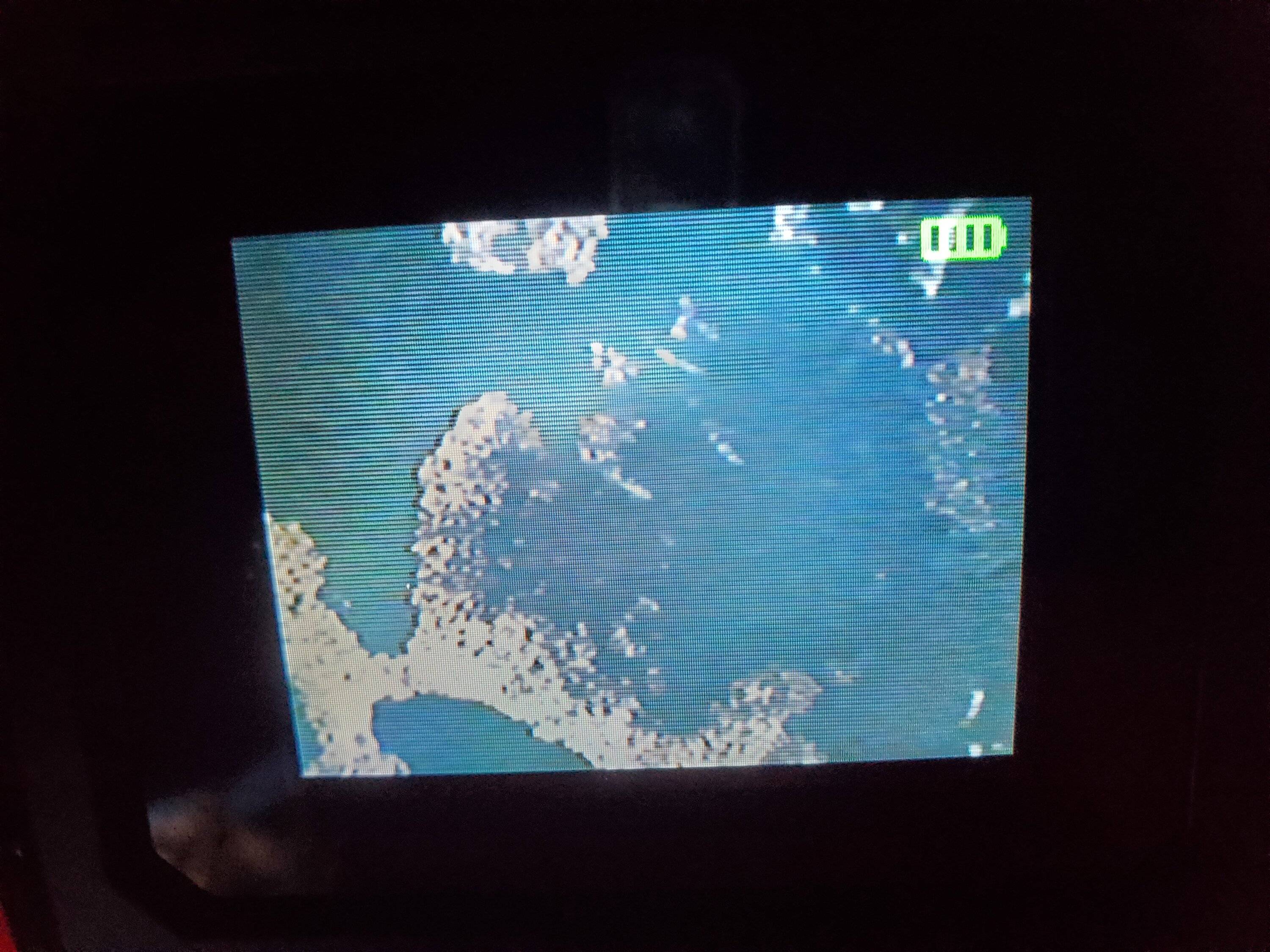

I stuffed a bore scope down the coyote's holes today and took some lame pictures of the scope's display. I could not get an angle to see the cylinder walls worth a darn and the pictures on the display itself were not exactly clear. I did get the sense that the top of the pistons resembled the splatter I leave behind after using my mig welder. A few of the cylinders looked like they had some type of buildup on them and that pieces were missing. Then I thought everything looked like the ultrasounds of my kids and me nodding in agreement with what the doctor was saying she was seeing. Or pictures of Earth from the ISS.

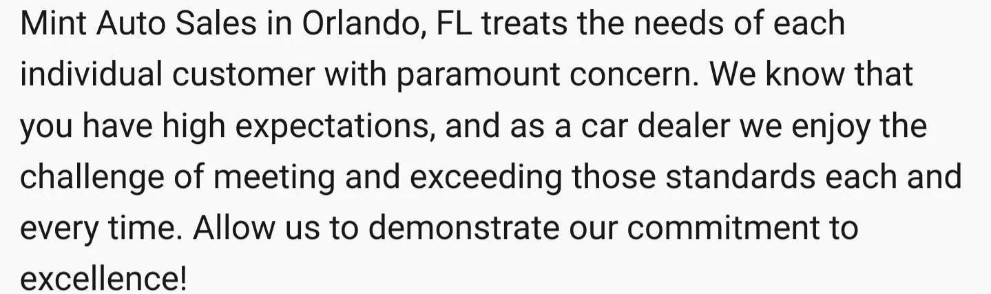

I pinged them at 1:30 PM today (Saturday) asking for the promised follow-up and was told at 2 PM "You will hear from me today." I think they closed 3.5 hours ago so it's probably not going to happen.
No way would the teams I work on/with pull this shit. We don't need the executives to hold us accountable for commitments we have made, we hold ourselves and teammates accountable! Pride in and ownership of our engineering work.
Looks like they blocked me from their Facebook page after I replied to their request for used cars. I told them I had a mint one they might be interested in and listed some of its special features. I also added my 2 cents to the glowing reviews others posted, mentioning they even included extra parts in the cylinder heads and an unmentioned conversion to a different fuel type for no extra charge.
I figure as long as I only post what I know to be true and can prove it, I am safe talking publicly about this "mint" car.
I am including the commitment to excellence they espouse on their own web site. Are they just words or do they actually mean something?
Nothing super stands out, but it definitely was run hot. I assume the ringlands have been deleted from the genius who ran 87 octane with their blower.
The lowest cylinder may have valve damage, which complicates things. Normally I'd suggest a new shortblock, but a used engine is likely the move here. Unfortunately I see "mint auto sales" as a dead end. They will hide behind the "as is" paperwork and insist that you broke it. It will be cheaper to just get the used engine than getting legal counsel. I hate it though, dealers like that should be forced out of business for this kind of scummy behavior.
Yup, I have been working on multiple plans depending on what happens. Honestly I would be reluctant/scared to buy a used engine after this fiasco. I don't want another lemon and am not confident in avoiding one.
New long blocks, if you can find them, seem to be $7,500 and up. I see reman ones with a 3 or 5 year unlimited mileage warranty for $5,500 at places like https://fraserengineco.com/5-0-liter-ford-coyote-engines/. Never heard of them before but that doesn't mean much. Lots of great places I have never heard of. Or is my long blick worth trying to have rebuilt or is this a risky move?
I think all the accessories and stuff like intake, starter, injectors etc on the engine now are fine to re-use on a new long block.
