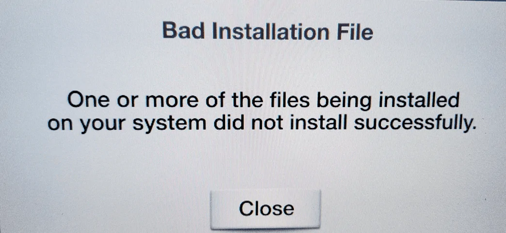

Well, the update ran for 1 hour and 25 minutes, then this. I was only updating SYNC, this car does not have navigation. I created the file via the SYNC page on the Ford owner site. Oh well, I'll retry later. Maybe try CyanLabs this time, although in theory it should be the same file. I'll also get a different thumb drive ready too, just in case.
This car is going to make me work for every millimeter of progress I make towards making it what it already should be.
This morning I tried updating SYNC based on the Cyanlabs updater and it did the update in about 25 minutes. I do need to replace the USB hub in the center console but that can wait until spring. So another small victory was mine!

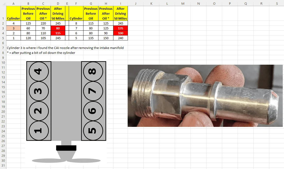

I decided to do another compression test after it cooled down to see if it was changing / getting ready to grenade. So, out came all 8 plugs and all 8 cylinders were tested twice. Anyway, I don't know what to make of what I found. Cylinders 1, 4, 5 and 8 are showing about 240-245 PSI and the middle cylinders are a lot lower, especially the one that had the nozzle bouncing around on it for an unknown amount of time. Maybe if I drive it another 50 miles, all 8 cylinders will be normal. Just kidding. I do think I see a little bit of smoke coming out of the tailpipes. Given the H-pipe exhaust I can't be certain, but cylinder 3 would be my guess as to the source.
My nephew is a Ford mechanic and hot-rod guy but lives in Canada. His family is supposed to be visiting us sometime in the new year so I think I will just leave it alone until he can have a look at it. I was concerned about bothering him with it, but like a true car-guy, he is intrigued and says it sounds like a fun project. God bless him!

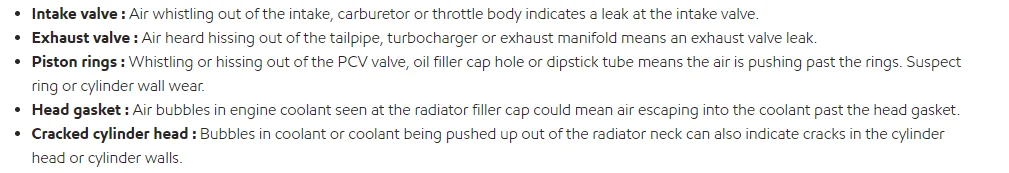

Have you done a leak down test to get a better idea if it's the bottom or top end? You may just have leaky or sticking valves
I have definitely thought about it but to be honest, I am not quite sure exactly how to do it. I think it involves putting the piston at TDC with all valves on that cylinder closed, and using an air compressor (which I do have) to pressurize the cylinder to a specific PSI on one gauge and use the second gauge to measure the leakdown. Then use a ratchet to move the next cylinder to TDC and repeat the pressurization and measurement steps.
I don't know how you know when the piston is at TDC and all the valves are closed. Probably a few thousand YouTube videos on how to do that.
I don't currently have a leakdown tester but I am not against getting one to help me learn how to properly diagnose this type of problem.
