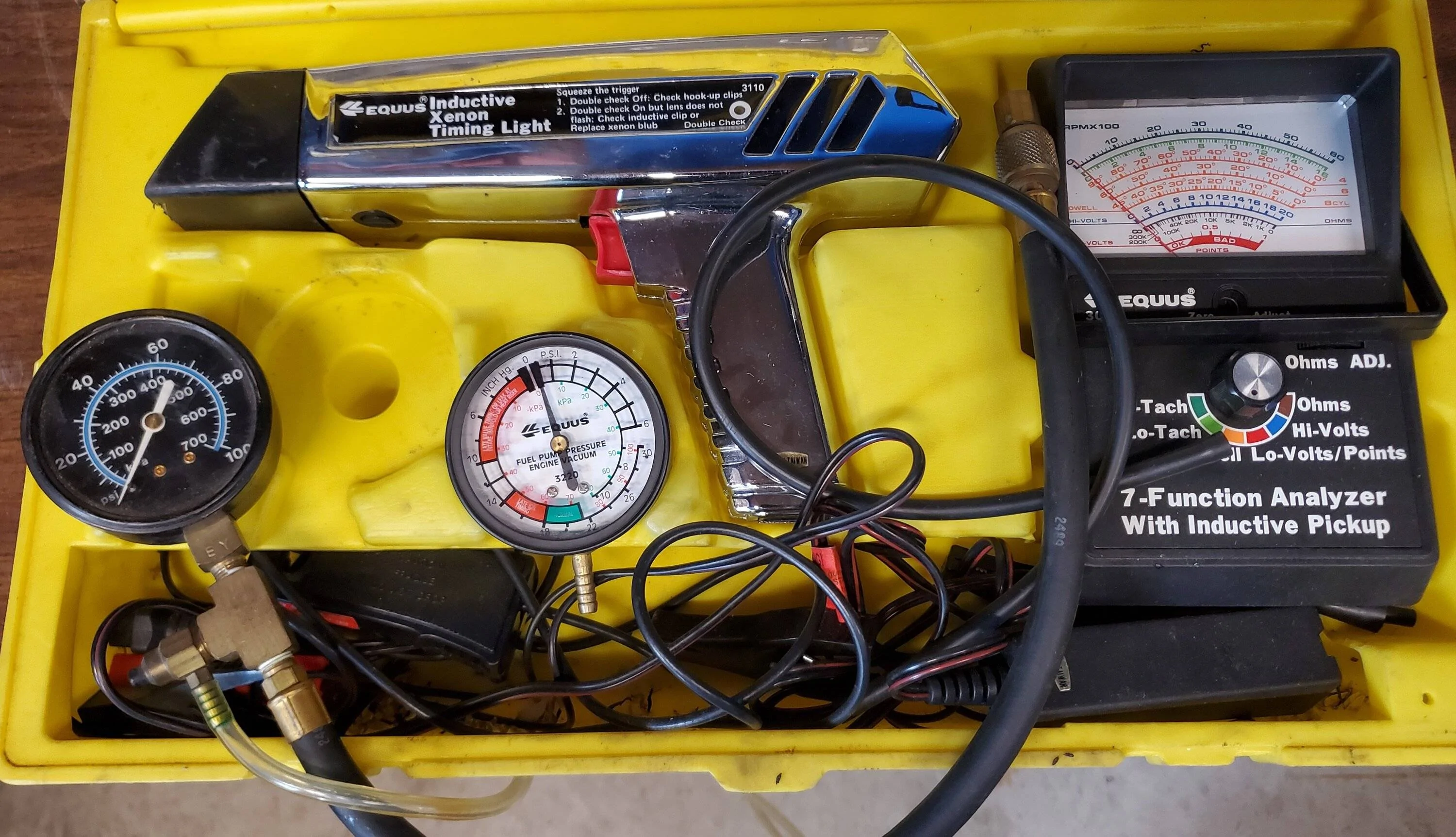

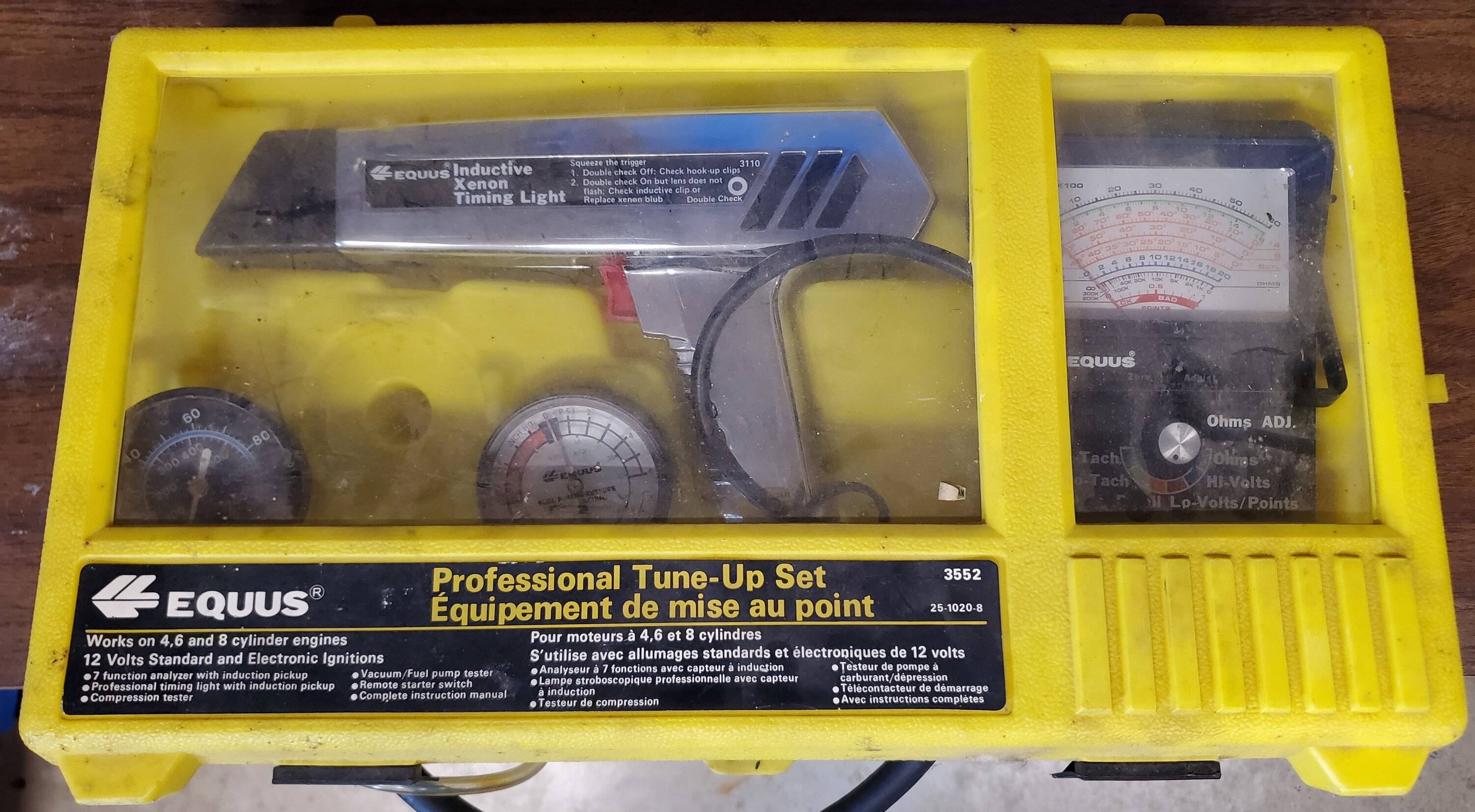

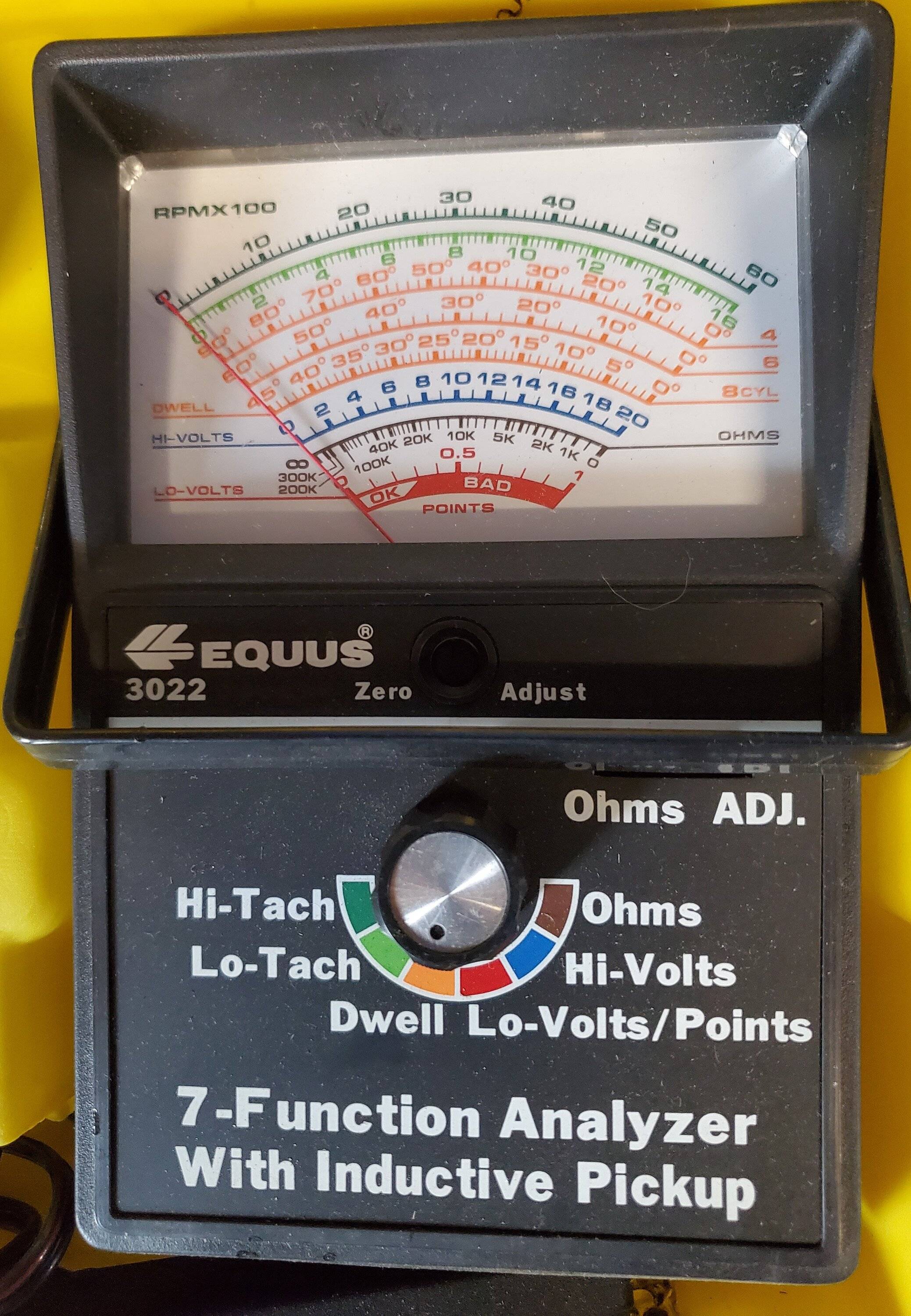

I knew I had a compression tester kicking around somewhere and I was able to find it. I have had it since high school for working on the mega-powerful 1973 Mustang I had then, with the wild 140 horsepower 302 in it. If I need to set the timing or check the fuel pump vacuum or dwell on my 2016, I'm all set. The hose for the compression tester is a bit dry-rotted so that won't help much.
I think it's time to invest in a new compression/leakdown tester. They seem to vary in price from $20 to well over $1,000! Two of our vehicles have over 135K miles on them, so they're getting to that age...

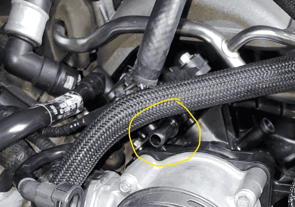

I am still semi-patiently waiting for part FR3Z-2420-J to arrive so I can (hopefully) finish connecting all the hacked tubes currently connected to nothing. It was supposed to arrive at my local Ford dealership Wednesday or yesterday but no joy so far.

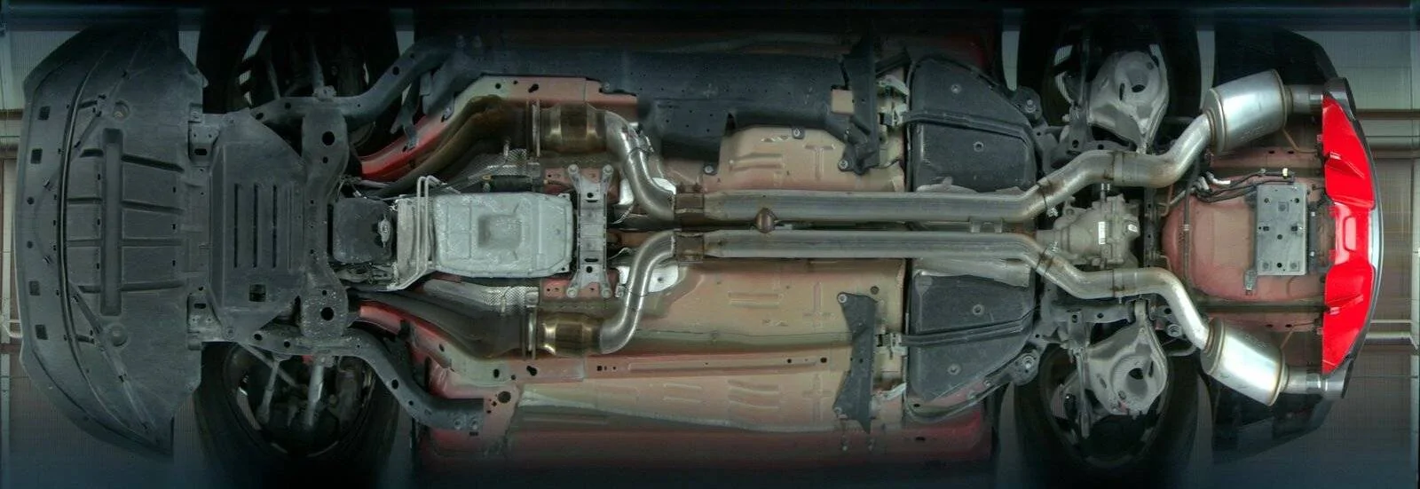

In the meantime, I found a picture of the underside of my car on a Russian language car site of all places. It looks like it may have been taken when the car was being auctioned earlier this year.

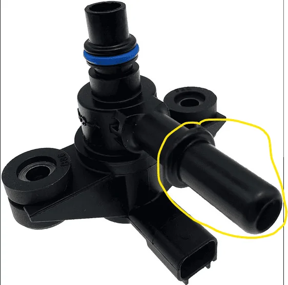

Hot damn the FR3Z-2420-J hose setup came in this morning and I just picked it up. It looks like I now have a nice, neat connection for everything except for the nipple that comes off the vapor canister purge valve on the intake manifold. It probably just T-connects to one of the hoses I have. Hopefully I can get that sorted today, then it is Lund time time and hopefully a running Coyote!
