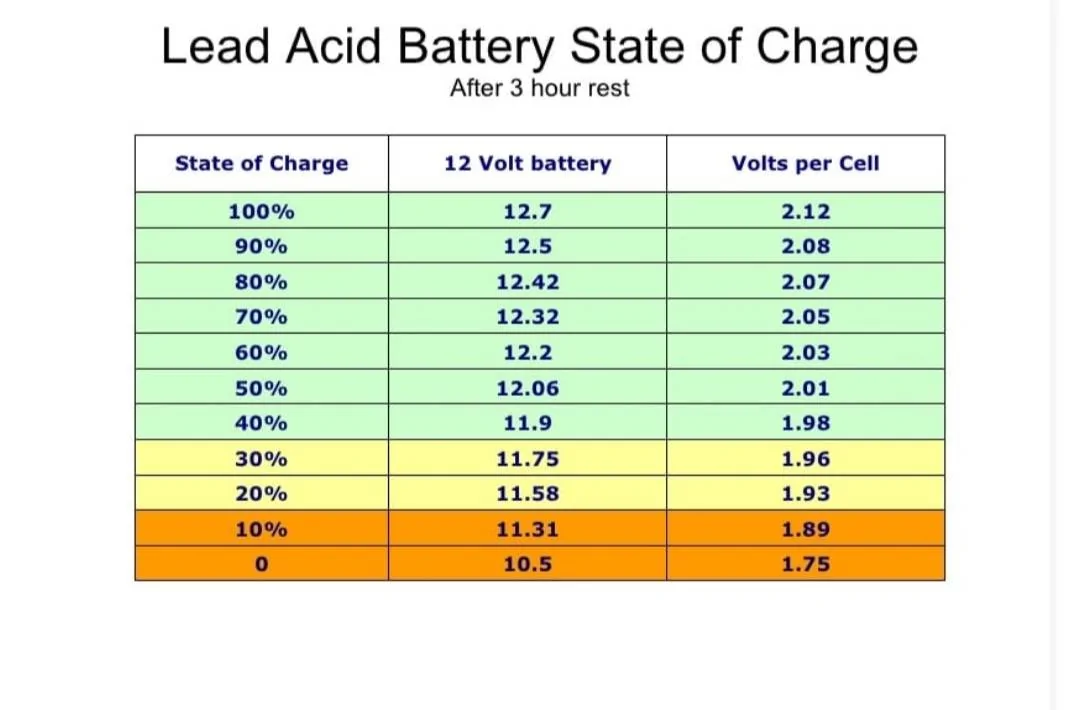

Not really.
More like nearly discharged.
CJJon, You might try charging it with a good charger then having it load tested. That will tell you the true condition of the battery.
I have a battery tender that I must leave connected or the battery dies in short order. That low voltage was after it was parked for two days without the tender connected.
Time for an AGM...
