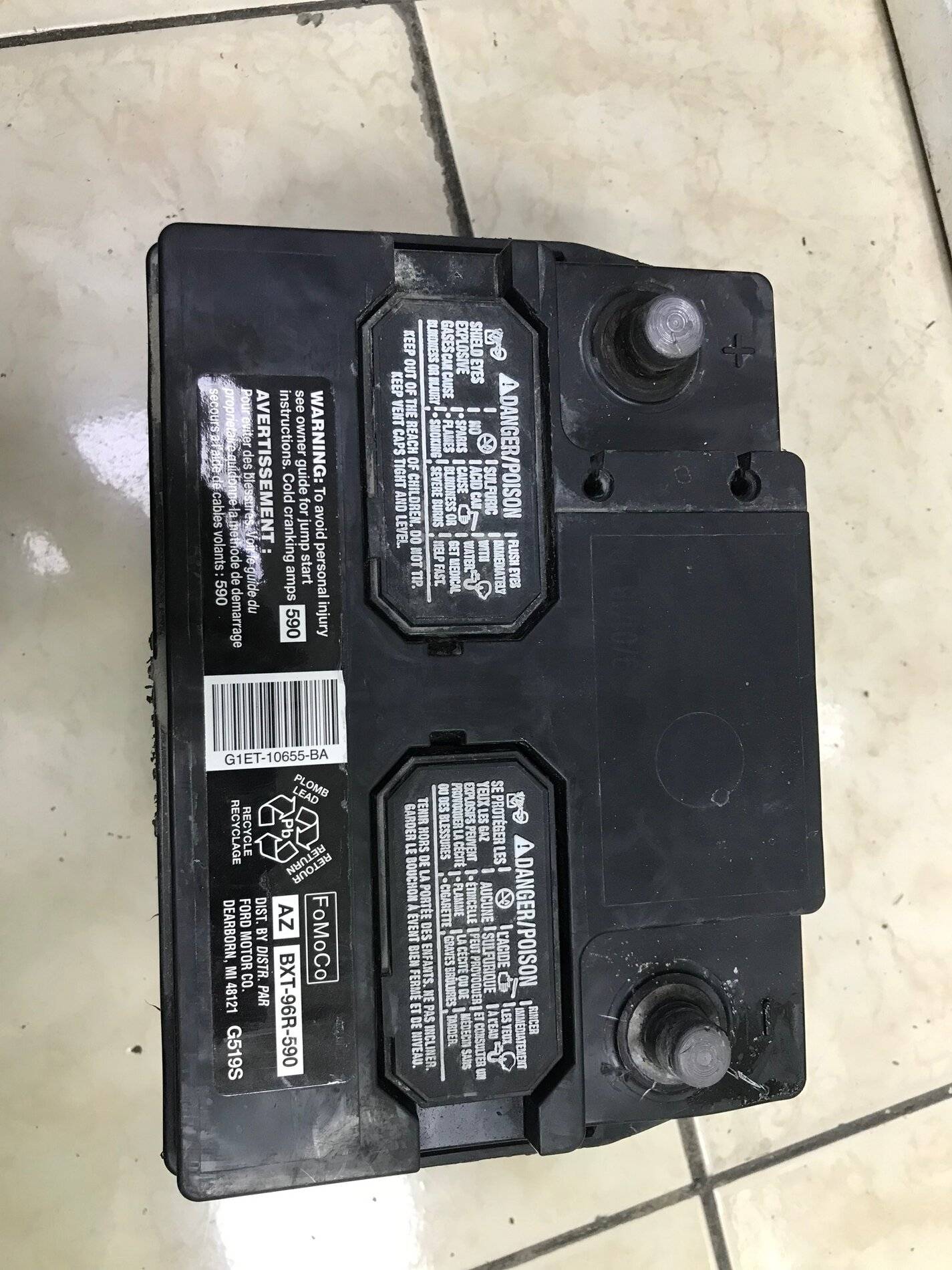

I have a Jan 2018 (production date) GT and the exact thing happened to me 2 days ago. My battery was fine although the voltmeter was showing 12V and then one day I went to a friend's house and we were sitting in my car for 20 minutes listening to music with the switch on Accessories and doors open and afterwards the car didn't start. We got a new battery and afterwards the Voltmeter showed 14V. So I guess 3 and half years was good for my battery life.
What’s happened to the negative terminal ?
WD :like:
It is being negative! Also negative terminal issues/connections and Ford's are synonymous with failure. All of my panther platforms had negative terminal issues at one point or another.
WD :like:
Oh you saw that. I have no idea as I bought this car a week ago, used and I didn't look under the battery cover when I bought it. It was spilling acid liquid.
