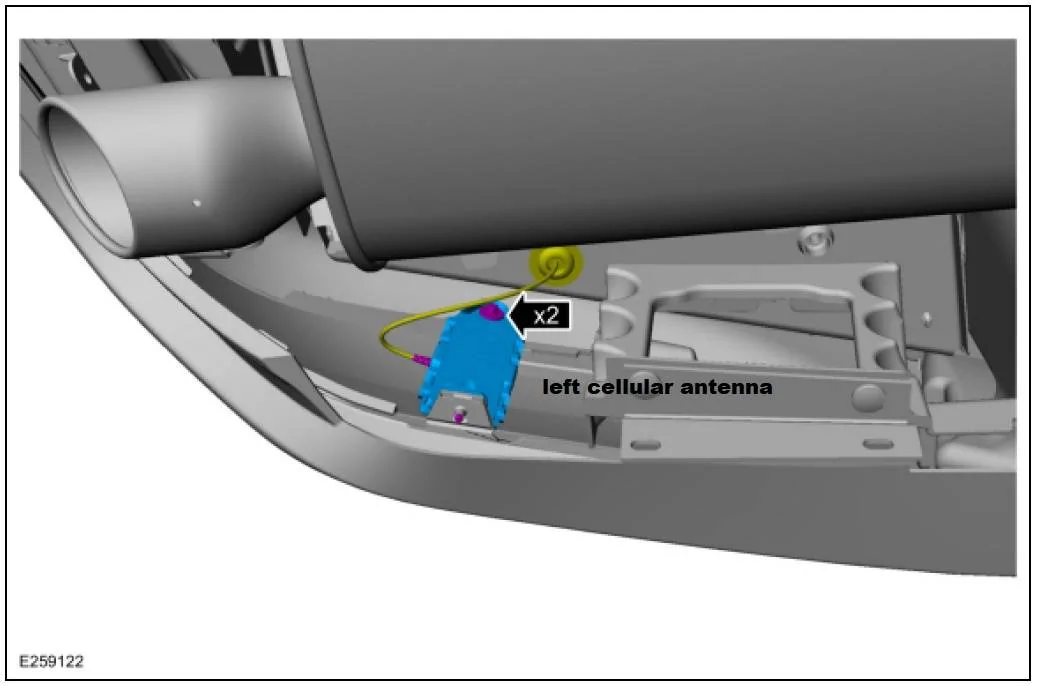

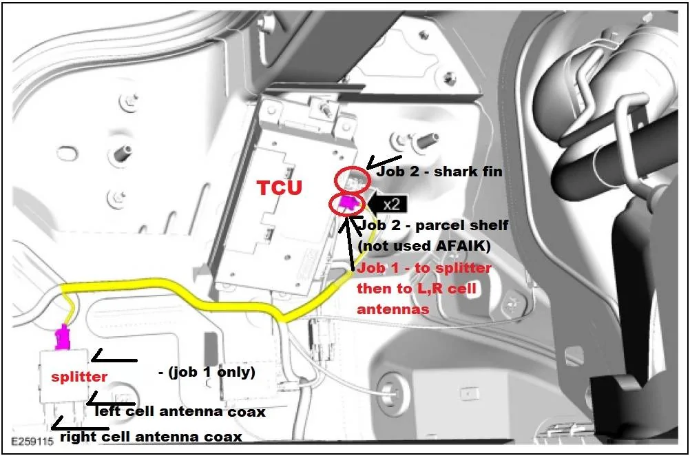

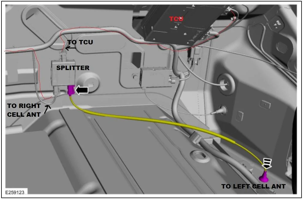

I stated this on another post, the one module that is the root of all evil that Ford has installed is the Telematics module. This little POS communicates to Ford over available WIFI networks.
The concern is valid, but the communications method is different.
Wi-Fi can impact vehicle batteries, drain, charging systems, yes. I encourage people to disable wireless and bluetooth from the in-car menus, if not needed or not in-use. But Wi-Fi (802.11) signals do not travel far enough to be any use to Ford.
Telematics communicates to Ford via the in-car cell antennas, in the rear of the S550. Cell signals, towers and networks are everywhere, all the time. Further, while the Owner can readily turn down Wi-Fi and Bluetooth, disabling the in-car cell antennas take a bit more effort.
I'm attaching a link, a photo and some reference information. If concerned about what Telematics is sending Ford, a fuse can be pulled or a cable can be disconnected.
In the photo, look at the point on the left rear corner, the grey-looking square with some cables attached at the bottom; that's one of the car's cell antennas, referenced in the logical diagrams. There's one on the right side as well.
As to how often Ford uses the cell link, IDK. I've never tried to measure that.
As to the Auto-update features, yes, that could be turned-down as well. I know when updating Sync and from several reference documents, updating in-car systems can draw a lot of power. I turn off auto-update on everything I own, for both power and security. I like to read-up on any updates before installing. Periscope up, update, periscope down.
From a power perspective, one can down Wi-Fi, Bluetooth and Auto-update.
From a security perspective and what Ford sees, one can down Telematics.
https://www.mustang6g.com/forums/threads/the-how-to-disable-the-data-link-to-ford-thread.146863/
