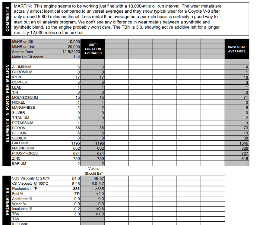

That's your guess/opinion.
Lots of people have had Blackstone tell them their oil is just fine within the OLM range.
Yep, on my 14 Coyote I got it brand new and changed oil every 10K miles. Burned through a Quart every 10K miles all the way up to this test below at 120K miles. At 10K miles on factory MC synthetic blend oil was in excellent shape.
