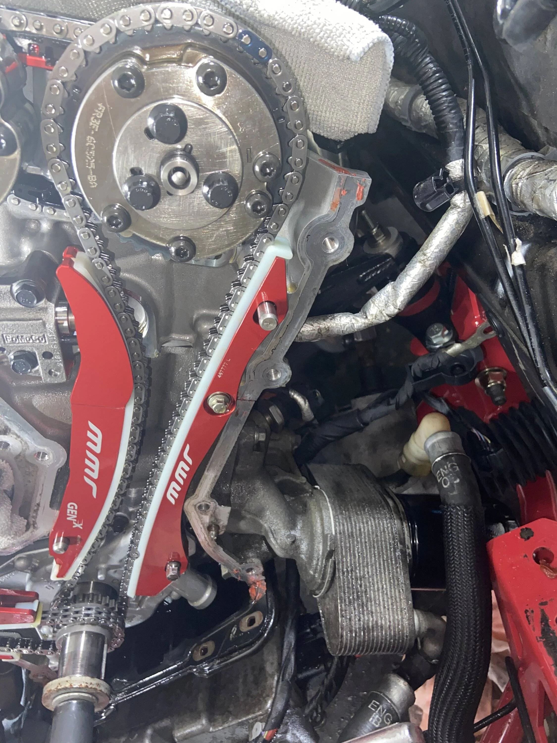

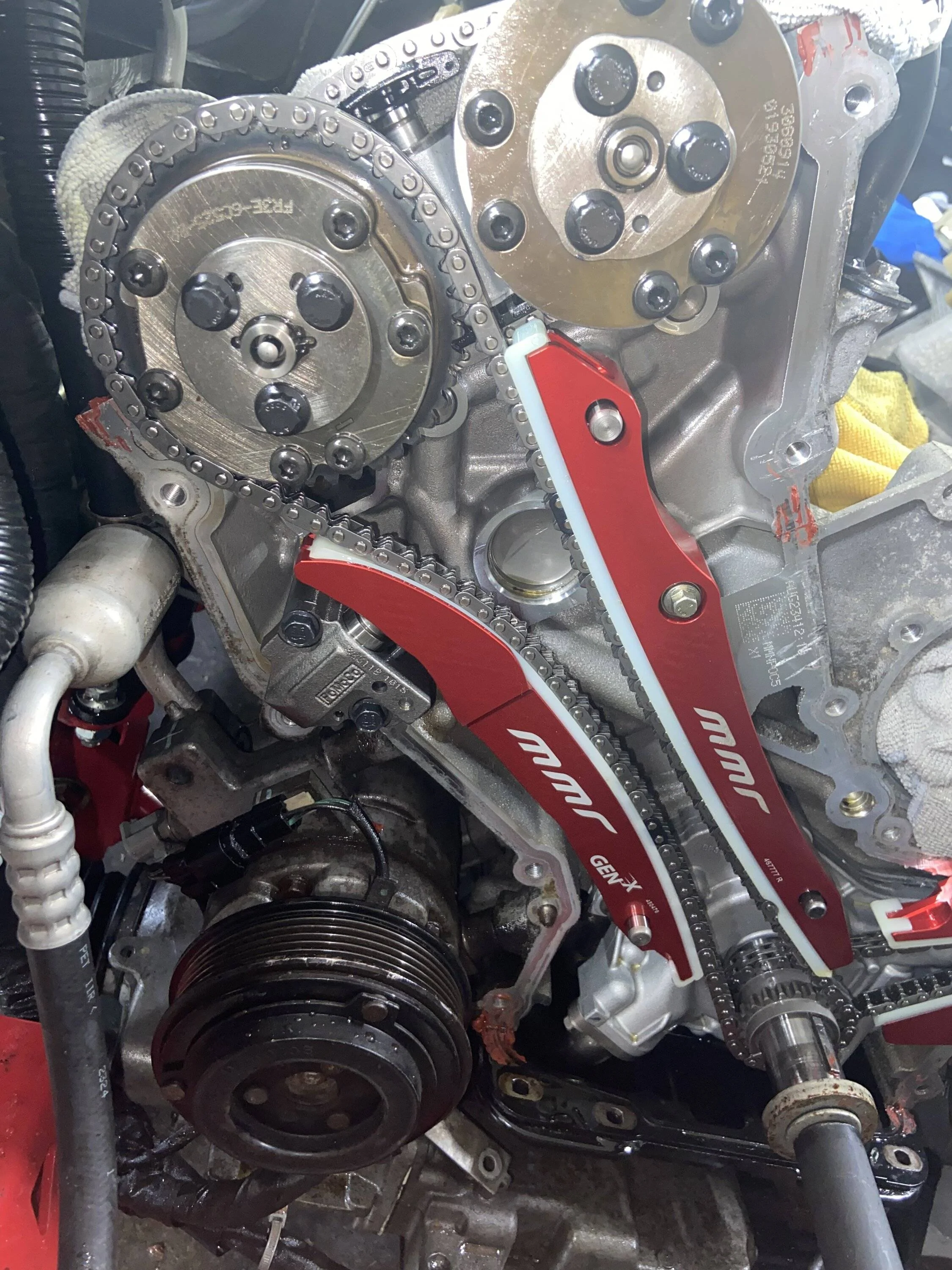

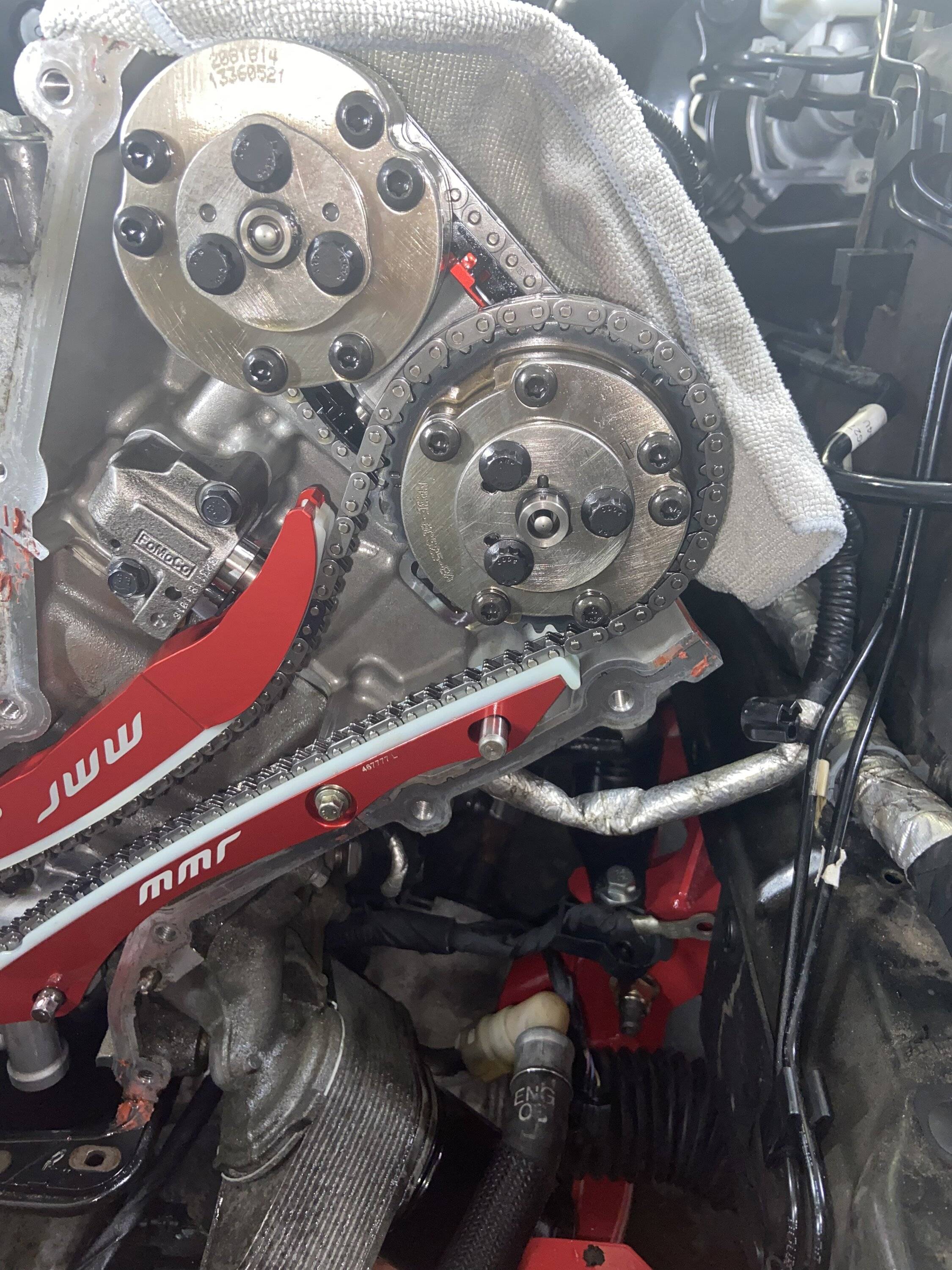

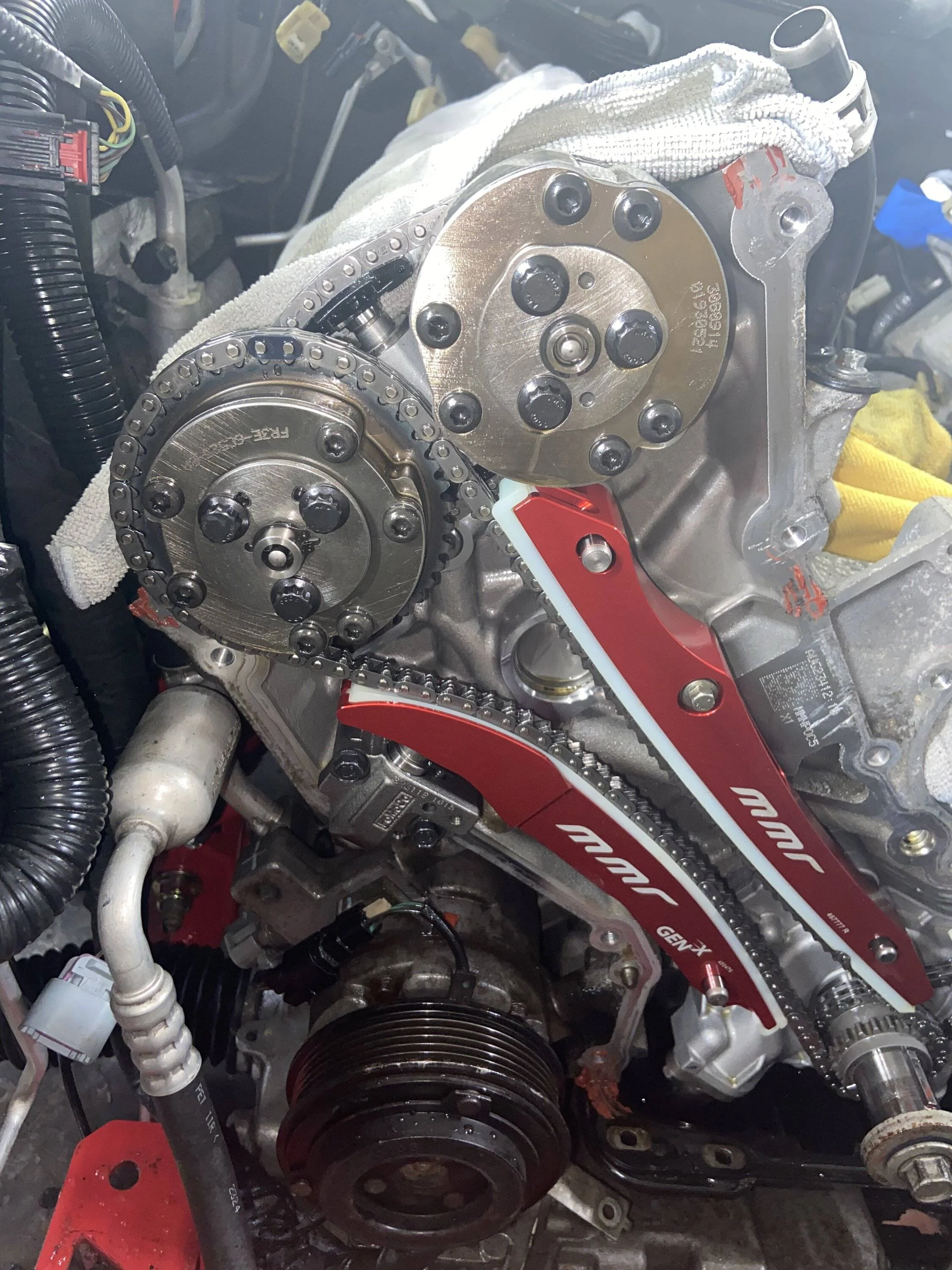

Pics for reference after retiming today

So with the keyway at 12 you can see the R mark in position and after spinning to 5 you can see the L mark in position. Before reassembly can anyone tell me if this is correct ive spun it over a good couple times now and everything seems right but im unsure.

I'm no help at all, but I have to say, MAN those tensioner guides look sexy as hell. Too bad they are covered up.

I wouldn't trust aftermarket gear timing marks (other than ford). Verify they are correct.

I agree but its comp chains they’re stuff is usually soild i verified everything was correct to my knowledge assembled everything last night and after primping it started first crank just need to put exhaust on and drive to see if codes come back. Its just strange i didnt change anything when i took it apart this time but anyways i will keep the thread updated to maybe help someone else out.

I really appreciate all the info i was gonna wait a little bit longer to make sure but as of now after retiming (but not changing anything) its running normally with no misfires im assuming i was off somewhere but im not entirely sure unfortunately. Going to read over these and see what i couldve done wrong to know for my other if i decide to do it.
