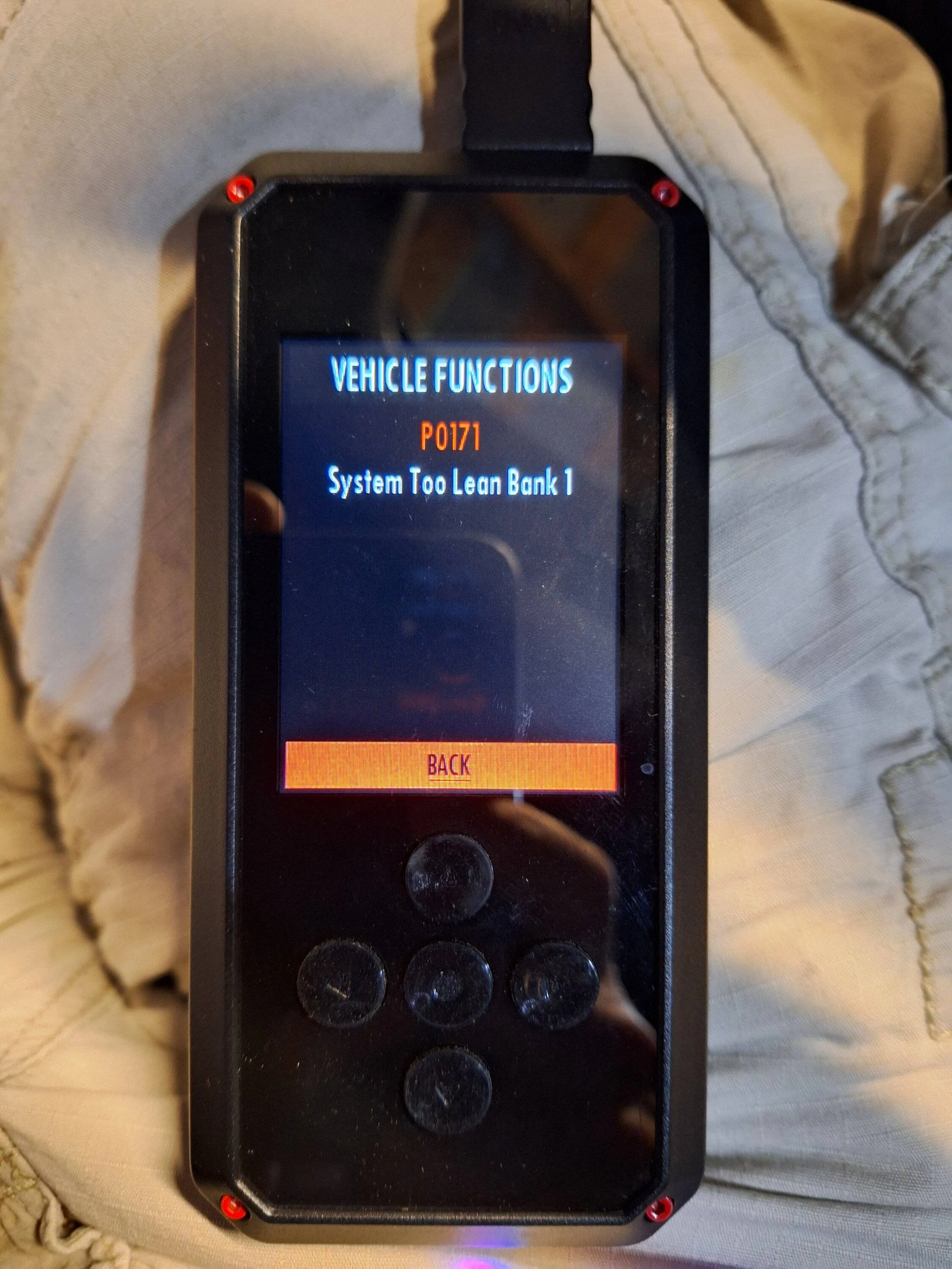

New to me 2019 GT Premium has these codes. I've researched them individually but I'm wondering if collectively they mean something. Before I start diagnosing them one-by-one, I am checking to see if anyone knows if ithey could be from one source.
P0171
P0420
P26C5
JLT Cold Air Intake

I'm betting an header/exhaust leak on bank 1.

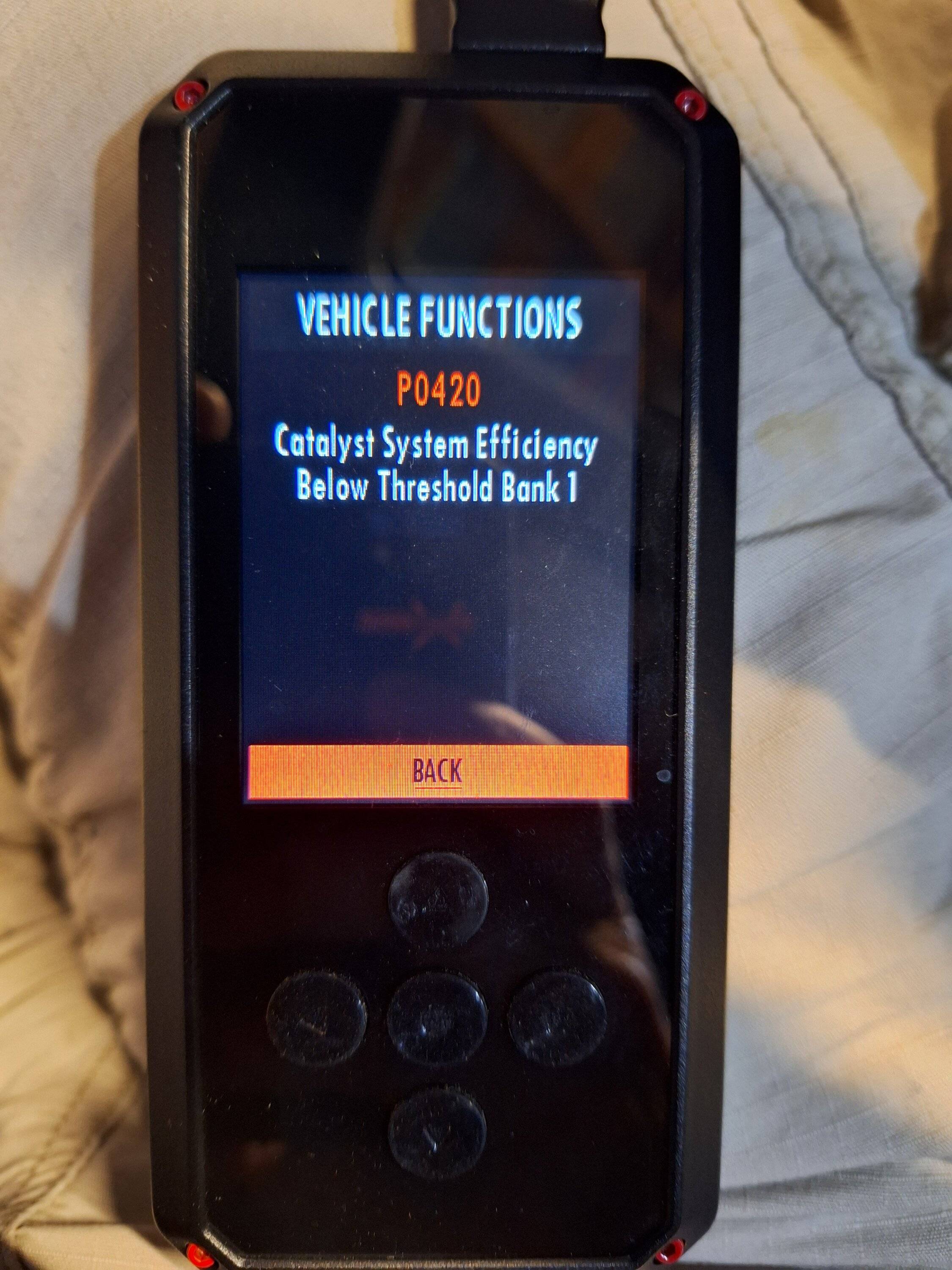

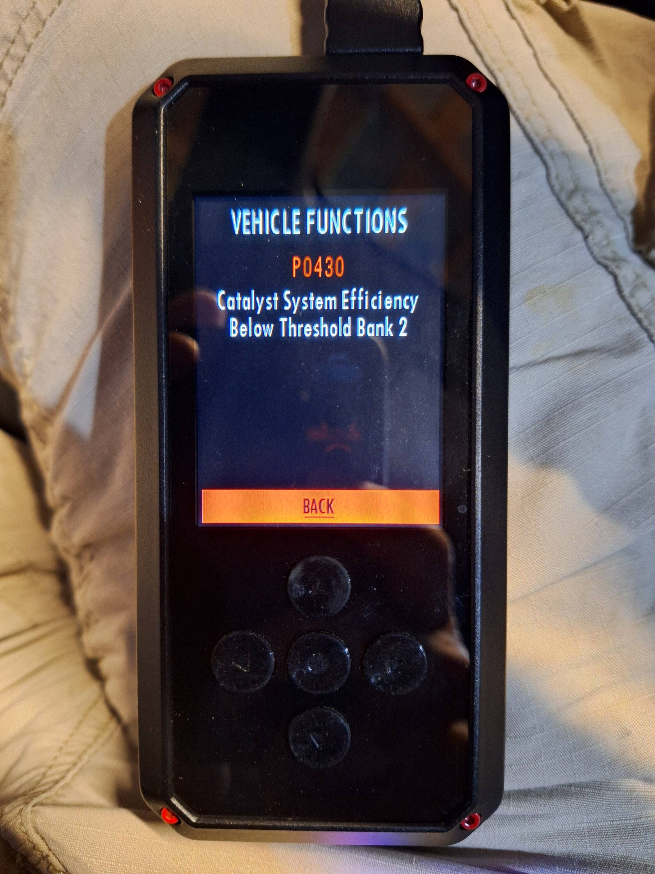

As for the catalytic converter codes they probably just deleted the catalytic converts and the car is detecting that and throwing codes.

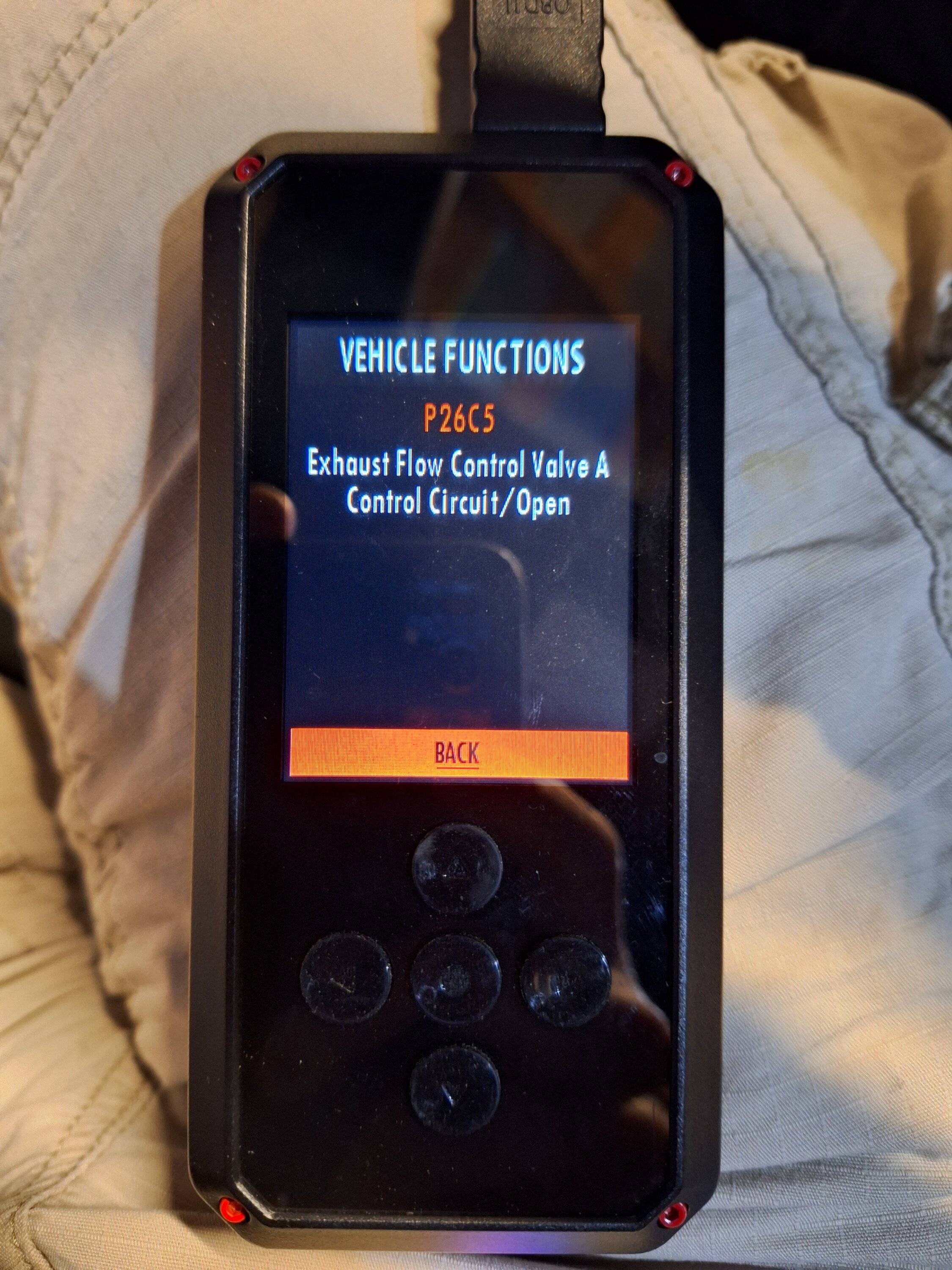

P26C5 is probably because the car had active exhaust from factory and the aftermarket one deleted the active part causing this check engine light.

P0420/P0430 The Kooks are catted? Check the 02 sensors. If there are not cats, then you will have the codes.

P26C5 Valve A is just one side of your active exhaust. If the AE is working, just clear that code. The code probably popped up during maintenance. If your AE isn't working, check the actuators and harness near the mufflers.
Edit: Reread your initial post. Sounds like you know how to trouble shoot that code, sorry for stating obvious.
