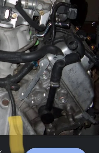

My first thought was to put a tee in the MMR hose and return it to the water pump inlet. But I don't know if this would cause more problems.

If the flow path is from back to front it would make sense to tap into the heater feed hose. This would place high pressure water flowing into the rear of the head.
I noticed in another thread you said it works. Have you done this? If so how did you plumb it.

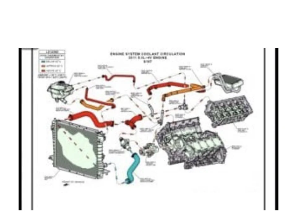

It would be helpful to see a 3D diagram of the cooling routing, which is difficult to find.

Best I saw was a ford manual pic that an article on forddiy.com or something had posted.

coolant comes out of the front of the passenger head into the heater core back into the Drivers side at the water pump
