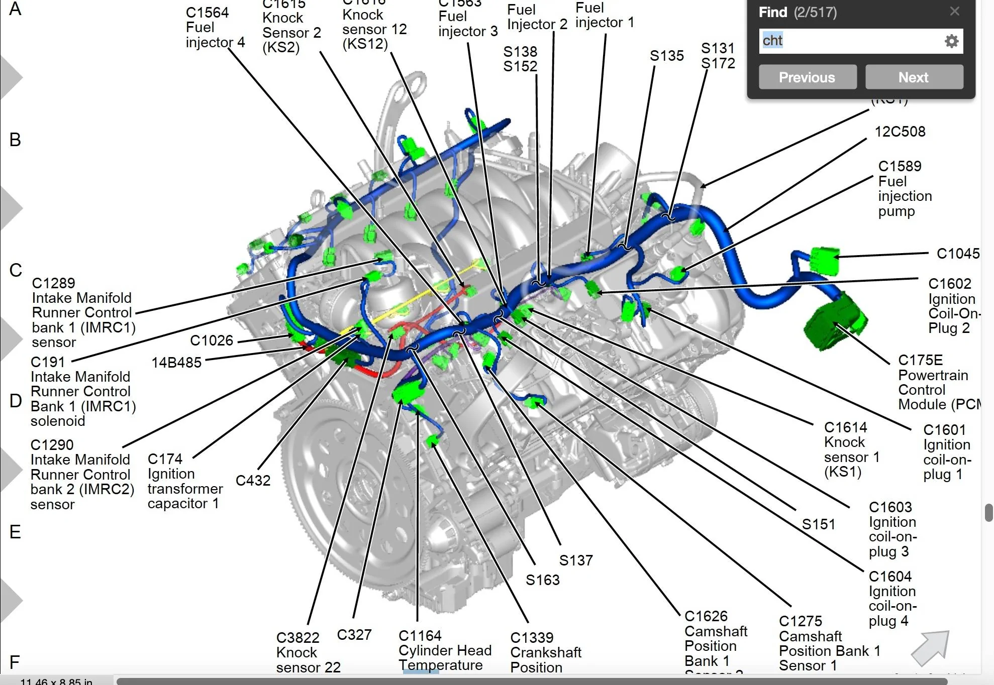

CHT by #8 cylinder - at the most vulnerable cylinder so they say. I don't think we need to be concerned?

there's a reason why most ringland failures happen around cylinder seven and eight
Right, which is why I wonder about Ford not correcting it.

CHT by #8 cylinder
That is cylinder number 4
Ford numbers the cylinders passenger side front of engine is
1 2 3 4 driver side is
5 6 7 8

4/8 or or 7/8 depending who's convention you're using, those last on the row are the problem.
