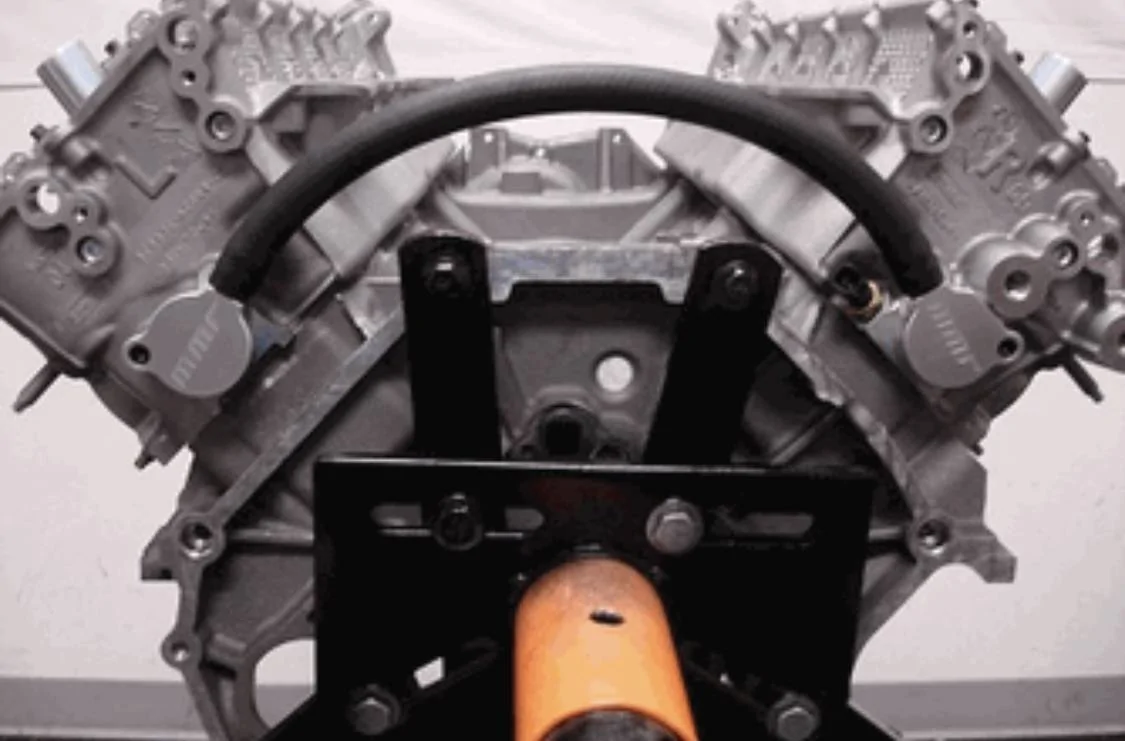

Anyone done the cylinder head cooling mod?

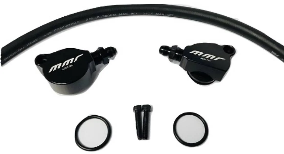

I’ve seen MMR and VMP have them. You pop out the freeze plugs on the back of the heads and attach coolant hose so coolant can go from one head to the other.

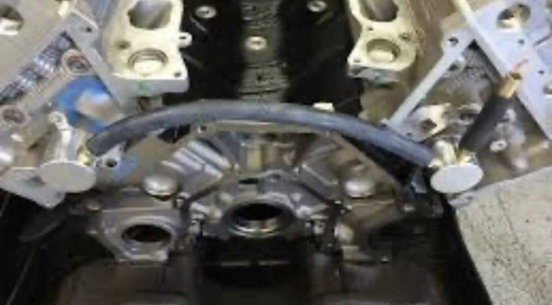

I prefer the cooling mod to allow water to flow out the back of the heads rather than just transfer from one into the other you can see on the picture it goes from one into the other and then out if it just goes from one head to the other then you put a T in there and go out to your heater core

It is super easy. You just knock out the freeze plugs and it bolts right in

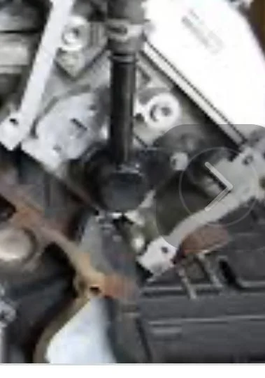

I do them in the car. Unbolt and Remove the firewall protecting the battery. Knock them in. use long 45* needle nose and pull it out.

Torquing the bolts doesn’t really matter it’s an O-ring that keeps the seal. on one head it has two bolts and the other has one. They fit in pretty snug the bolts just keep it from back out. I think there is a lot of room to work back there

They are not near press fit at all. it’s just an O ring. fits in as tight as the water pump. After the freeze plugs are out it slides right in,put a bolt in Dune
