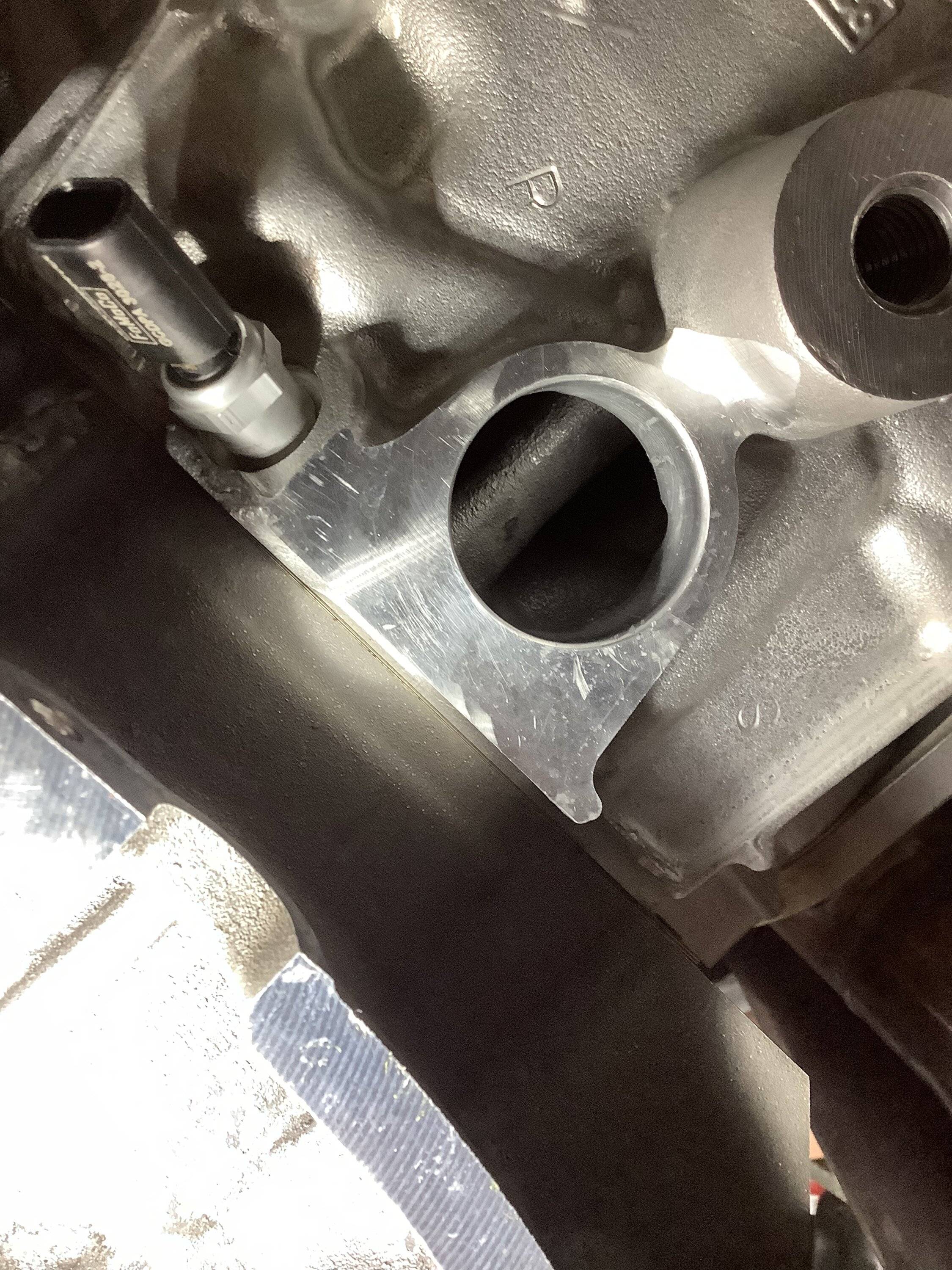

Okay, I’m at the point to where I’m ready to install mine. Unfortunately, there are no updated directions on MMR’s site for the 5.0 Coyote engine. I’m going to try and get this installed, either today or tomorrow. I’ll let you guys know how it goes.

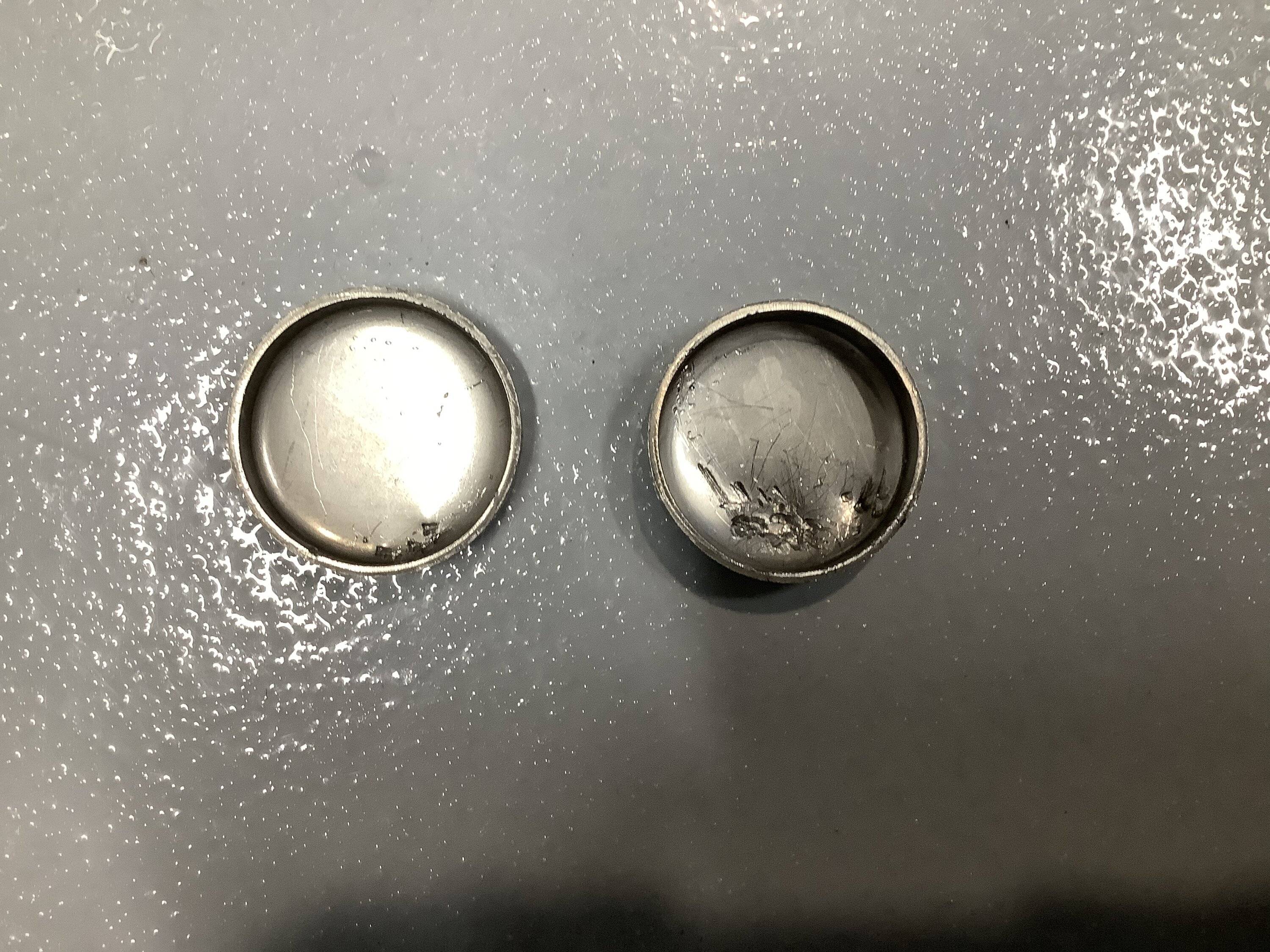

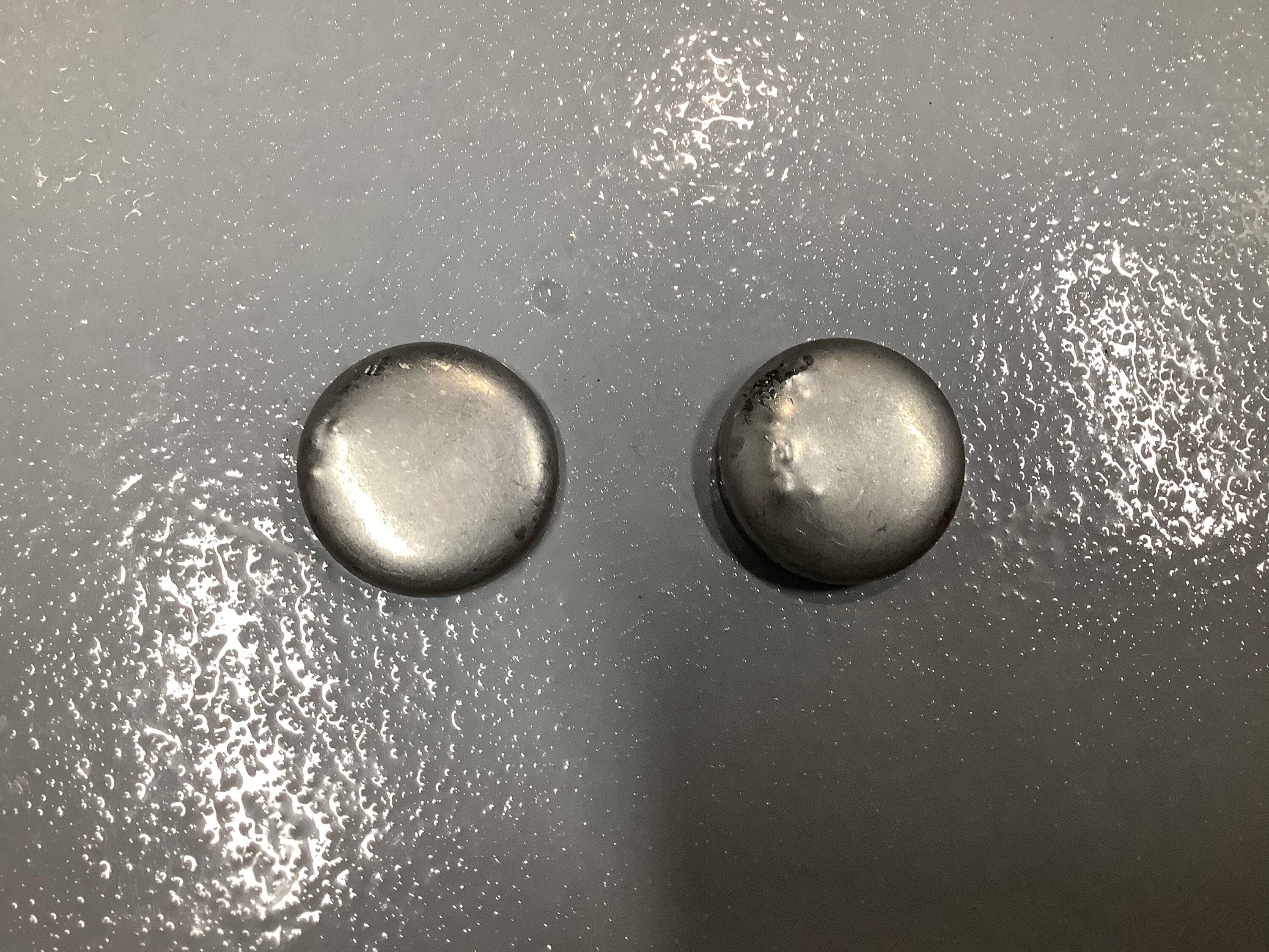

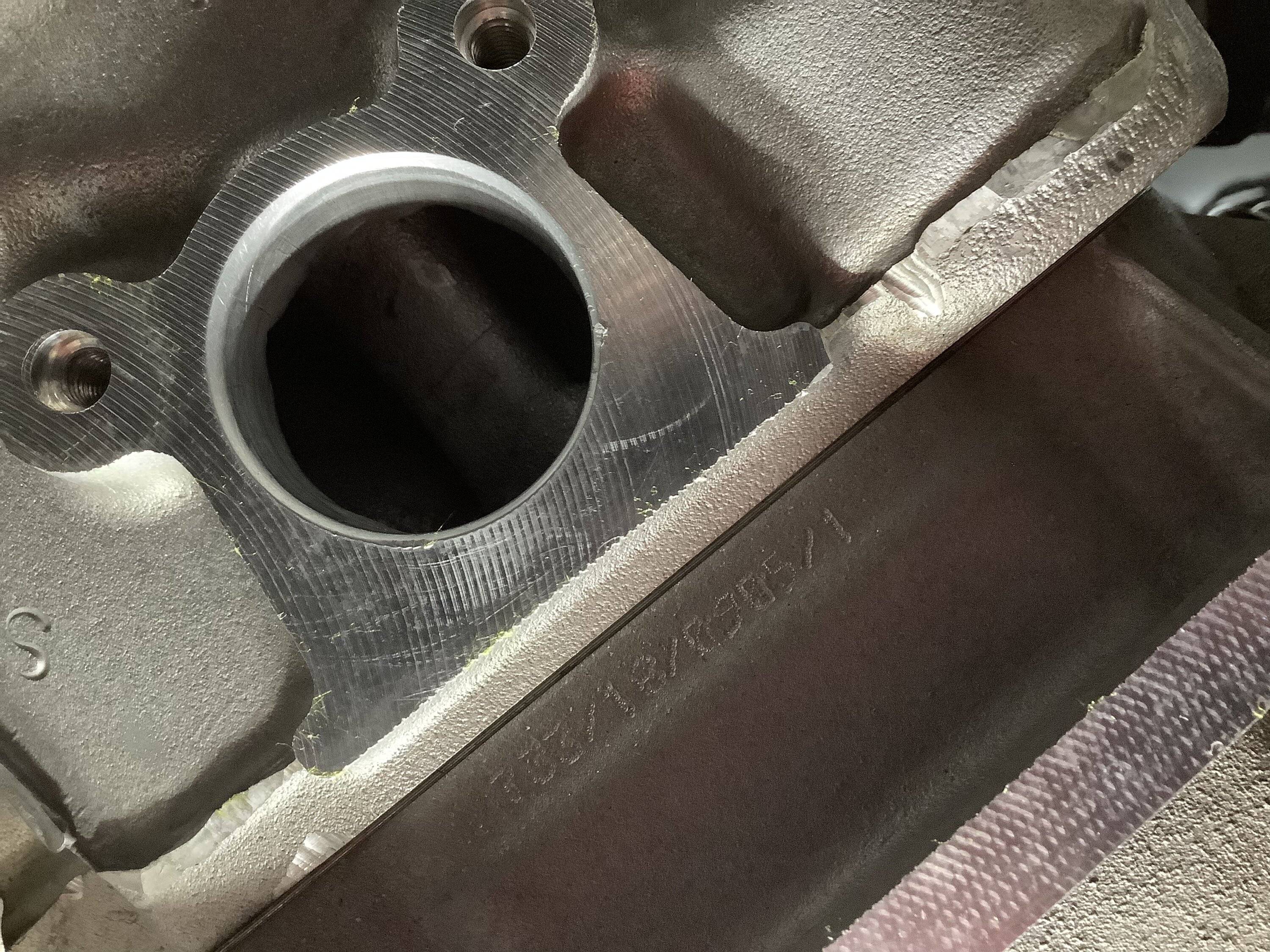

Copy that. I put them in the freezer last night. This morning I‘ve been working on removing the freeze plugs and let me say; “what a PITA it has been.“ With the transmission out and clear access to the freeze plugs, ish still went awry. The plugs decided they wanted to do their own thing and went completely into both heads, causing me to go into a mode that I refer to as “Panic at the Disco!” After about an hour and a half of thinking of every way possible to get them out, I had an idea to modify a plastic trim panel tool, which I used along with a flathead screwdriver and carefully pried them out. Unfortunately, both plugs caused gouges in two spots in the bores. To,address,this issue, I carefully sanded down the gouges in both bores with 150 grit paper, followed by 1500 grit paper. I cant imagine anyone doing this without causing some sort of gouging in the bores because the pugs don't just fall out, they have to be forced out. Needless to say, this is why MMR mentions the use of high temp RTV sealant if this occurs. Just FYI for those who will be going down this road. I have everything prepped and ready, except I’ll need to purchase the aforementioned RTV sealant and wrap things up. Lastly, to those who have been able to do this with the engine in the car, I tip my hat to you guys, because I would never attempt this.

I forgot to mention that the freeze plugs are very strong (stronger than the bores In the heads), hence the gouges created by them upon removal from my heads.
I’m not trying to scare anyone by sharing my experience. I just want to let it be known that if you encounter any of what I did, it will be impossible to get them out, sand the bores and apply RTV sealant to the bores and cooling mod stand-offs. With the transmission in place.

I can’t imagine doing this in the car. I did them with the heads sitting on the work bench and it was still difficult. I scratched the bores like you did and sanded them smooth. Used a tiny bit of Permatex Ultra Black on the o-ring and it’s been sealed perfectly for two years.

I was gonna say, even having the engine out of the car doesn’t mean it’s gonna be a walk in the park. I should be good to go now. Just need to pick up the RTV sealant and get on with it.
