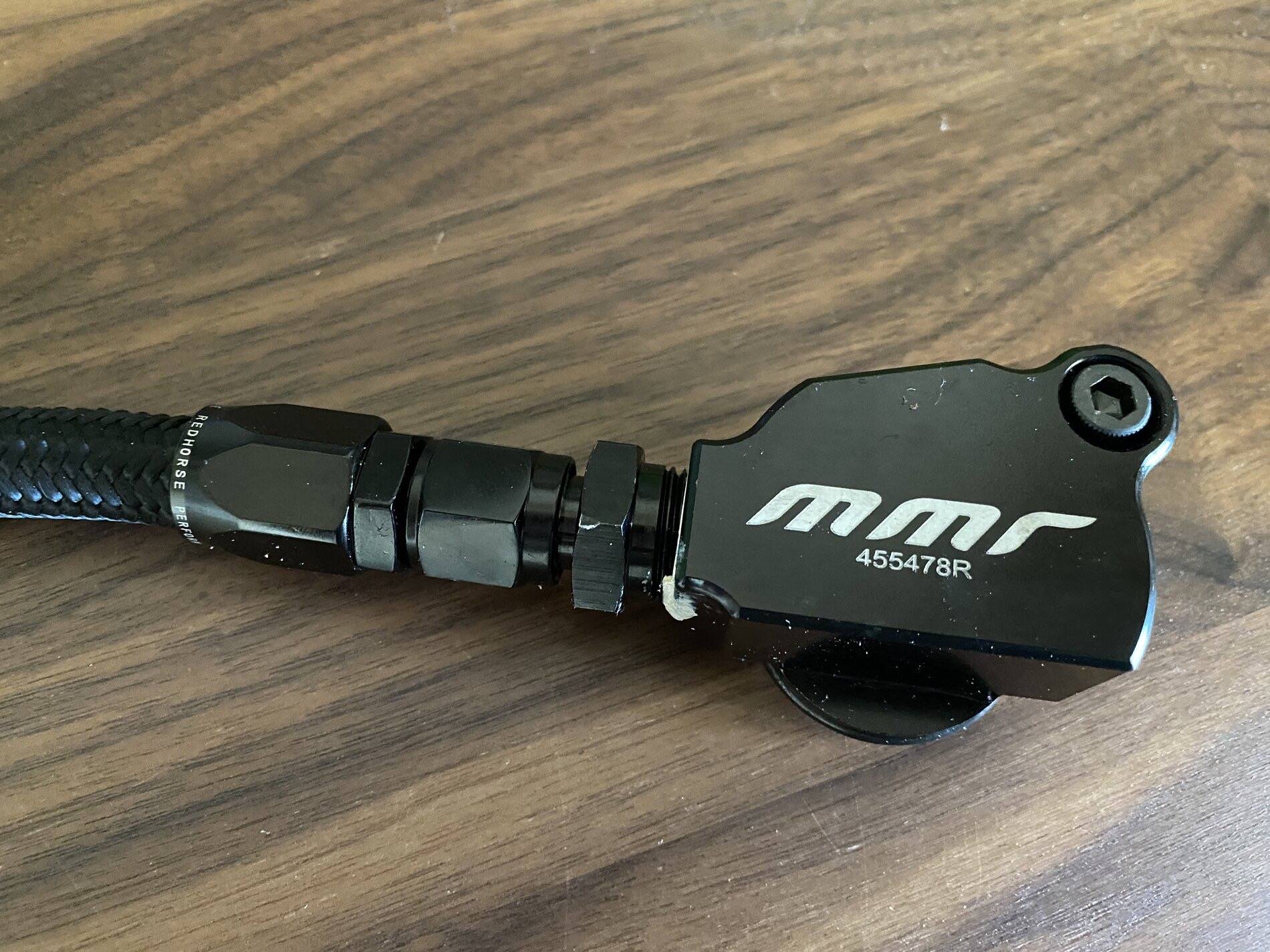

This piece. That may not be the correct name for it though.
Does your kit have these pieces? This isn’t what I’ve seen in other posts. I have a massive bolt and a skinny bolt I thought it was the same on both sides

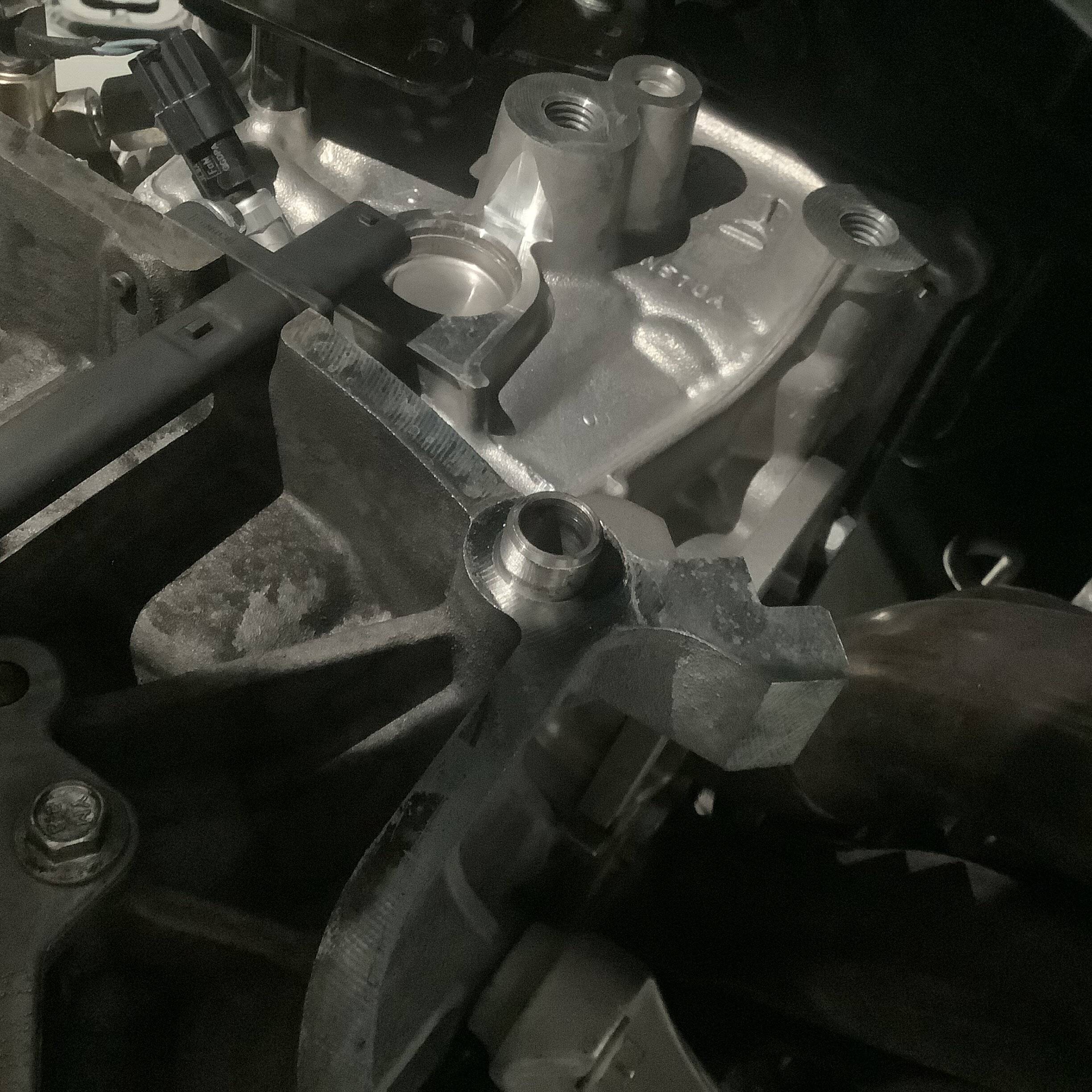

I don’t have the kit yet. I just ordered it a couple of days ago.looking at what you have, it appear thst it’ll work on my 2019 Bullitt. There is a large threaded hole on the passenger side head. Stay and I’ll go grab a pic real quick.

Here’s a pic. It looks like it’ll work. I was worried for a minute there.
Hmm maybe it’ll work for mine too then. It said 2018 and up when I ordered it. I’m actually paying someone to supercharge my car and do all the other mods and dyno tune it. Jackson on here said he removed some wall behind the battery and did it through that. I don’t have the tools or the time to do this myself
