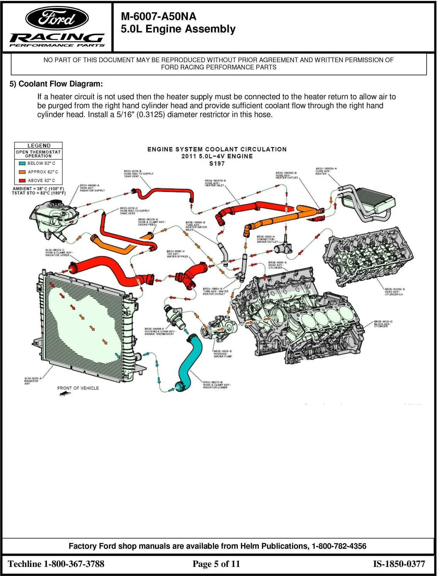

I take it you think its bs that the number 8 cylinder in the coyote and 5.2 get much hotter then the others. I guess the detonation issue’s on that cylinder don’t exist as well. Plenty think a bigger radiator is a waste of money to. Makes no difference to me if someone installs the bypass or not. You guys can look it up yourselves, or not.
What data is available that supports "stop the hot spots"?

I take it you take things as they are presented to you. How does crossing over at the back of each head solve this issue? Makes no difference to me if you cannot provide this data, i just figured id ask.

I'd have to see a 3D of the cooling system and how it flows. I admittedly bought and installed (the motor was out and it was cheap add) based upon speculative information (no real hard data) but on the flip side, it's more than just MMR touting that it helps reduce the problematic #8 hot spot.
I'll concede we haven't seen any real data to back it up, but I suspect it helps to provide lower temp coolant to the 8 hole where it's probably the last of the hogs eating at the trough and the coolant is warm(est) there without some sort of crossover to help balance it out.

To my way of thinking to get more flow at the rear you would run the hoses from the back of the head directly to the radiator inlet.

If coolant returns from the radiator and enters the motor/heads, by the time it reaches the furthest point before being sent to the exchanger, it will be the hottest point. Temperature gradients are quite common in mechanical and chemical processing systems where cooler material enters heat constant heat transfer and by the end of the line, the coolant's capacity is diminished.
A crossover would be a sort of recycle to balance out the coolant temps at the beginning of their run vs the end and result in less disparity between points of the linear system.
This is admittedly all speculation until we see some real testing.
That wouldn't create more flow, it would just rearrange the current flow.
I suspect it's simply to send slightly cooler coolant to the back of the line and end up with less gradient between the start of it's heat sink and the end.
I can post some pretty interesting stuff on reverse vs standard flow in thermal exchange.
