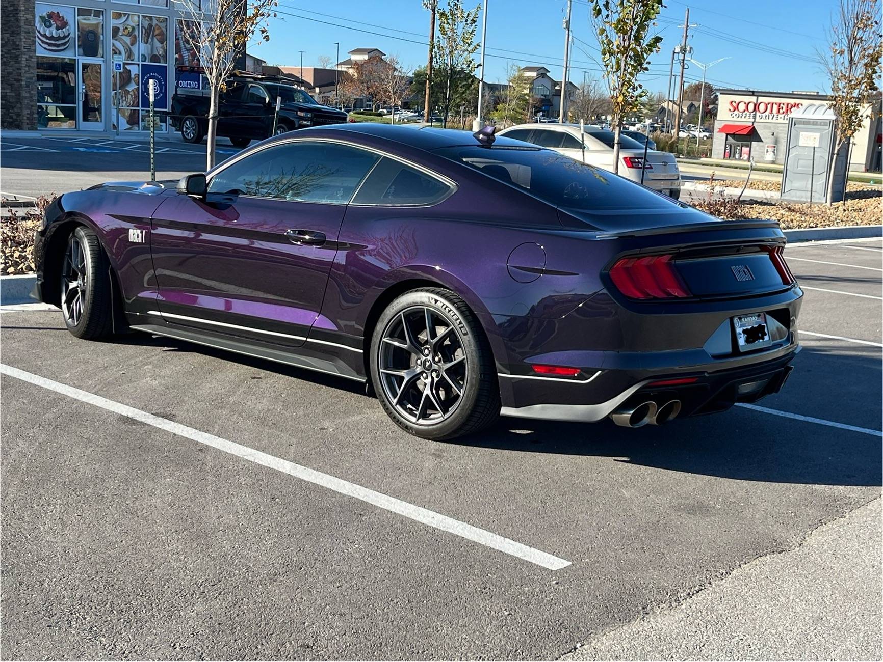

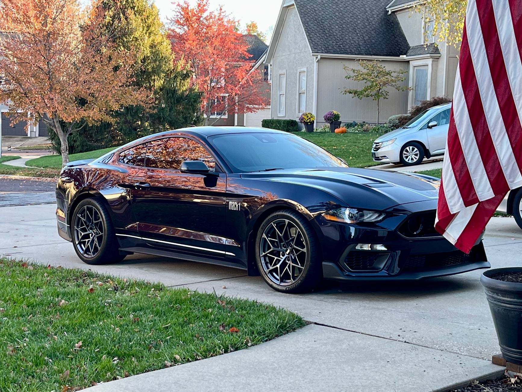

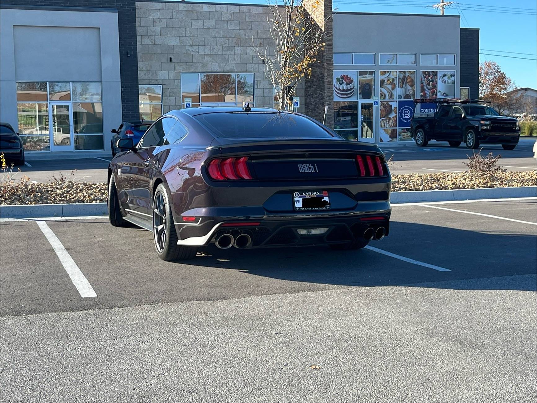

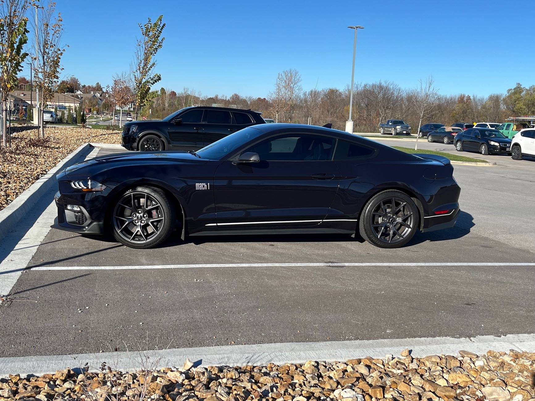

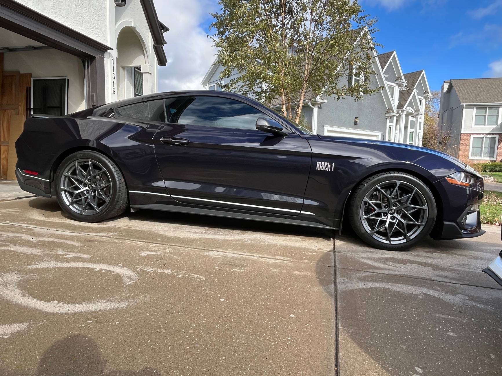

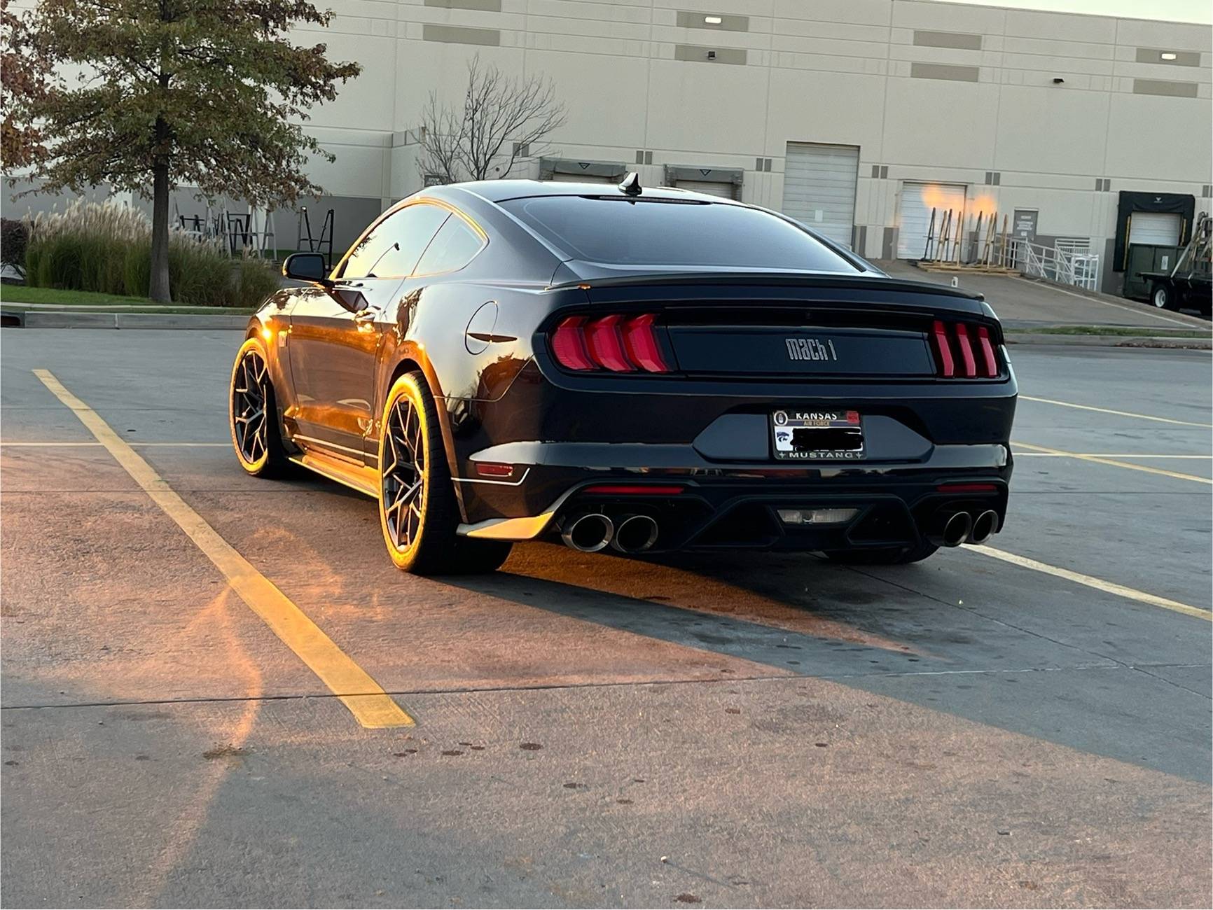

SVE MHP1 wheels are incredible for only $1200 I think. I weighed the rear wheel and 325/30 PS4 tire today. 56 lbs. I weighed my factory wheel and 285/35 Pilot AS4 also. 64 lbs
i did 305/30 on front but you could do 295/30 also. All these pics are since lowered on ford performance handling springs.
