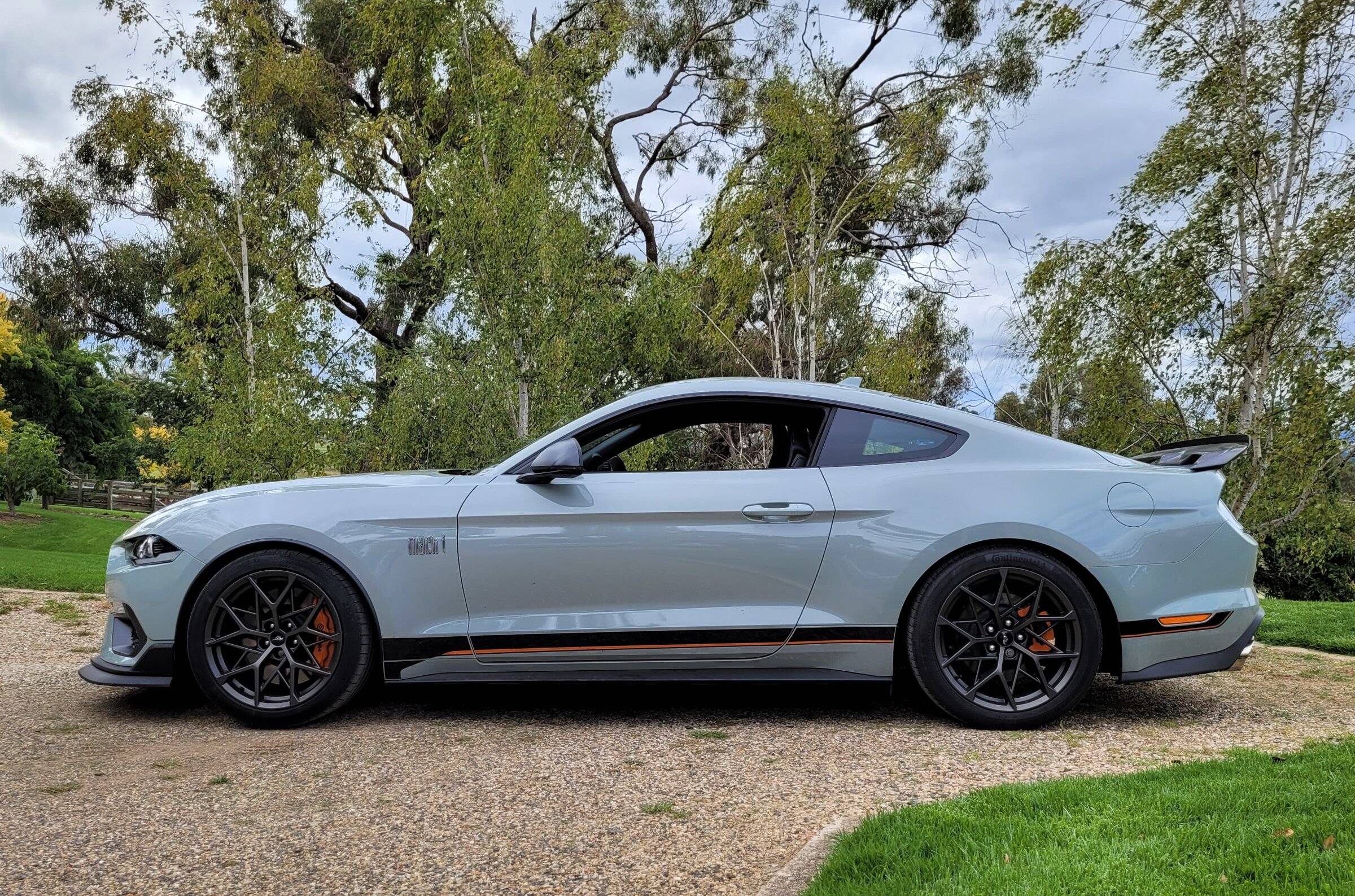

Installed HP front and rear springs, camber plates and solid HP rear bar today.
For the record there's, next to no change in ride height between the HP and standard Mach 1 springs. The front HP springs leave the car sitting around 2-3mm lower, unnoticeable really. The rear ride height hasn't changed.
First driving impressions, in Race Mode the car feels more pointed/direct, feels a little firmer then before as you would expect, still rides well in normal mode when cruising.
Wheel alignment is next.
Further update, suspension has settled completely now and when remeasured has dropped a total of 10mm (measured at the centre of front HP lower splitter), was 130mm prior to spring change now at 120mm.
Rear has dropped around 5 - 7mm.
Keep in mind I'm running 285/295 / 35 series tyres on HP rims.

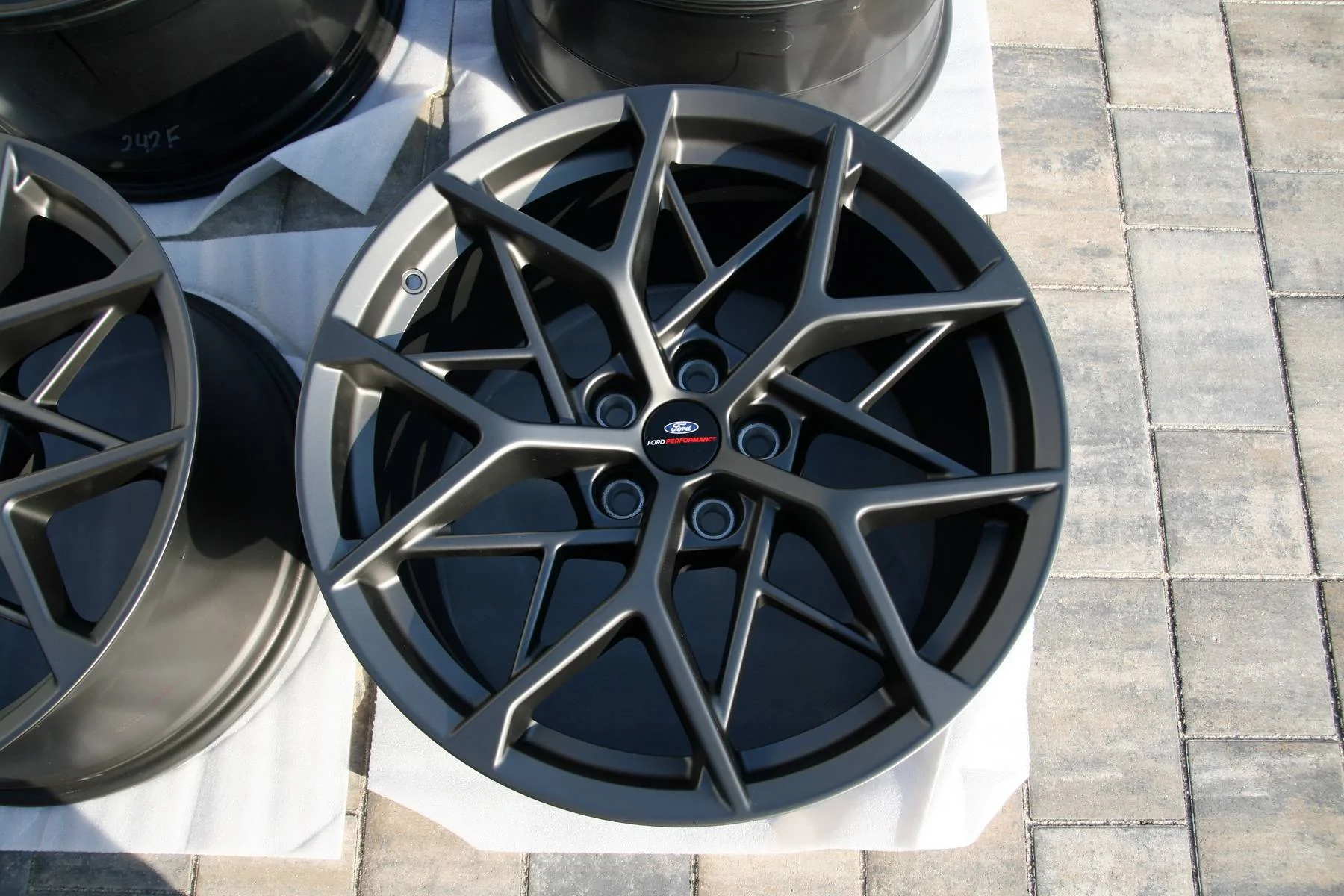

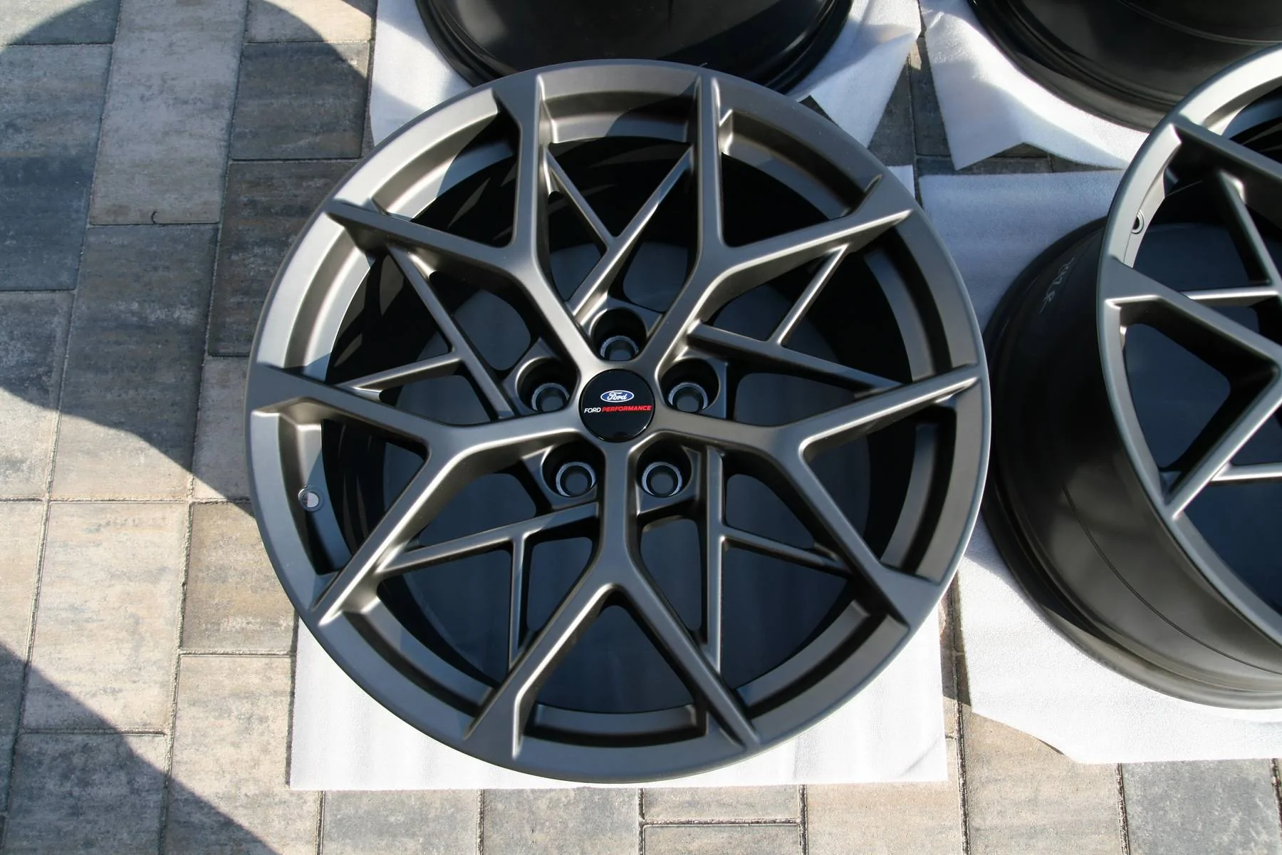

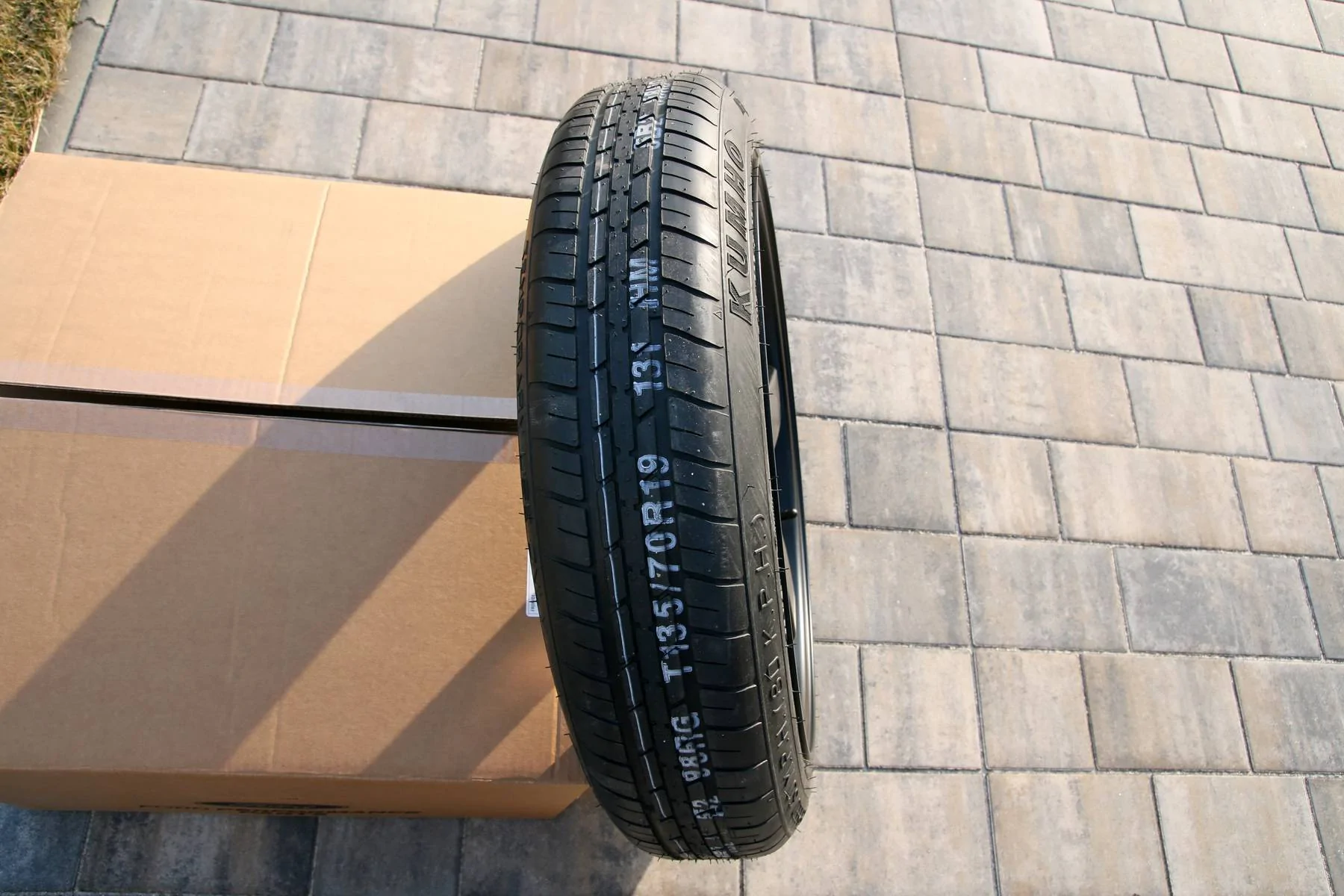

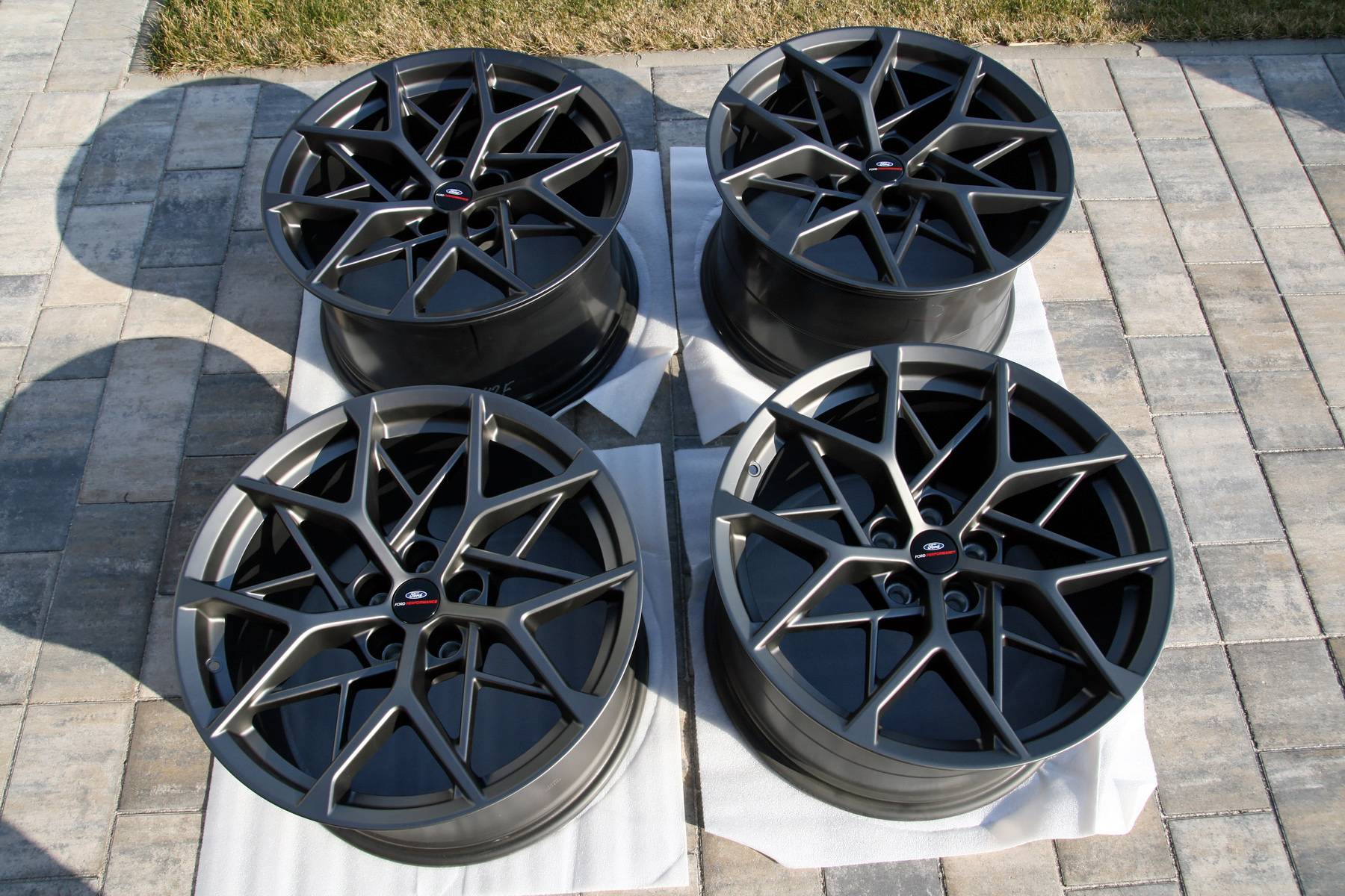

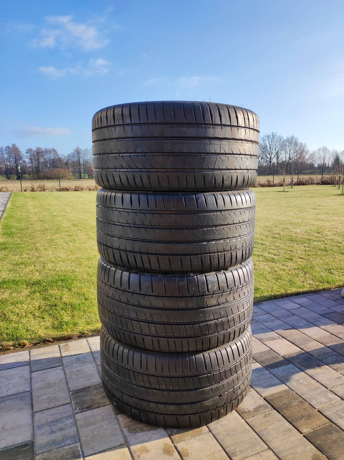

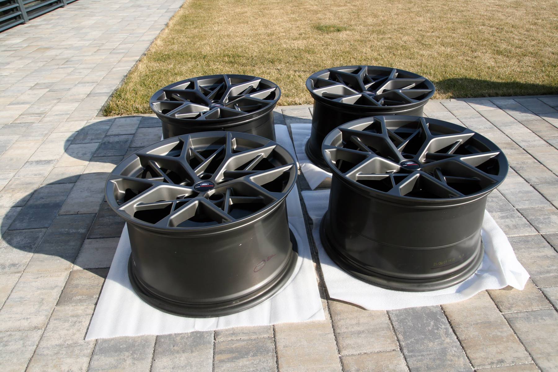

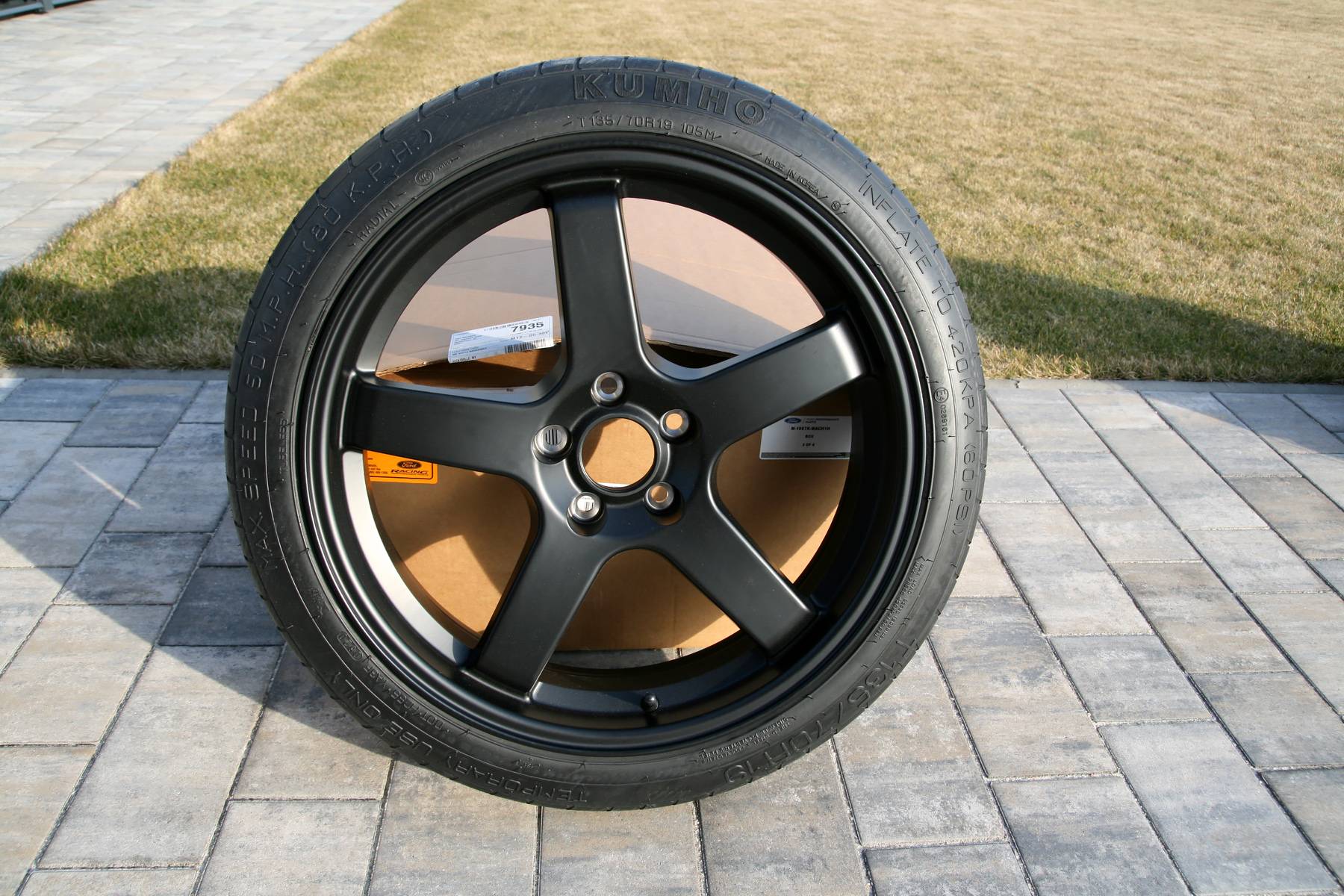

Finally picked up the HP wheels today after 4.5 months of waiting. The ship containers were a real scarcity. Pure bliss. Also got AA reserve wheel and Gorilla lug nuts. Time to get it all assembled :clap: 😍

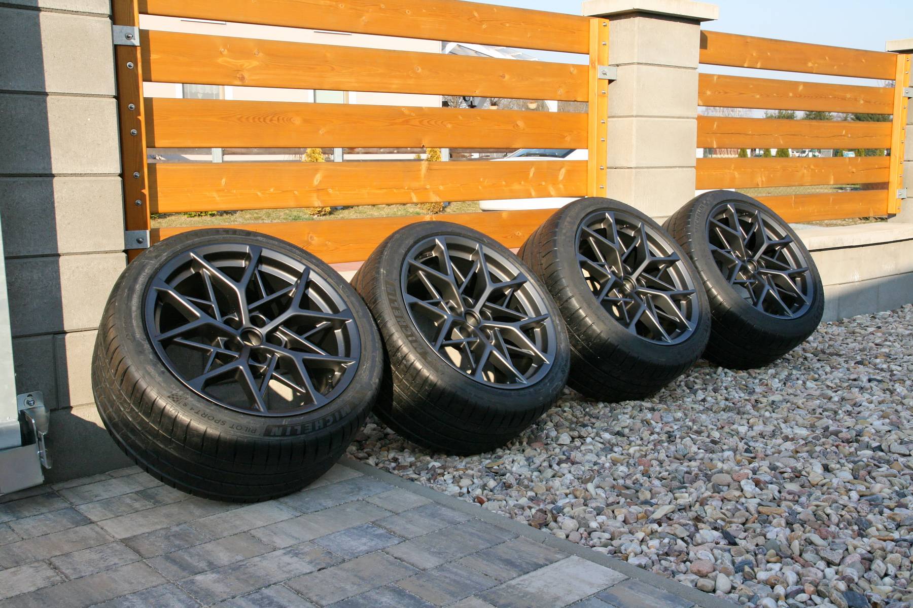

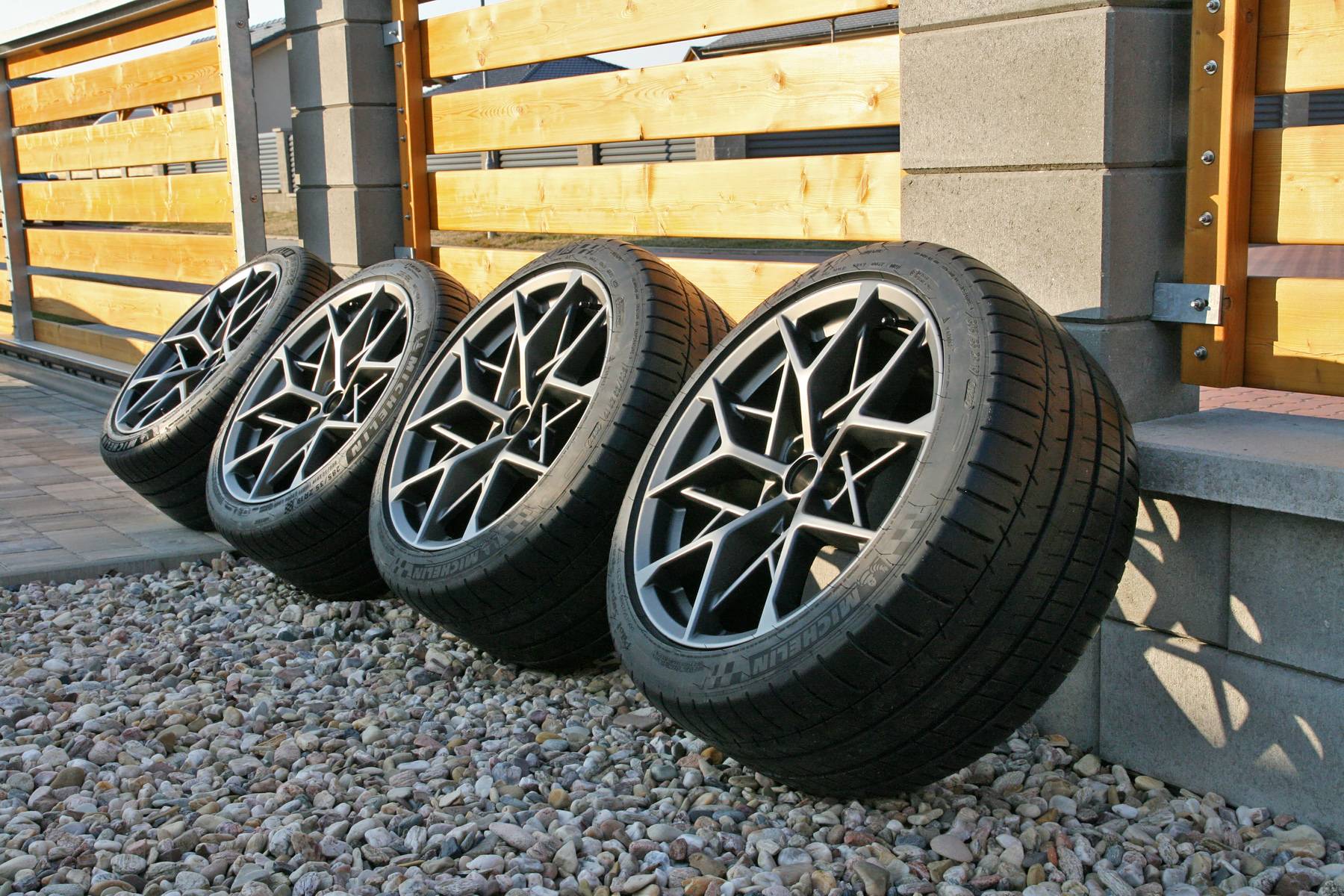

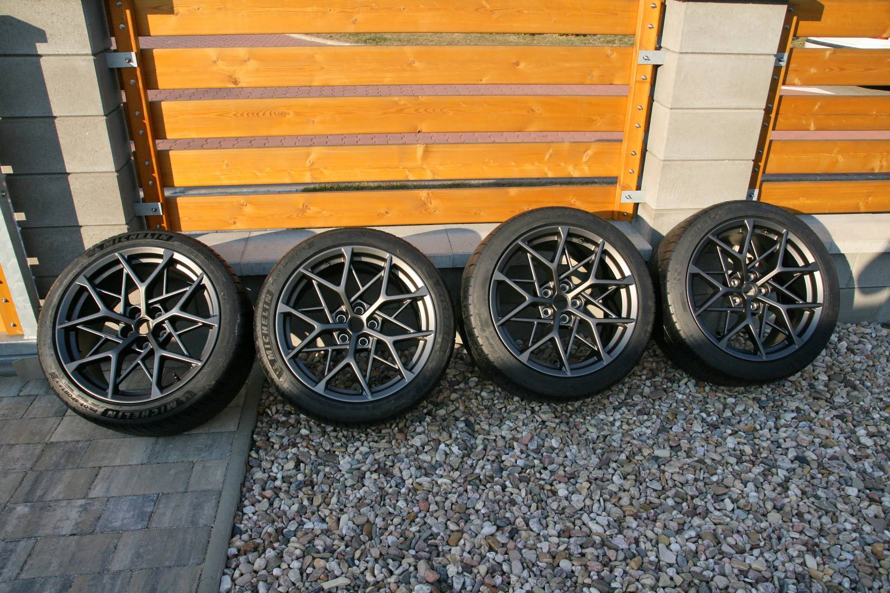

Ride-wise I can report no tramlining with PS4S 285/35 R19 and PSS 305/35 R19 combo. Handling is great. It'll take some time (and no wife) to give it some more spirited beans to know how much it improves handling (though I was pretty much only on winter tyres until now) and sprints too.
The wheel to fender gap looks fine to me, no stretch, basically no poke (only the sidewall's rim protector). I totally love it this way, no need for lowering or spacers.
Truly magnificent wheels, best I ever saw!!!
I did some close ups.

What are the wheel sizes?
