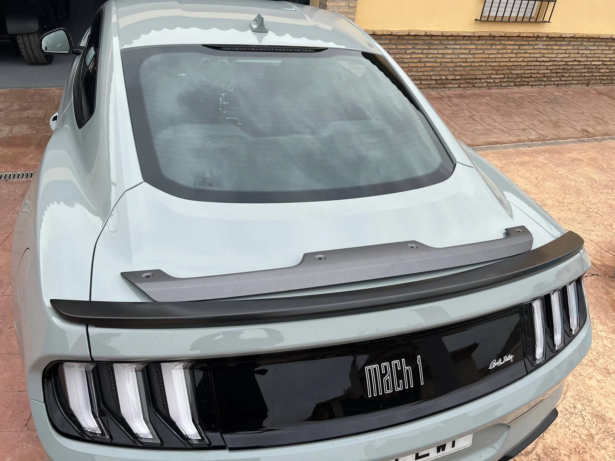

I just paint the rear spoiler in "J7" Magnetic Grey and it's too light the OEM Spoiler it's darker.
When you get a chance, you might want to use the taillight alignment mod thread on your LH taillight. It’s a common assembly error.
Can you send me a link? I don't find anything.
I wonder what the taillight alignment mod does. I have it too on both sides and thought it was actually the decklid what was misaligned. But the decklid seemed to be set the only way it could be, with no leeway for an adjustment.
On the other hand the taillights look to be fine.
