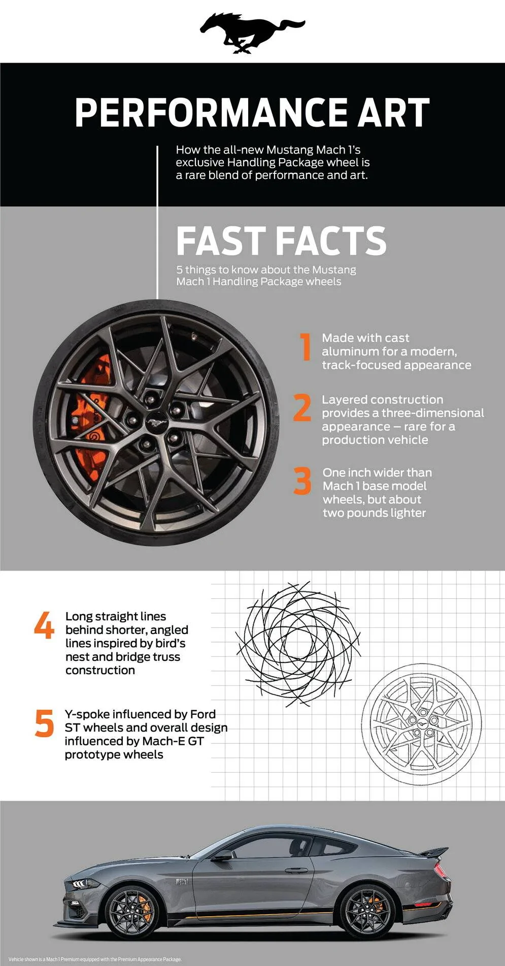

I know motortrend article said so, read it yesterday too and wondered, but they are most definitely not forged.
The official Ford infographic says they are cast aluminum, see below. Some clarification on the possible difference from official source would be welcome, though, so I asked in Levittown topic too.
The oem HP wheels are a forged cast aluminum wheel. You’re correct they are not a “forged” wheel like you see from the aftermarket but they are an improvement over a standard cast wheel. Where they fit on the spectrum between a cast and a true forged I can’t say.

@Atlas1 Do you mean something like "flow formed" which are sometimes called "flow forged"? That's more of a marketing misnomer. Imo there is no such thing as forged cast aluminum. It's either forged or cast. But there are lot more knowleadgable people around to clarify. Perhaps Ford Performance will answer on the difference or if there is any.

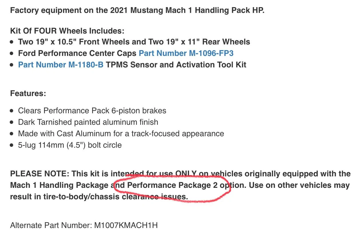

Compare oem PP2 wheels (10.5" and 11") with the FP PP2 wheels, they're very similar but with different colour, and their price is half as well (some 350 vs 650$ iirc). So it kinda reminds this situation as well with HP oem wheels just being terribly overpriced. But in this case the colour and look seems to be 100% identical from what I can tell.
FP even uses the same marketing language:
"Factory equipment on 2021 Mustang Mach 1 Handling Package" - clearly means it's the same as oem, doesn't it?
"Made with Cast Aluminum for a track-focused appearance" - same as on the infographic

So these will fit PP2?

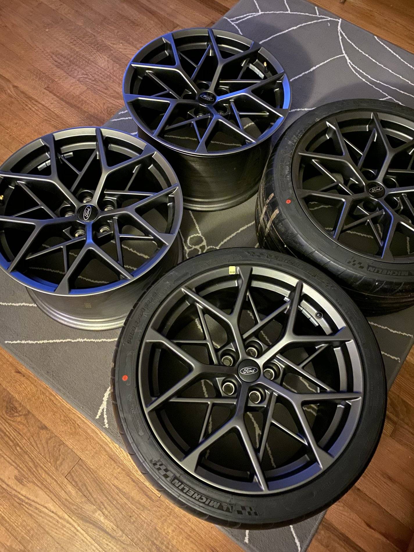

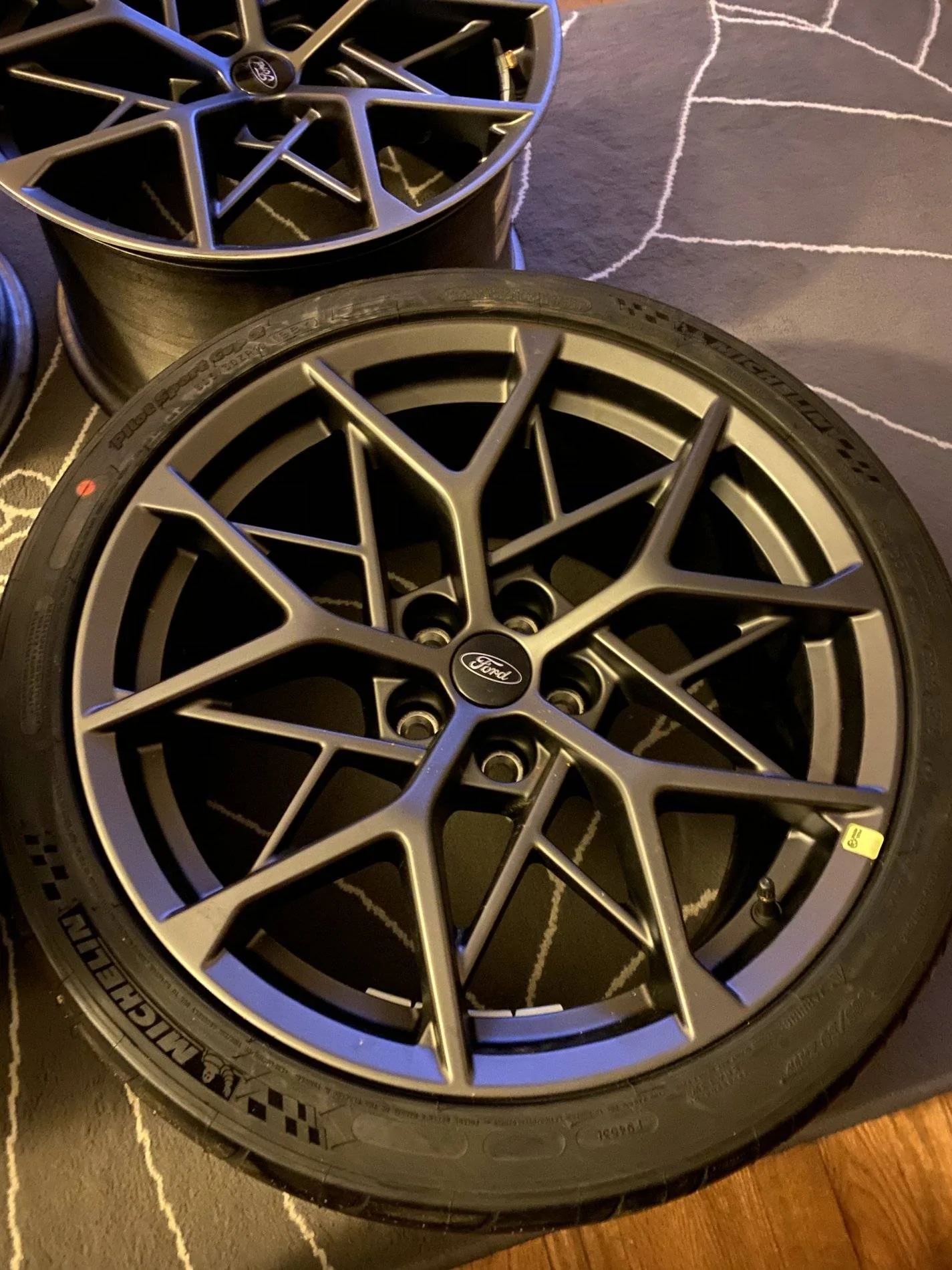

Thought you guys would like these. 2021 mustang Mach 1 wheels w/(handling package) These are function Prototypes. These are made in the US!
Things I know,
Front rim 19x10.5 24 mm
Weight est 33 lbs /Need to remove tire
Rear rim 19x11 et 52.5 mm
Weight 31 lbs
