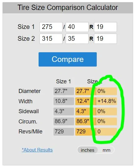

315/35 would be perfect, but there's no way I'm going to find those in the UK...
Indeed! I wonder why Ford opted for the lower profile for the HP.
But concerning the HP vs non-HP, the armchair physicist analysis says that unless you want to track your car more than drive it on the street (and while I cannot speak for UK roads, Czech roads are in general not in very good shape), you would suffer with HP more.
The reason is that by widening the tyre you proportionally increase the chances to catch something on the side of the tyre and you also increase the moment (torque) the tyre puts onto the steering (tramlining). Which both basically negates the advantage of the wider tyre, which is the larger contact surface. On the other hand, on an even surface, the larger contact area of the HP tyres will improve the stability and with HP spoilers (and a sufficient air speed) also the traction. So it is really pick you poison. :)
