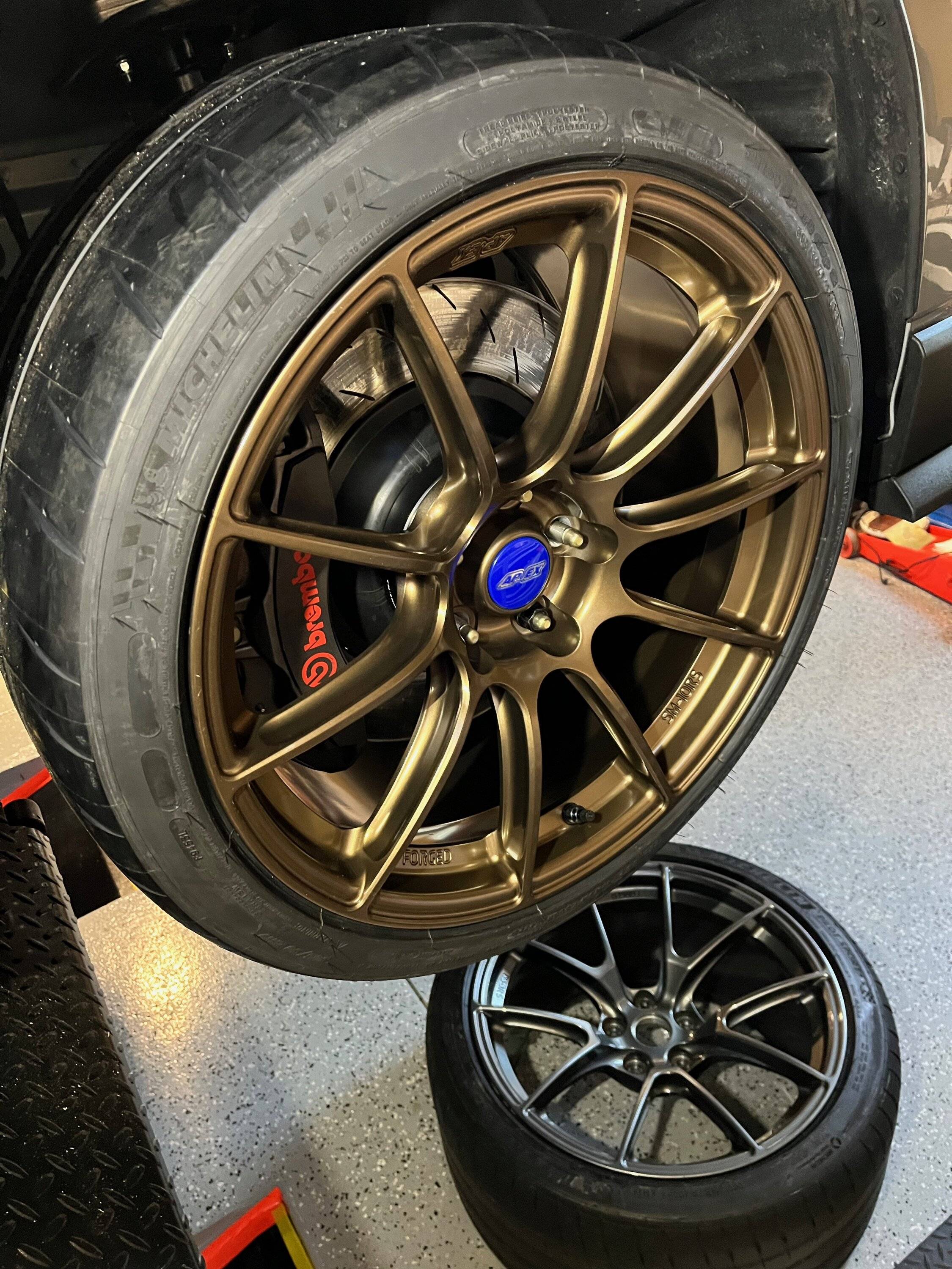

If there's one downside to Apex wheels it's that sometimes the tire does not seal. It may be just a Michelin thing but I've had it with the VS-5 wheel and Michelin PS4S with 3 out of 4 wheels and now only one (thankfully) of my SM-10s with new Michelin Cup2 tires (no road use at all). I'm almost certain it's the knurling on the bead surface of the rim. The fix is to unseat the tire and apply some black sticky goop, to the bead surface, which seals up the leak (It leaks out of the side of the tire by the bead if you put the wheel under water).
The VS-5 had a very coarse, aggressive knurl. The SM-10 is much smoother but evidently, not quite enough for some tires.

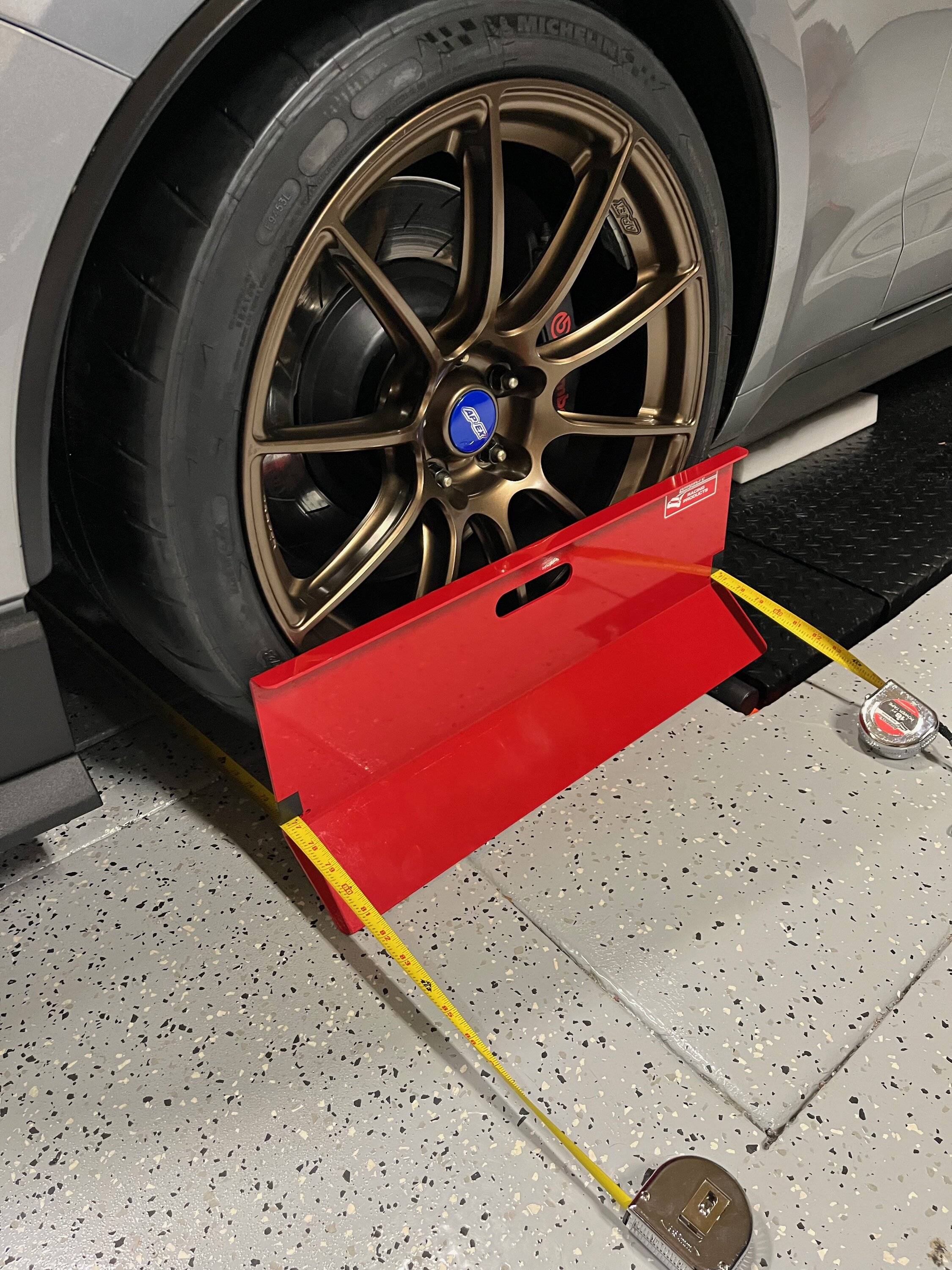

(wheel picture is just a demo, no spacer on it)
