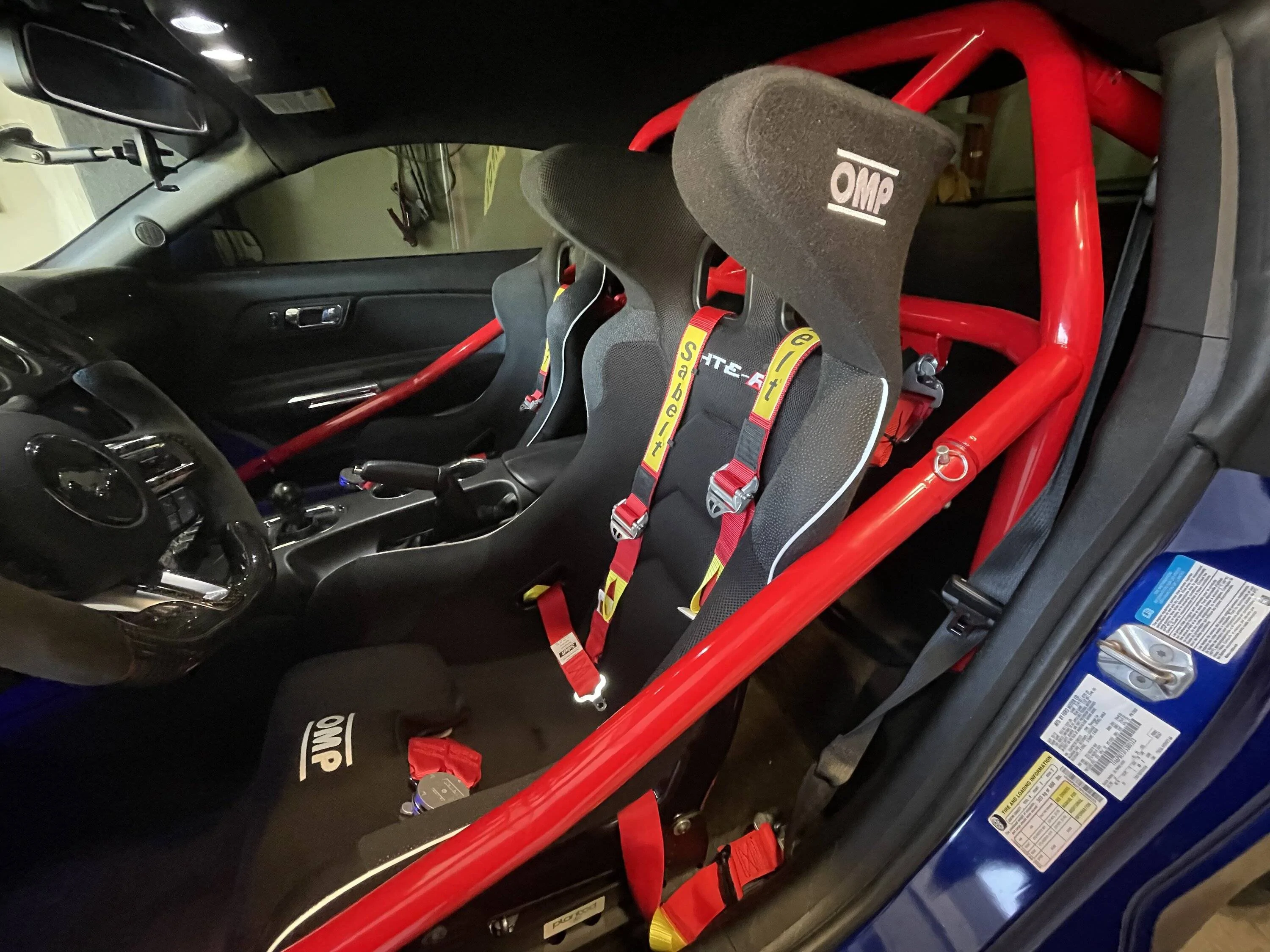

It's a Watson roll bar and a Safecraft harness with Ford Performance branding. Watson also sells a roll bar harness attachment kit for the lap belts. The shoulder belts attach to the roll bar.

The bracket just goes under the seat and you use the original T50s to mount the seat back in and you clip the harness to those points and use pins for safety in the clips

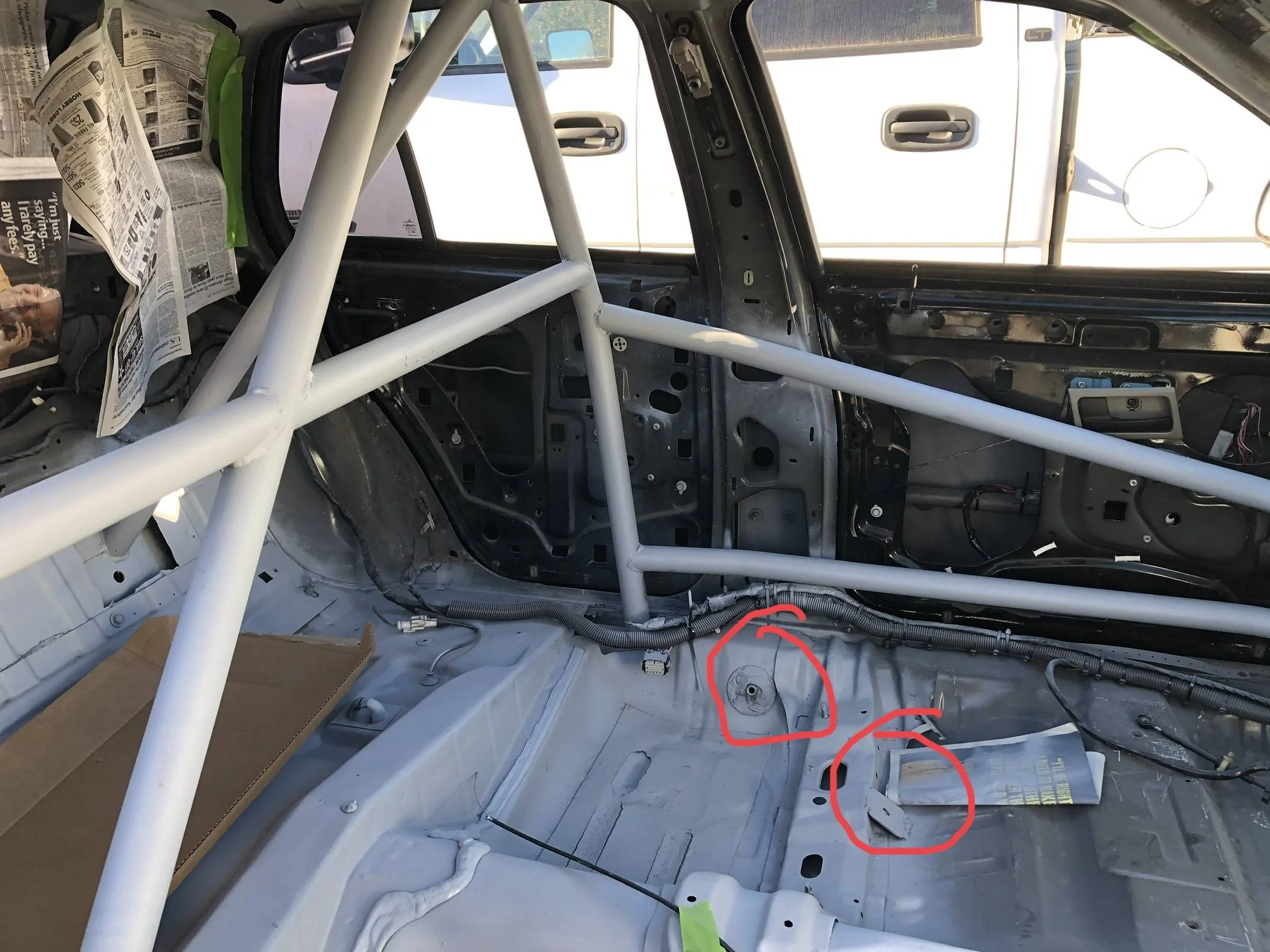

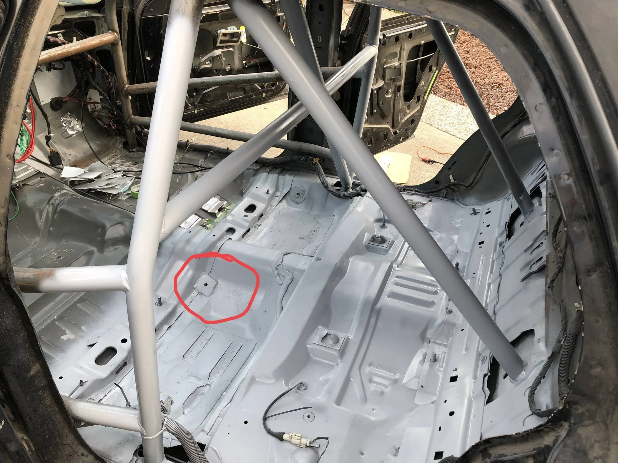

So if I’m understanding the above conversation correctly, and feel free to ignore me or correct me if I’m wrong, we’re talking about a 5/6 point added to a Mustang.
So full disclosure, photos below are not a Mustang, but principle is the same. For a 5 point, you want the mount behind the belt line for the lap belt. We use 1/4ā€ steel plate drilled and tapped for an eye bolt.
It’s also important to have the lap belts at a correct angle. Which is why the Watson is cool, cause it uses the factory mount points.
