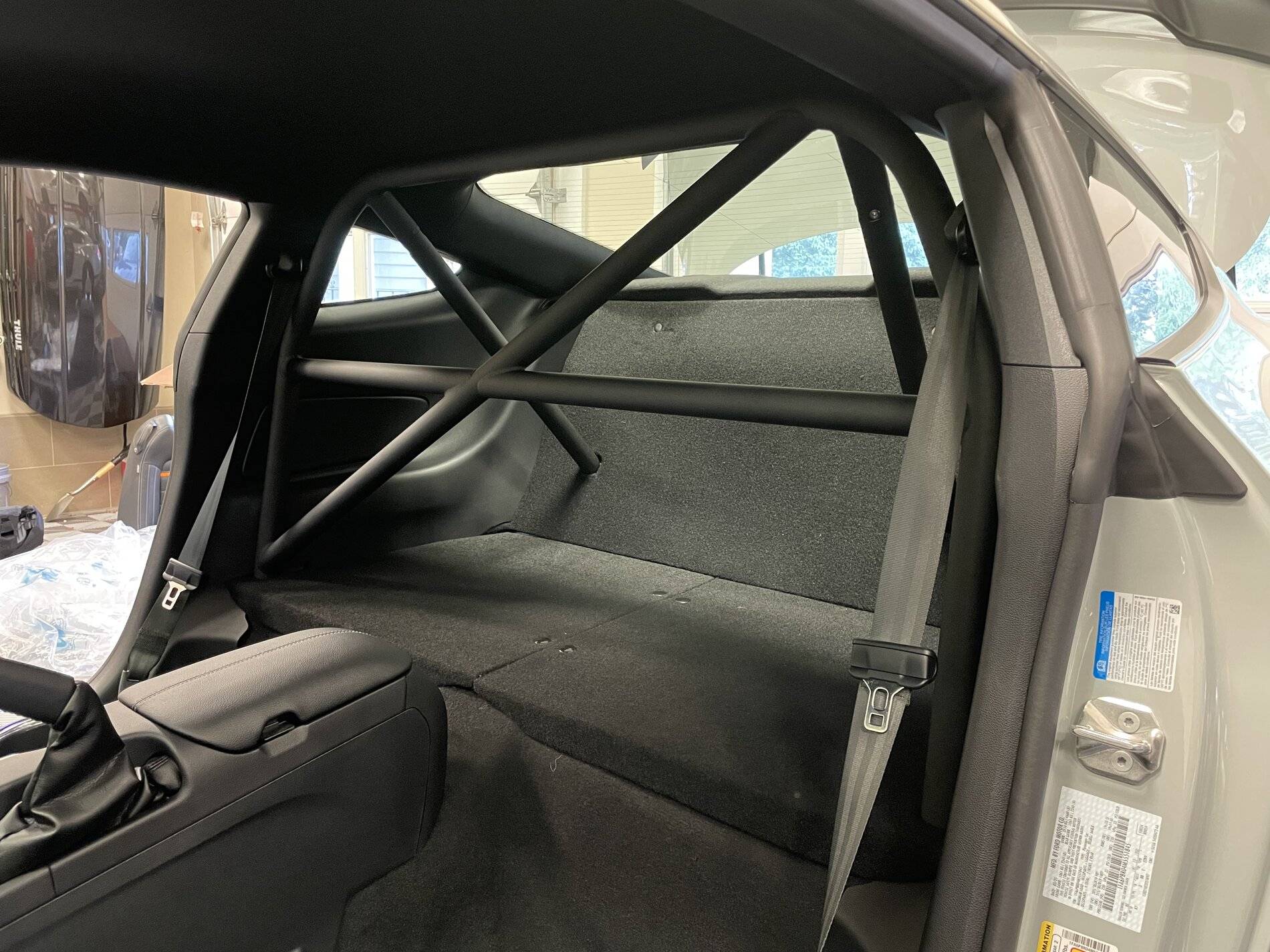

Hi All - just picked up my Mach 1 to build as a track car for my son and I to use. It’s augmenting (and potentially replacing) my 2016 GT3RS, which I’m concerned is a bit too much car for him to learn on, and with damage costs being too high if he makes a mistake.
It seems like most people are buying these cars as daily drivers or collectors items. Is anyone else planning on using one for the track?
My car is one I found locally at a dealer, picked it up on Tuesday - M1 Premium, elite package, handling package, jet-fighter grey.
Mods on the way:
- Watson rollbar (chromoly version)
- Sparco seats
- Brey Krause seat mounts
- DSC Suspension controller
- Forgeline GS1R wheels with another set of Cup 2s
- Garman Catalyst lap timer

Just finished up the Watson roll bar and rear seat delete install. Next are seats and harnesses, alignment and brake fluid flush. Soon it’s ready to go.
