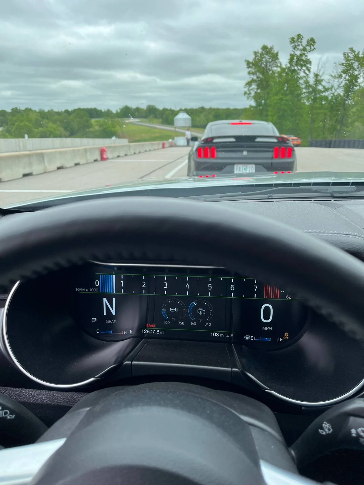

First long road trip with real street tires. Now 880 miles into what will be a bit over 2,000 mile round trip. Running Michelin PS4S in stock sizes and I have to say, they are excellent. Probably not the "best" street tire but really good on the freeway. No tramlining, pretty good in light rain and overall track really nice and straight. Cup2 are a huge compromise in comparison.
I'm sure you guys with automatics are getting better freeway MPG but with manual trans running 2200-2400 rpm in 6th gear I'm getting real 21 -22.0 MPG, measured by gas pump-to-pump. The trip computer reads 2 MPG high. I can live with that.
The other thing, though I'm on stiffer springs, the car is such a good freeway cruiser. Comfortable, quiet, smooth enough, but can be a bit rough on multiple expansion joints or bad asphalt.

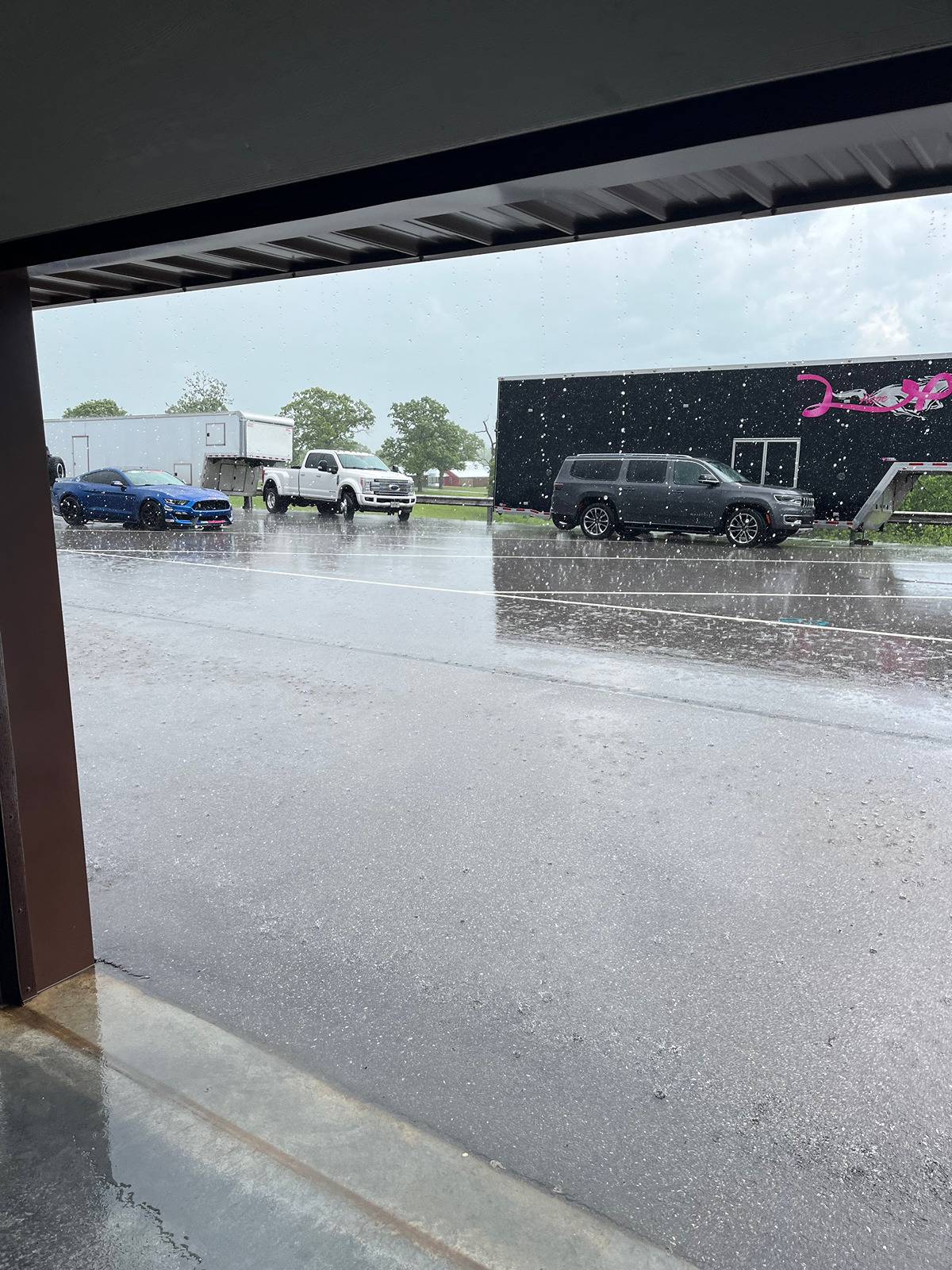

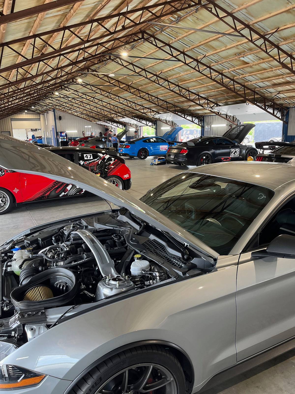

Great day at Ozarks track. Met up with DerKlink (Marc) with his '21 Mach 1. Weather was mostly good except for a late afternoon shower.
For those who have never been the Ozarks track is really nice, super scenic, great layout and very technical. If you don't like blind corners this track is NOT for you. However once you learn the lay-out it has a great rhythm and flow. Some really fast sections, a few slow corners and lots of elevation change (big time). Full street set up alignment wise seems to be just fine there. Not really that hard on brakes and not too hard on tires either (but of course very driver dependent).

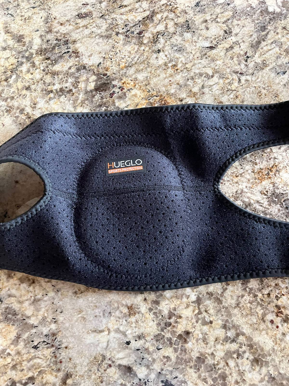

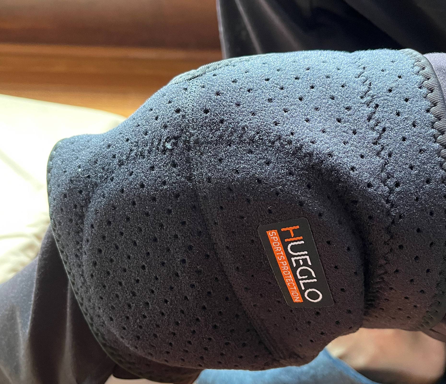

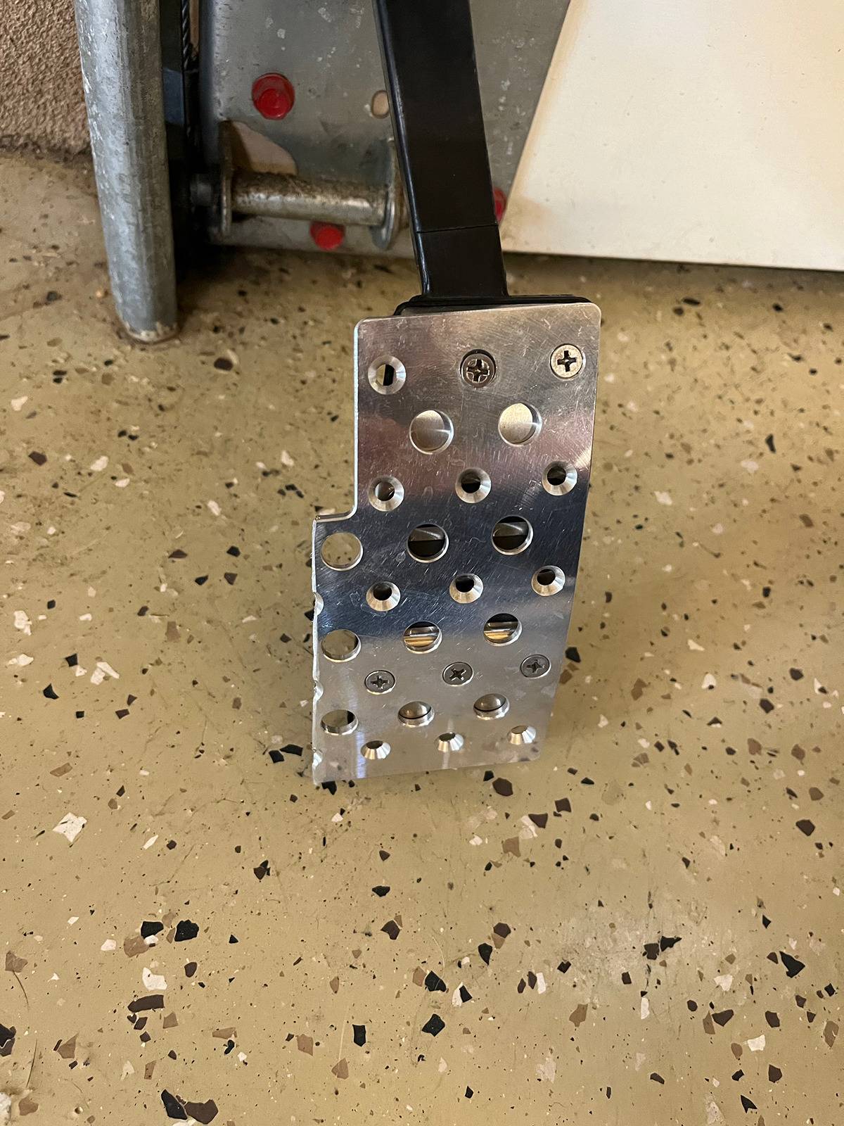

For those of you with standard heated and cooled seats, you probably know that they are not optimal for track use. I think the standard seats are one of the most comfortable seats around compared to many other cars I've owned. Just got back from 2,600 mile road trip and they were great, no sore back, temp is always right using either low vent or low heat, really a great overall set.
Okay, so the problem at the track is they are NOT very supportive at all and for many of us you will tend to use your left lateral knee for support, in corners against the door or whatever interior body panel on the left side, to keep your body positioned. Consequently at the end of a track weekend your left knee will either be bruised, red or just generally uncomfortable sometimes with an abrasion. The way to avoid this is to use a knee pad turned sideways on the left knee. See photos below. Absolute cure and solution for this problem. The better you tires, the higher the G-loads the more you need this. Works for me, it's inexpensive and makes your track outing much more comfortable.

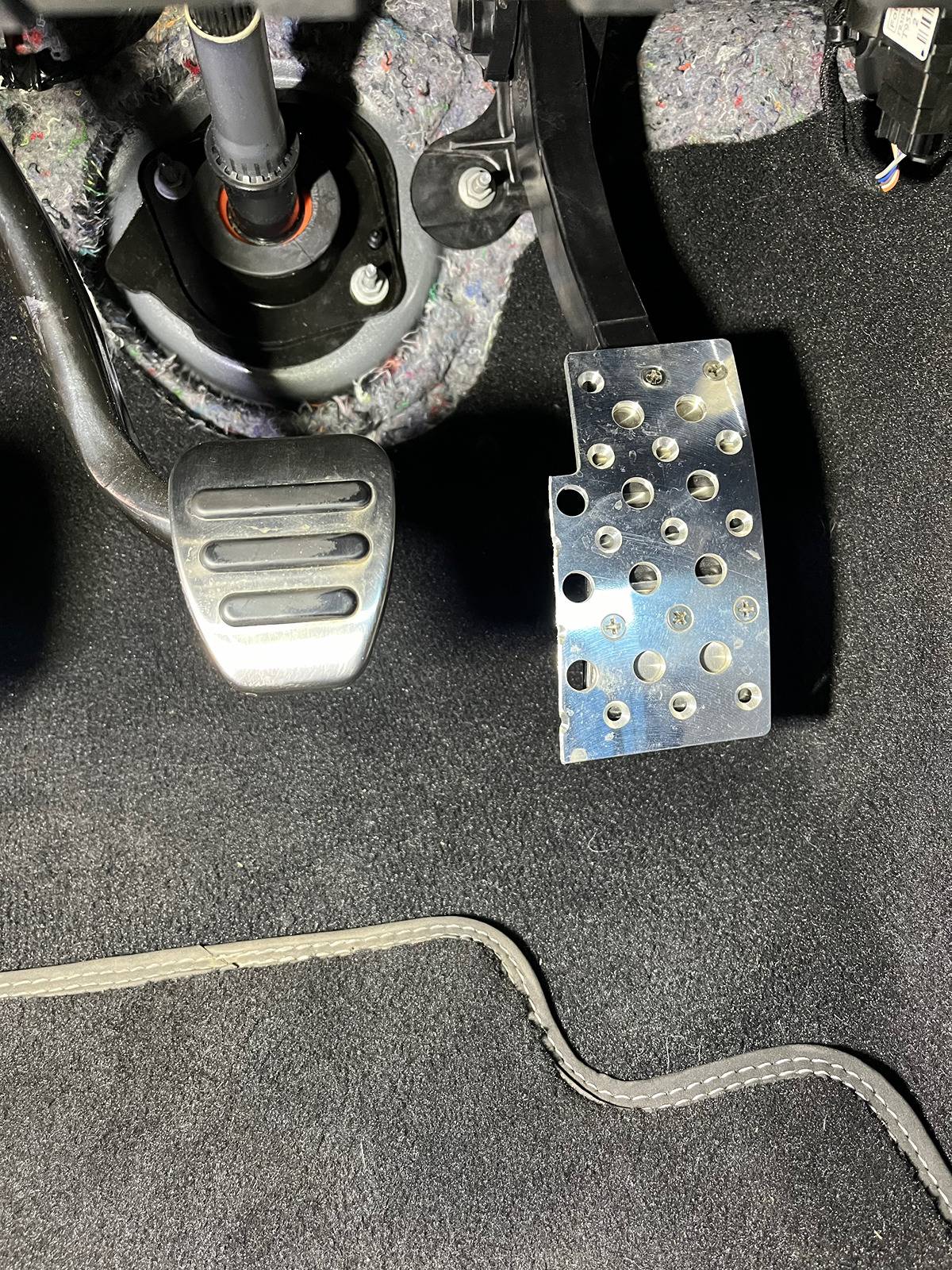

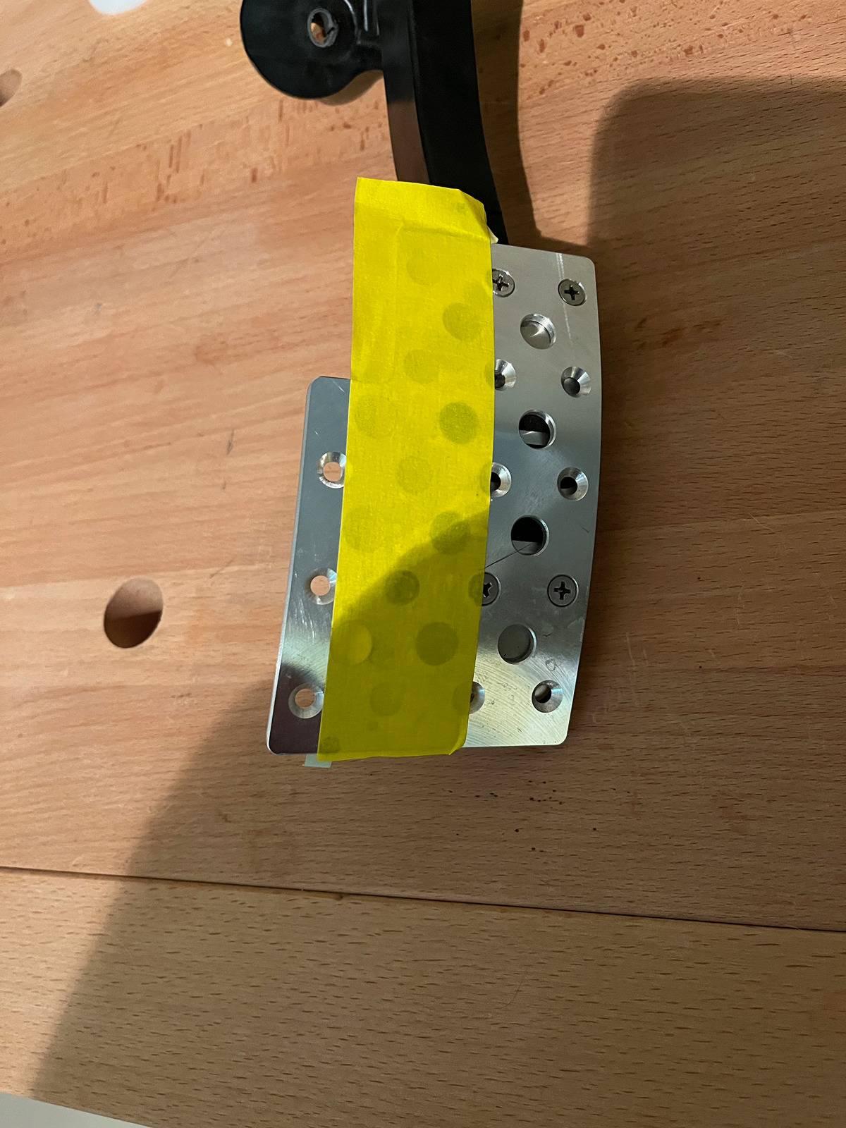

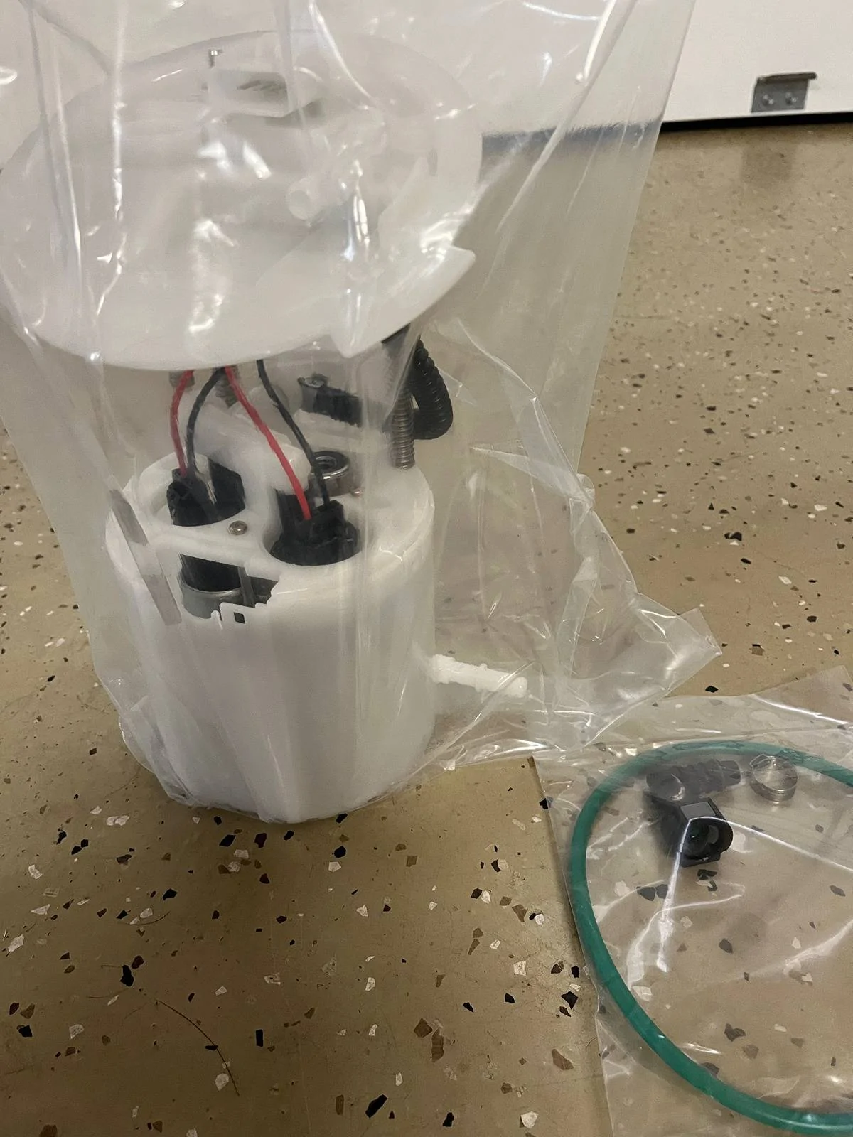

I'm always looking for ways to incrementally improve my car to better fit me and my driving style. Had noted both on telemetry last Fall and sometimes on my own when driving on track when applying high brake pressure for 1.25g+ braking sometimes my foot would also, at the same time, hit the accelerator. If you depress the accelerator too much the car will cut power to the engine, but either way it's not ideal. Consequently, trimmed off a little bit of my widened throttle pedal and will see if that does the trick.
Will also be changing some items on my front-end to make it a bit quieter on the street and have a fuel system upgrade coming too.

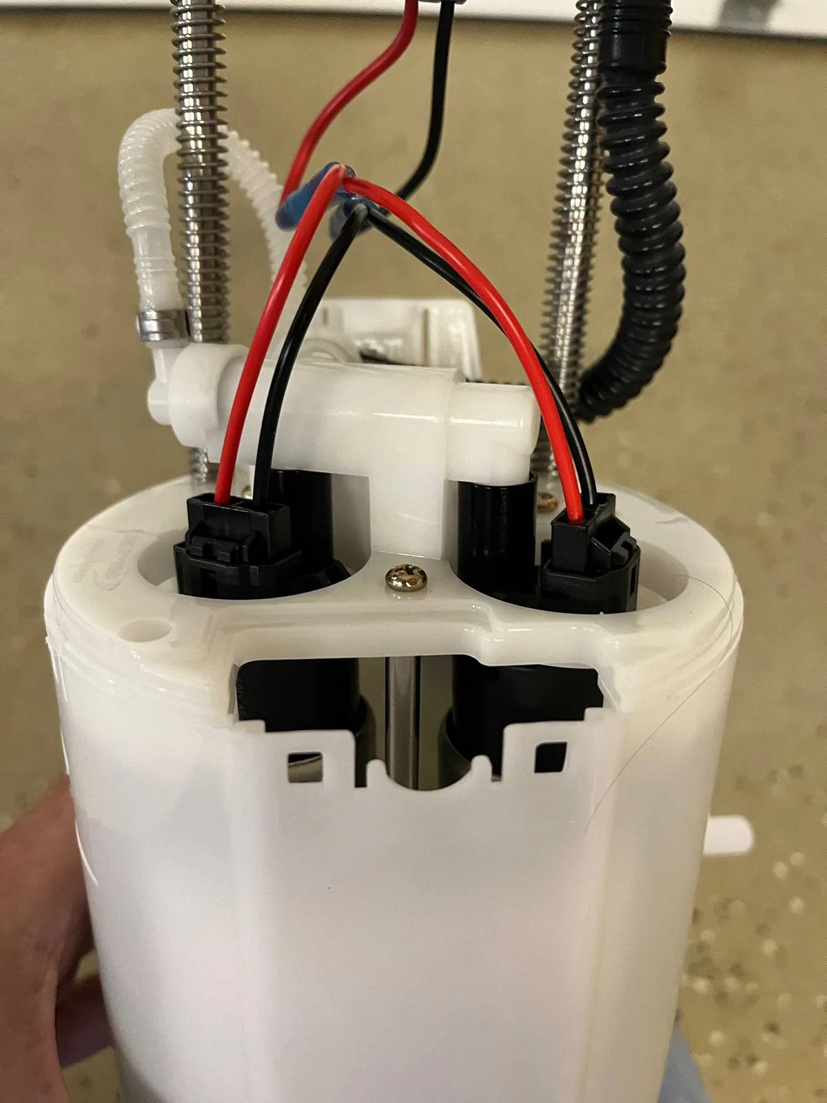

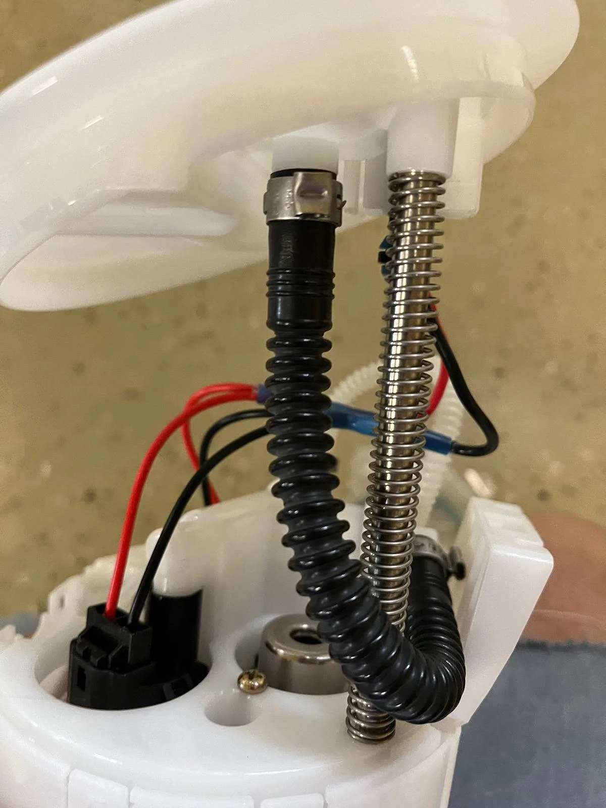

Going to be a few days before I install this as I want to run down my fuel level, a lot. Still need to reassemble front end and waiting for coil-spring isolators to come from Energy suspensions. Then the fuel pump should go in. Hoping I will then be able to run track with fuel level below 1/2 and not have starvation issues on those left hand sweepers.

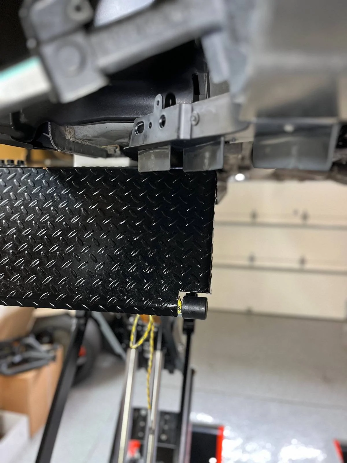

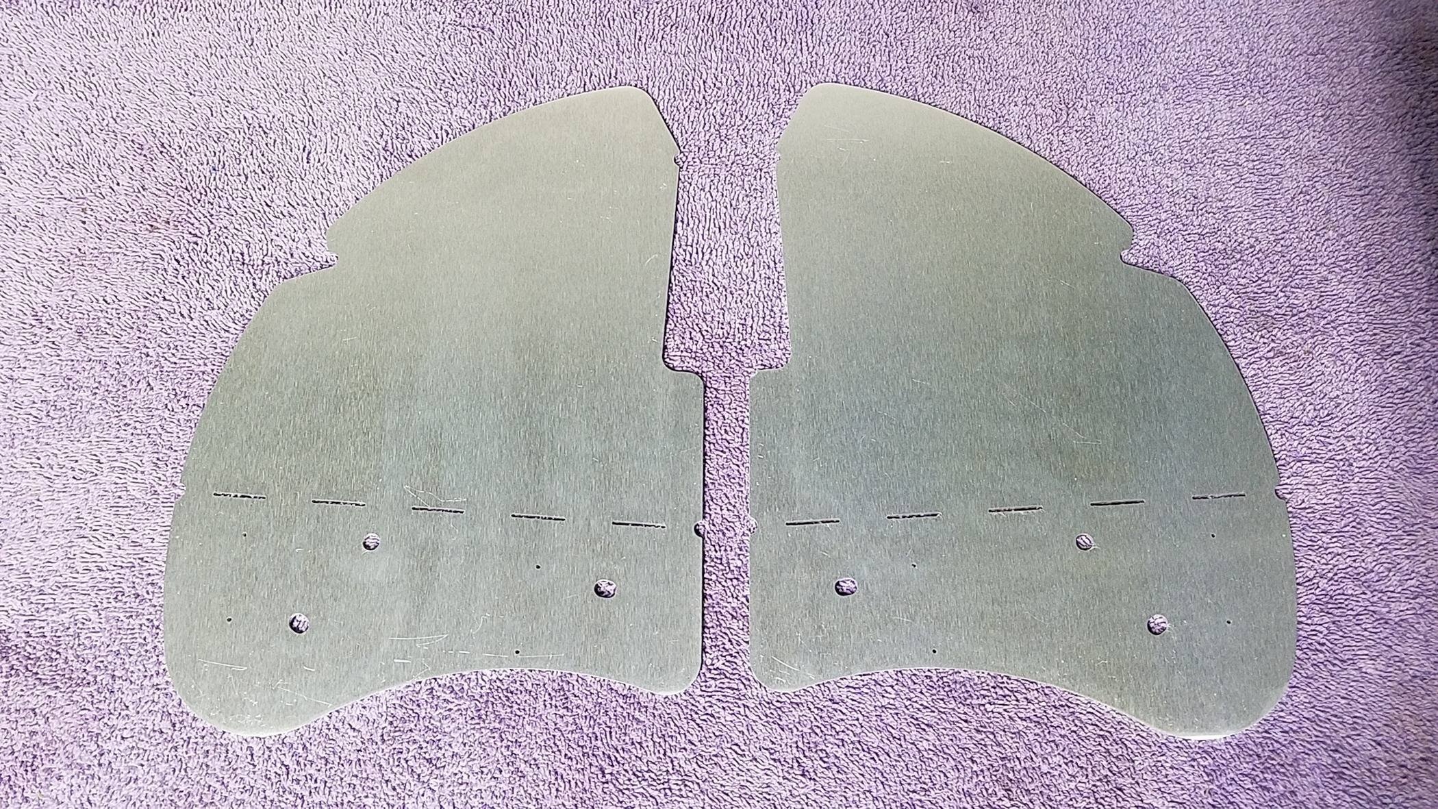

As per another post on this forum, I've added the aero-strakes from the S650 DH. Requires a few small modifications but overall an easy install. The aero benefit probably really small but some of the tracks I run, the speeds will be high enough for them to do a little work,

4) Fuel starvation. Never a problem again since changing to KPM fuel module, can run well into reserve range with no evidence of fuel starvation. The main problem with becoming a more proficient driver over time is your gas mileage keeps going down. At VIR I'm using 7-8 gallons per 20-25 minute session. That means I have to tank up after every session now. I know, Boo Hoo, but I remember the days when I could easily run 2 sessions, sometimes 3 depending on the track. VIR is pretty fast, average speeds are in the mid 90 mph and the car just guzzles gas. I know the GT500s drink gas even more prodigiously than mine and that's just normal life for them.
