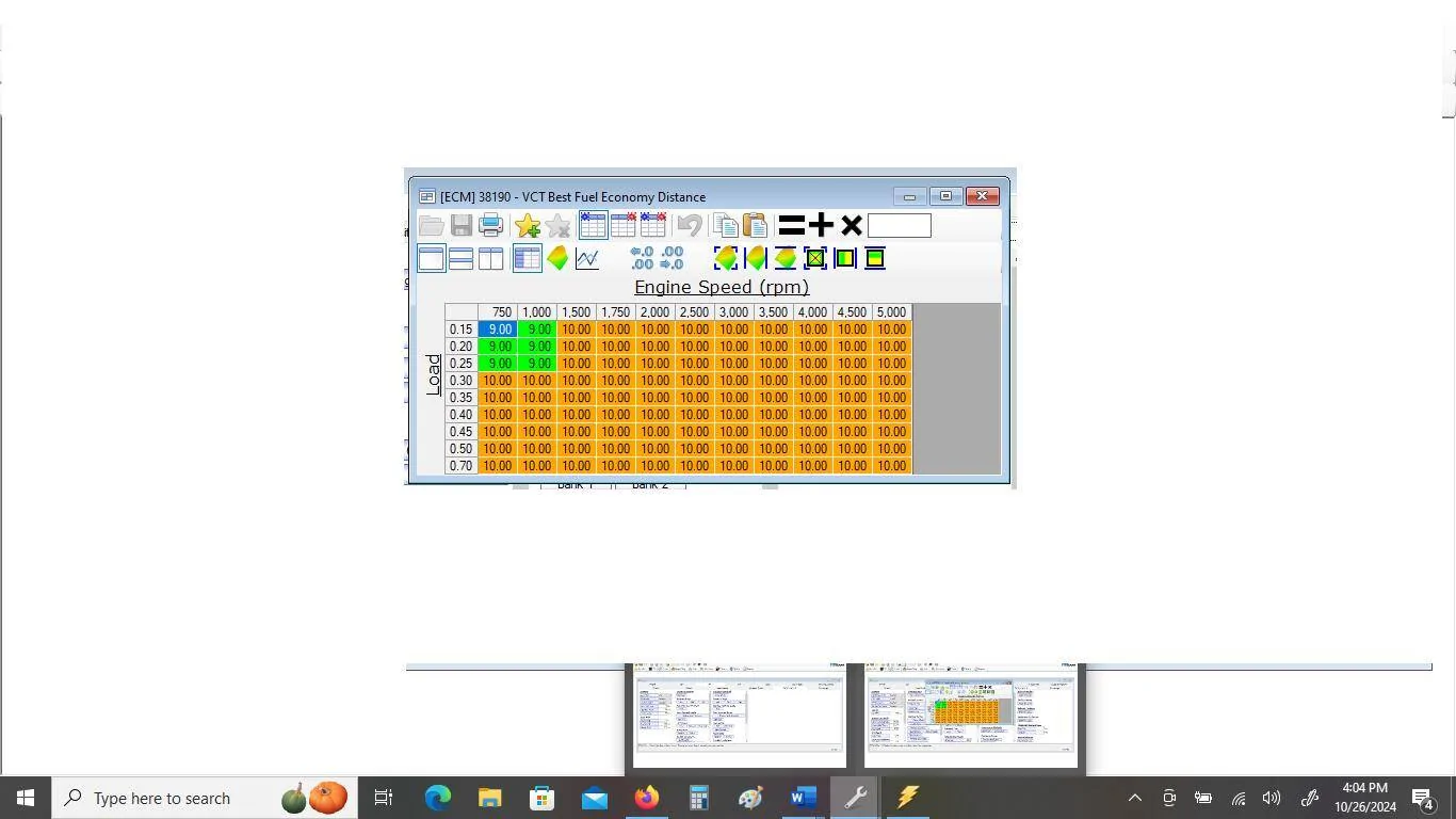

This is one reason I don't like Lund tunes. This is how they run the cams at idle and part throttle.
VERY LAZY and causes drivability problems.
I never promised Lund or anyone else I'd never post this. This tune came from a car Lund did not lock.
How old is that tune ?

New enough. I have others that are newer and look the same that I promised not to share.
Geez ... that hasn't changed since 2011 then. So much for innovators ha-ha.

I'll say this. I have N/A, PD, centri, and upgraded cam tunes from the infamous Lund. All have the same part throttle cam timing.
