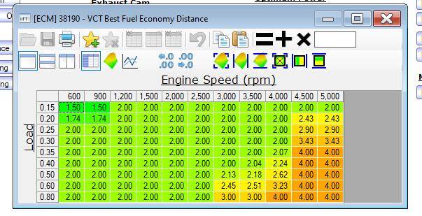

This is one reason I don't like Lund tunes. This is how they run the cams at idle and part throttle.
VERY LAZY and causes drivability problems.
I never promised Lund or anyone else I'd never post this. This tune came from a car Lund did not lock.
Dont forget the 70% throttle input to activate the OP table to actually get the cams to move. It is wild. I bet that feels very delayed
For comparison this is mine.
