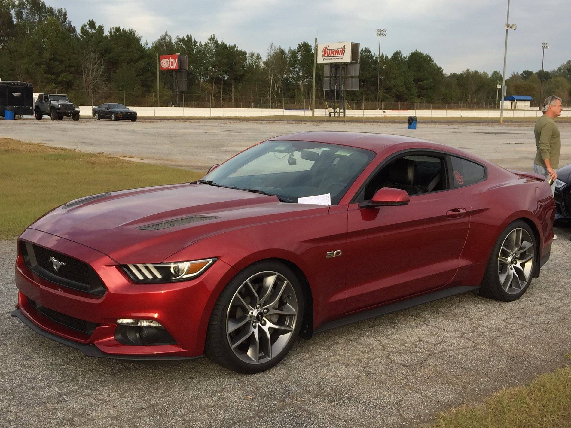

Ford performance street, no other suspension changes.

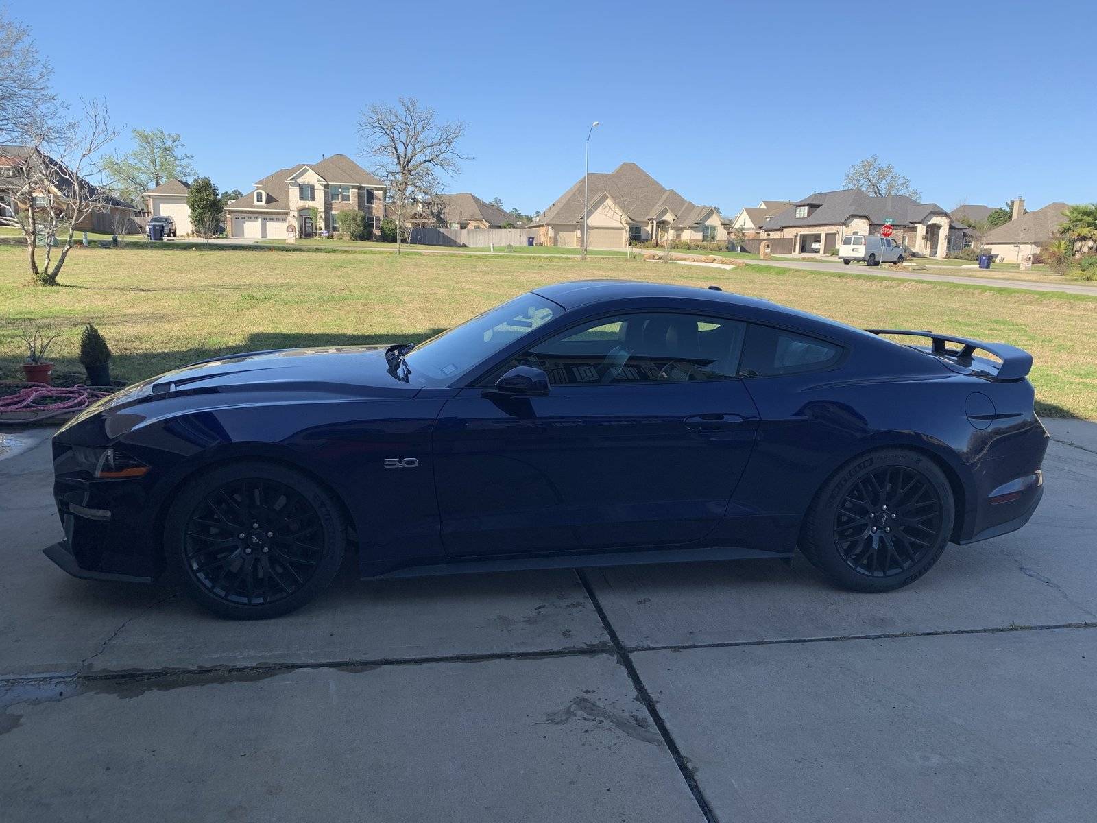

I did the spacers in both the front and back. The drop was about 5/8 in front and about 1/2 in back after kit. I also did the camber plates with the progressives and the actives. No regrets at all. Both ride quality and handling improved. Most of the issues I have seen people report are from installation problems. I had a guy that is very experienced in suspension alignment etc do the work at the dealer and have had no problems. I live in Houston which has roads that look like they have been cluster bombed and my neighborhood has more speed bumps than one would think is possible and I have not had any issues.

No weird noises other than the engine. If you hit a large bump you will hear a thump but it sounds like a normal sound to me. I have no complaints and glad I did it. The performance pack non magneride suspension is garbage and ford should be embarrassed. I will get a picture later. Been raining so its dirty....
