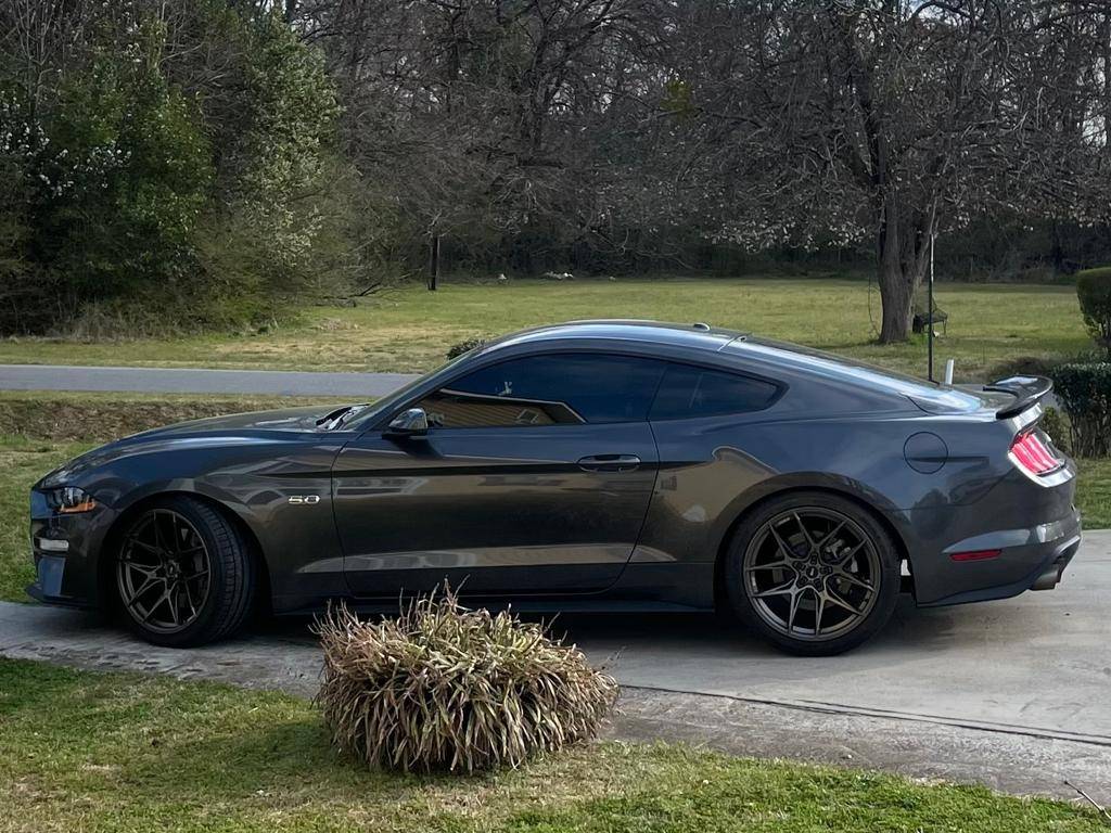

You could use a taller series tire to get some of that ride height back, but If your looking at springs most of steeda spring kits are .5" drop or less.

So to recap , this is the Steeda Minimum drop kit?
Im doing something soon, sport lines are too low for my taste( how I got the car)
Are camber plates needed or can you get away with the offset bolts?
Yes it is the minimum drop springs & other than the stop the hop starter kit, no camber plates or bolts were added yet. Figured Id add those when I replace the struts/shocks. Probably go back to BMR for the rest of my parts or try a different company. I like how BMR atleast sends instructions in the box & update them with current years.

Also although I did lose wheel gap, ride height stayed the same due to using a bigger series tire as stated above. Was gonna go with 305/30-20 but ended up going with 305/35-20 & 285/35-20. Wanted to keep a comfortable drive.
cool
Interested to see how it looks once on the ground
I just fixed/got new tires/wheels, see above reply. And looking at fine tuning my setup
