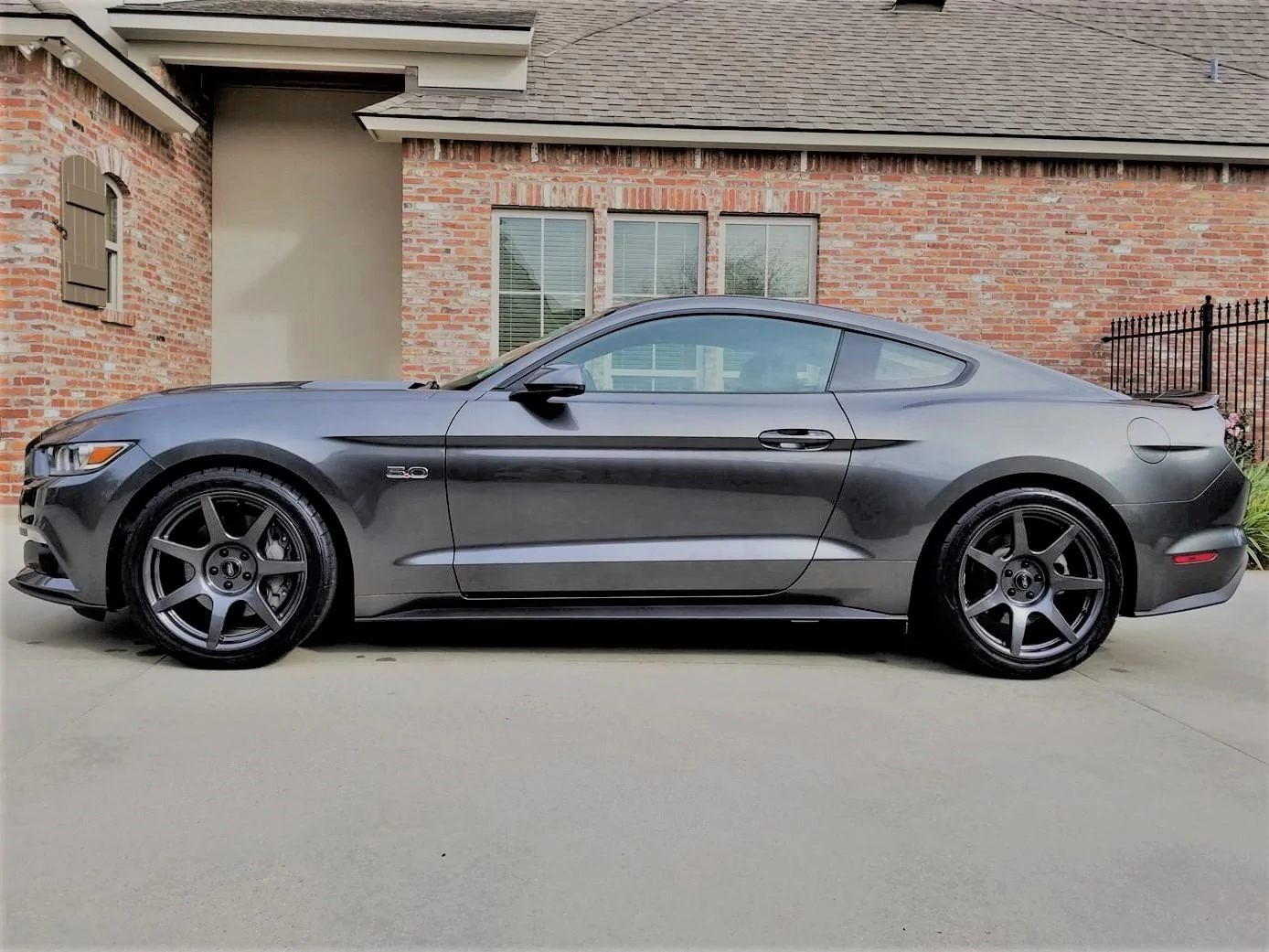

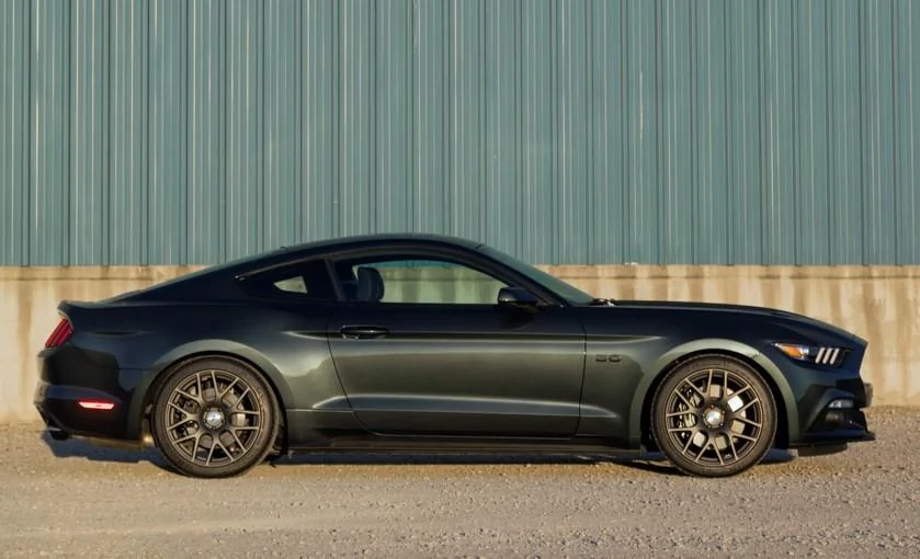

I came across this picture (bottom) of the SP763 spring set up. I really like the look. Rear 1/2"/Front 7/8" drop. My present tire set up is 305/35/19 rear and 285/35/19 front. My rear tire is 1/2" taller than the front. I think the additional rear height will close the rear gap well. My present set up top picture.

Thanks for all the posts. Went with the SP763 springs and PP dampers. Was a hard decision between steeda and BMR.
Good choice. I've had mine on almost 2 years now and may still be my favorite overall mod. I love the look. Slightly lower with a nearly level stance. Nice ride and good handling too.
