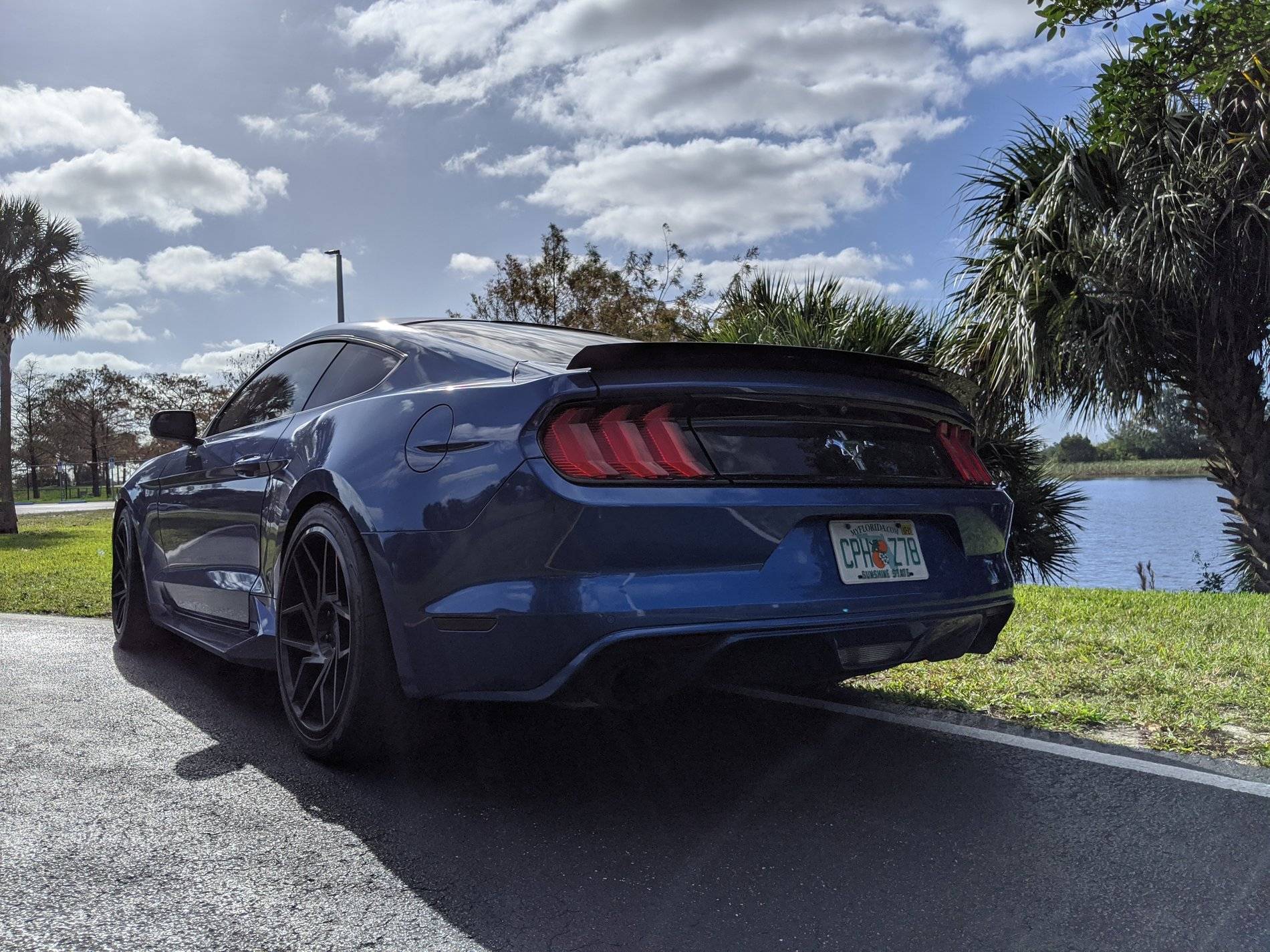

1) Depends on the setup you go with and what aspect of ride quality you are looking for. My Steeda setup is definitely firmer than stock and not as cushy, but there is still great ride quality because it is predictable and controllable.
2) Coil overs are not necessary for that, a good set of shocks, struts, and springs should serve you well for lowering and maintaining good quality. The Steeda ProActives / Koni Actives are supposed to be comfortable and paired with a progressive spring would probably be much better than stock while still being cushy enough - I always recommend a linear spring (Sport Linears in my case) based on the terrible experience I had with Sportlines which were progressive. Two more that are very popular are the FRPP Track and the newer Bilstein HD6.
3) Steeda has options that cover the spectrum of drops, I feel like the 1" mark is perfect for our cars and that's what the Sport Linears deliver. BMRs don't drop quite as much but get a lot of love as well, FRPP aren't recommended quite often here for the springs (yes for the Track Shocks/Struts). Eibach...avoid Sportlines.
4) Could probably do Sportlines if you want the low life, but stick with 1" or less drop to avoid having to worry about scraping around town.
This is a shot of mine from a couple weeks ago to show the drop. This actually has a 1/8 spacer on the rear to lift a bit due to my speakers.

That looks fabulous.
The ride quality I'm looking for is something similar to stock, just a little lower to close up the gap.
If I do springs, do I need to do shocks/struct as well, or is it more of, since I'm already in there, go ahead upgrade these as well type of thing?
Good to know about the sportlines.
I don't need the "low life", just need to get down some.

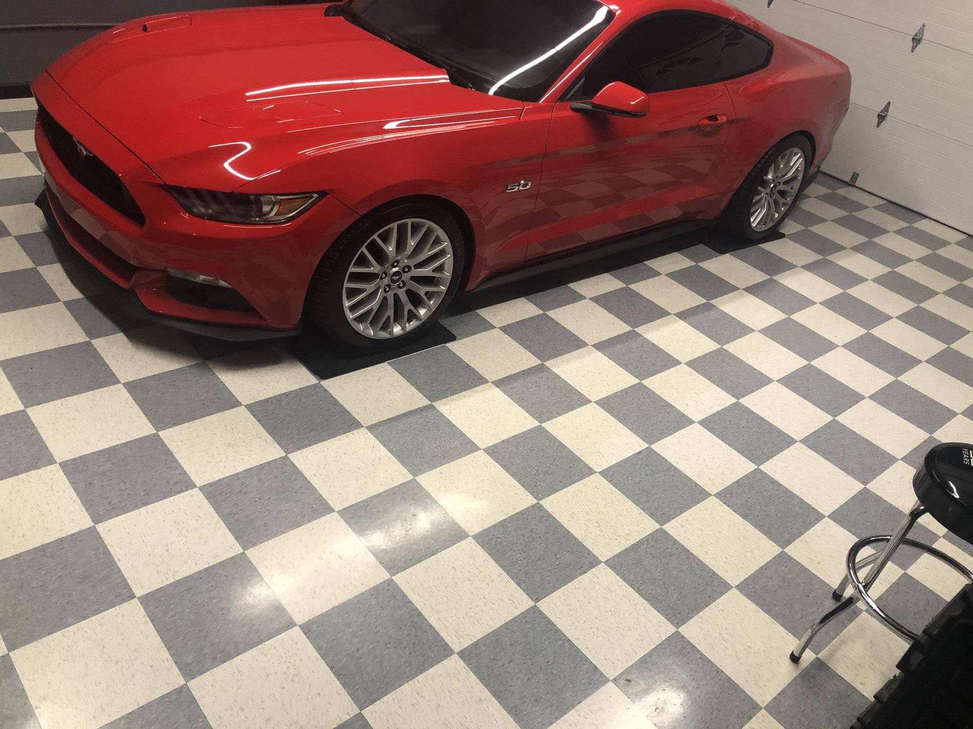

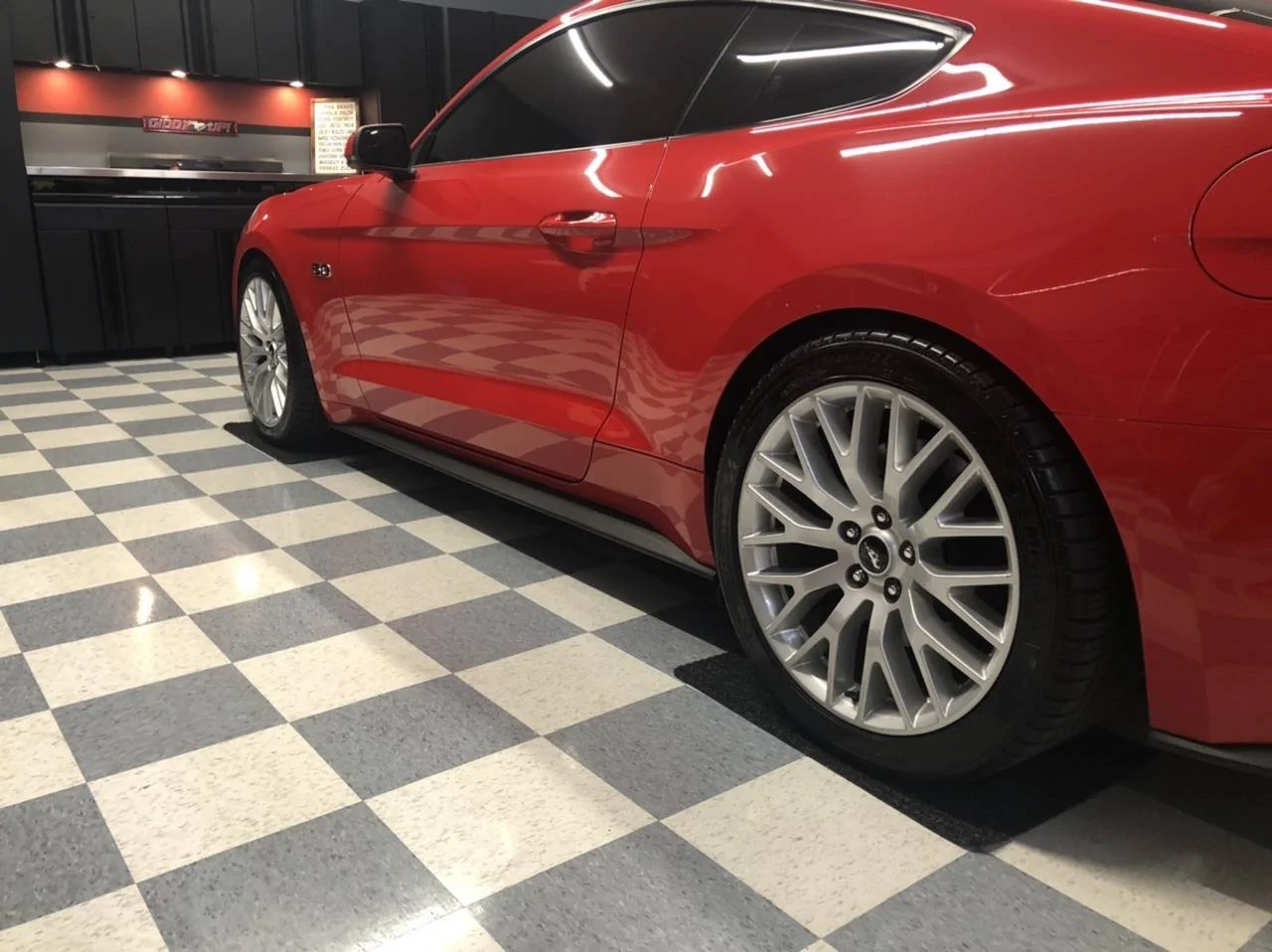

Eibach prokit on mine. Just spring and stock shocks. Ride is maybe a touch firmer but still really comfy.
Looks very nice! And so does the floor. Actually, I'm pretty jealous of the floor. And thanks for the info.
