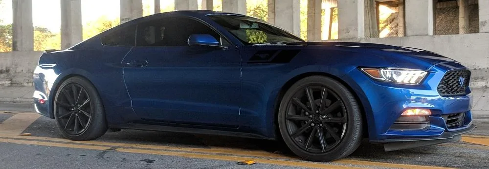

These are the Steeda Sport Linears with a 1/4" spacer in the rear (I've got a box with 2 subs and the spare wheel).
Ride isn't harsh at all, I prefer it over the progressive Sportlines I had before.

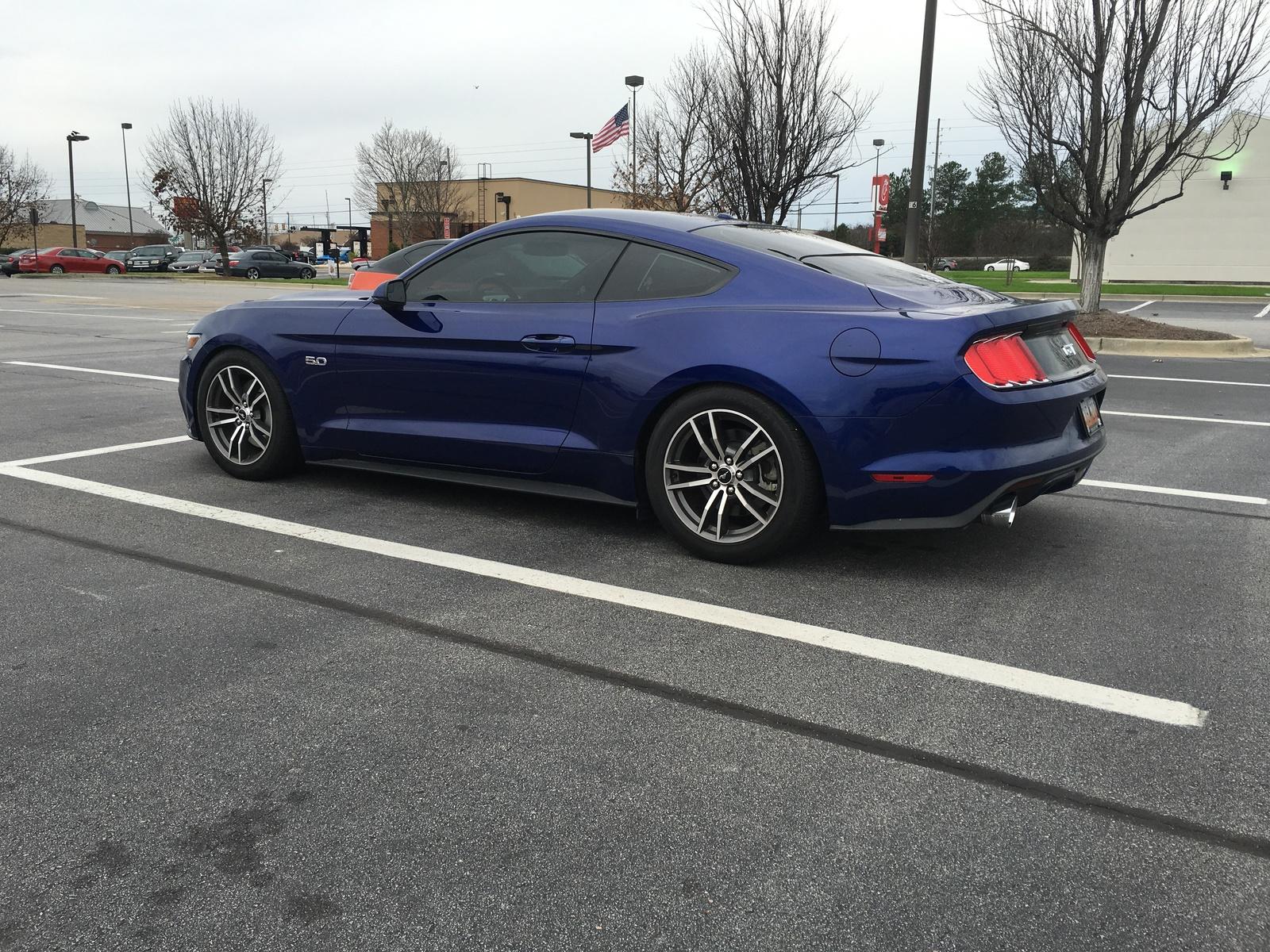

I don't have the minimal springs but I do have the performance springs (SP080R)... I believe they are 1.1 to 1.2 in the front and I think .5 in the rear. I daily drive my car and I've been happy with them. Pic attached so you can see how the car sits.
Thank you for the post. The SP763 springs should be very close to yours. 0.5" rear and 7/8" front. Your picture should be a good representation of what my stance should look like. Are your rims 20's?
