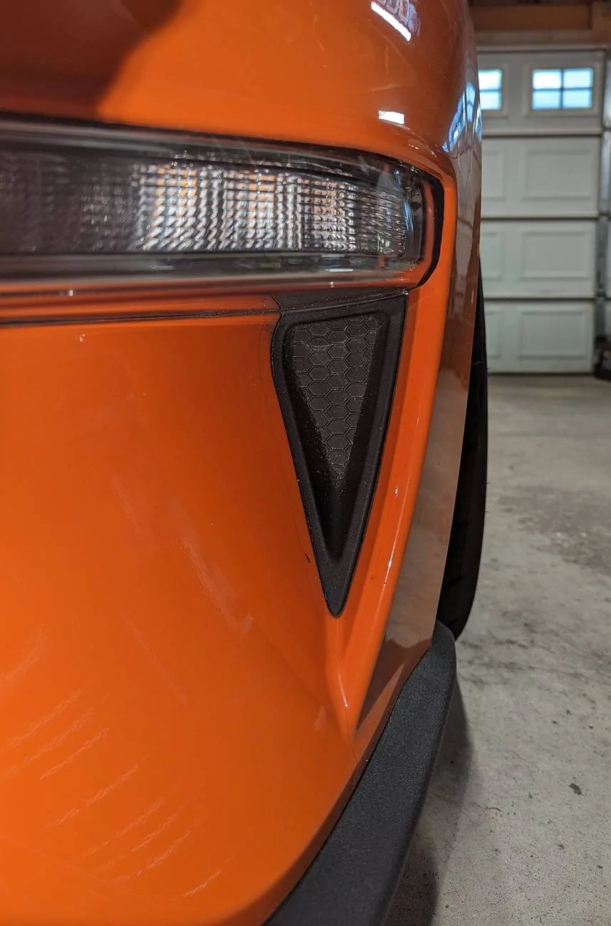

Looks like the roush stage 3 vents and the gt350 ones kinda combined. Had to go look at my PP1. It vents into the wheel well but there’s no opening under the fog light area. Just a solid honeycomb.

So are those air curtains with factory 19" wheels blocked off ?
With my 18" wheels they are open on my '17 GT.
What ? Nobody with 15-23 Mustangs with 19" wheel can go see if they're blocked ?

For all your 15-17 GT air curtain needs ( and more ).
18/19/20 inch wheel packages or PP the curtains were not blocked.

Pretty sure my eco with the skinny 19 was open. Gt Pp1 is closed.
Correct. Eco open, GT closed.
I just replaced mine with the Eco ones. Only half the cells are open, but they all feed the channel exiting the fender.
