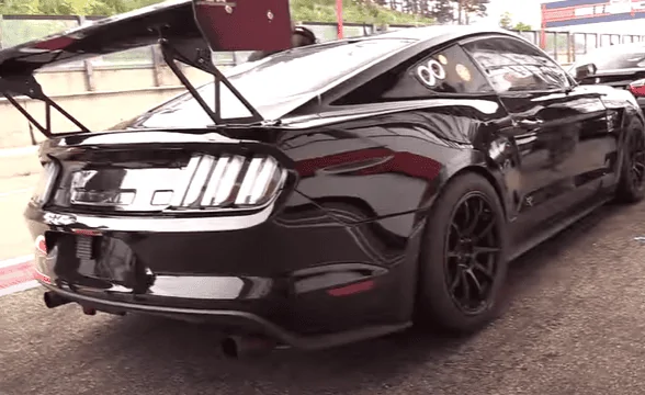

I recently saw a video of a European mustang at Monza (HPDE type event) and the car had the rear lower valance removed or at least cut away. That's what gave me the idea.
I know the Versus diffuser would definitely generate some downforce but I was curious if I could take a Dremel to my lower valance for free and potentially get rid of some drag

I found the video. Here's the link and a picture of what I'm rambling on about

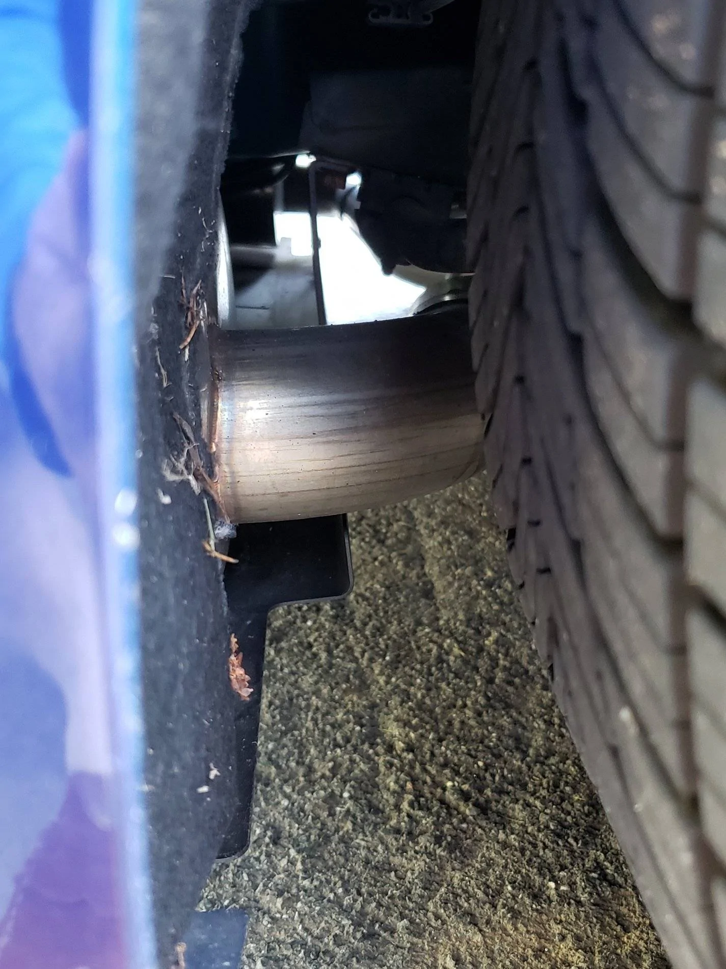

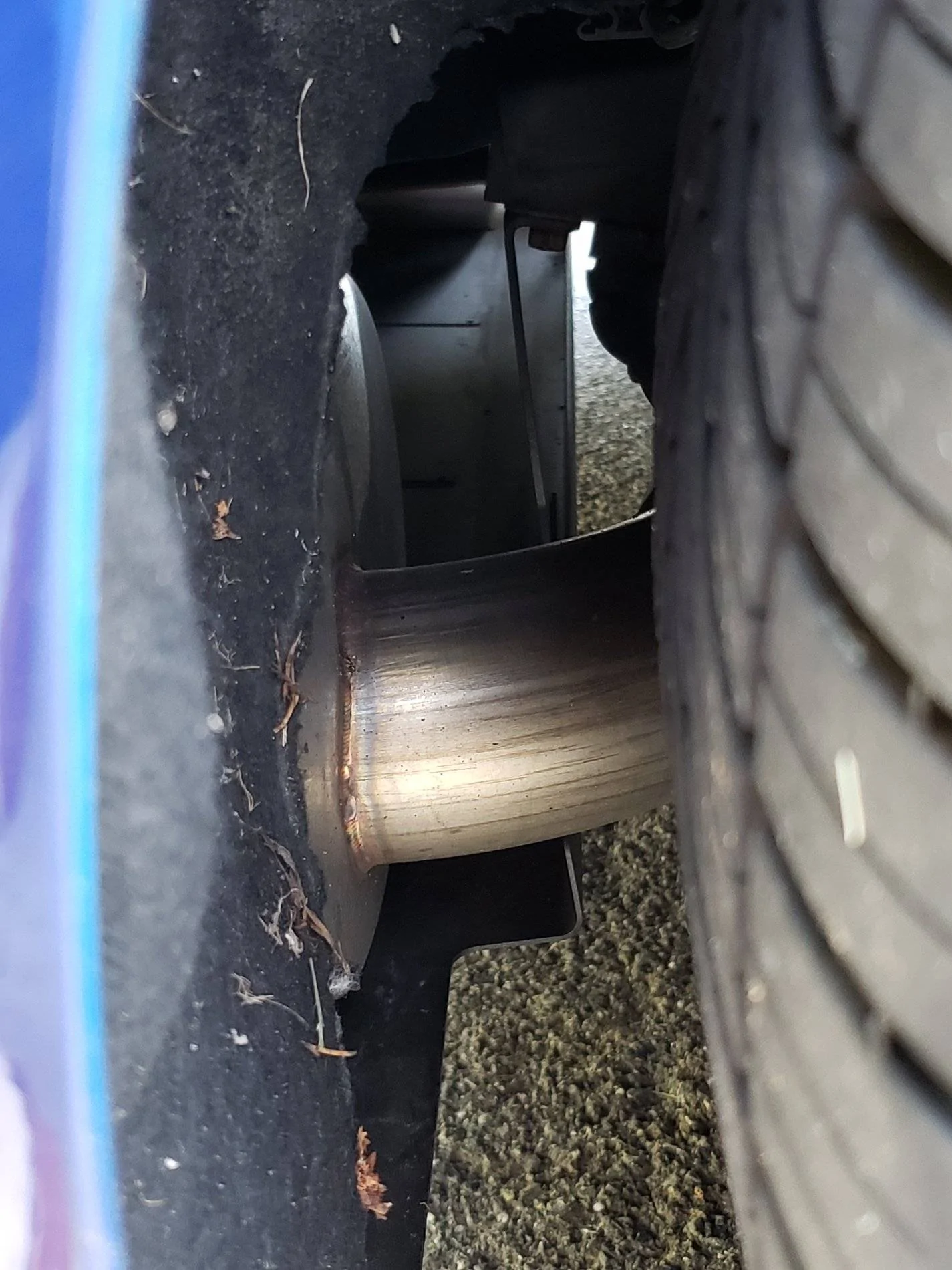

@Bluemustang how far forward does the diffuser go? If you had a diff cooler mounted right behind the diff, would the cooler be covered by the diffuser? Essentially cutting off air supply?
Bluemustang
Nov 6, 2015
151
3,969
2,348
Maryland
Ryan
2015 Mustang Base GT

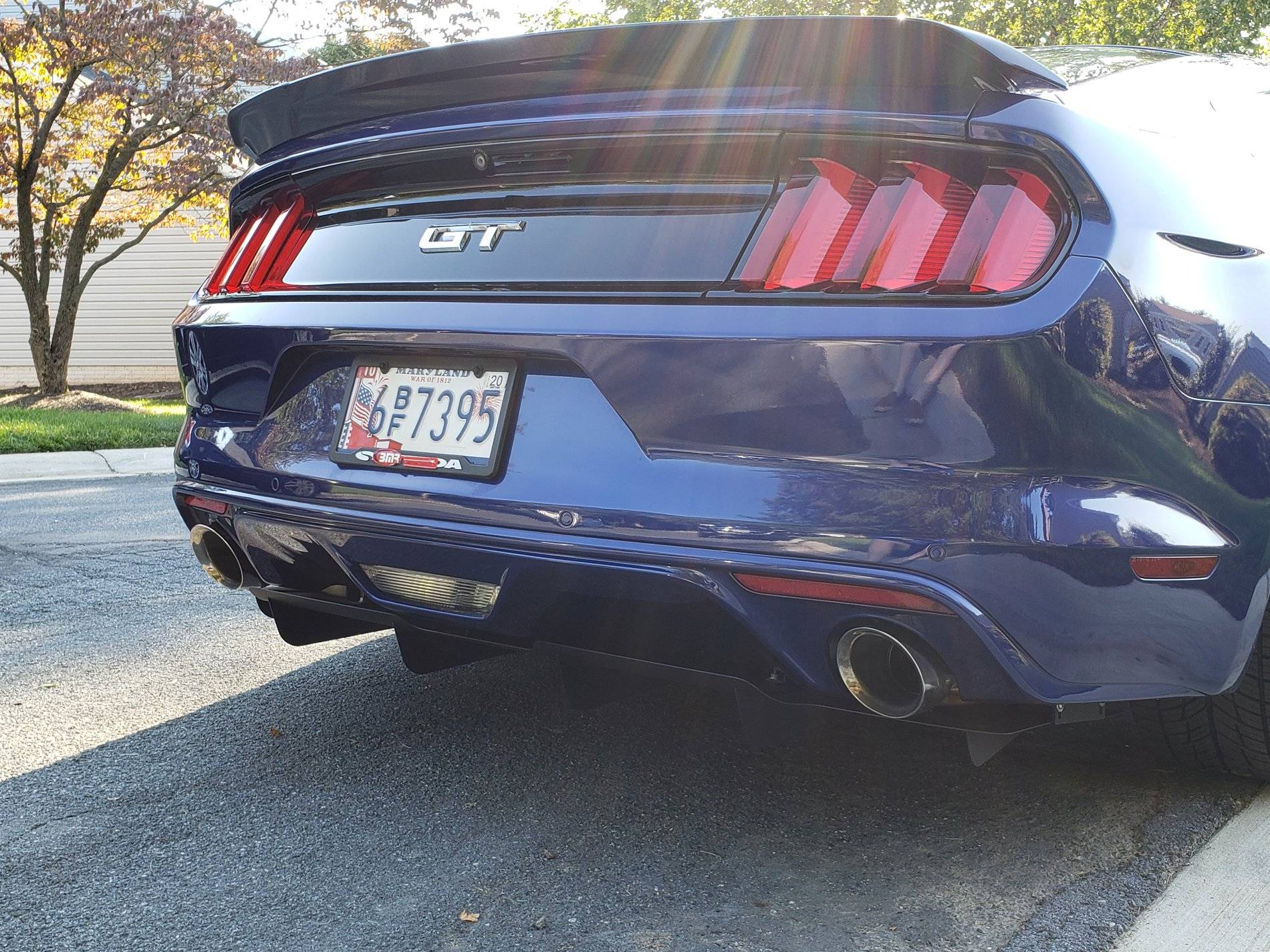

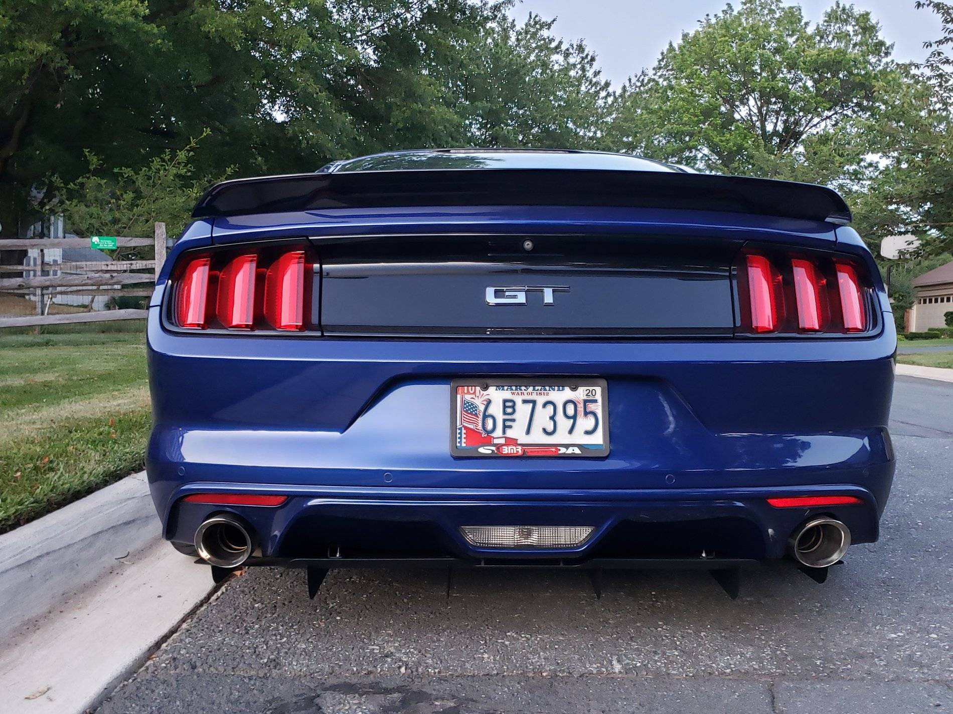

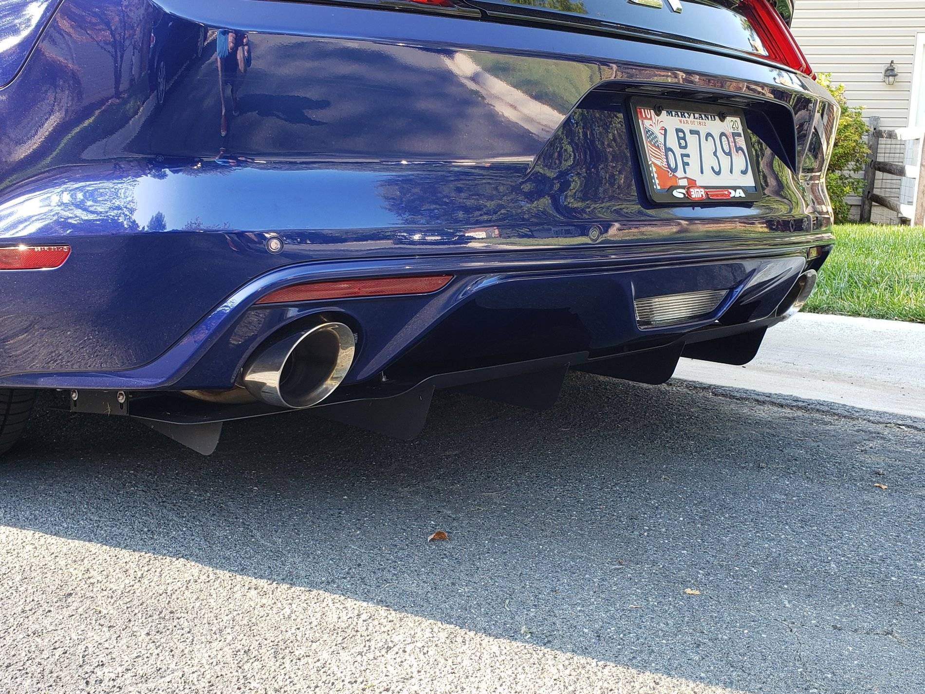

It protrudes about an inch or two past the rear body panel. Just behind where the muffler ends. Basically just enough that it extends past where the parachute starts. See attached pics.

It's nice. I personally like the effect, appearance-wise, even though I did it in order to reduce drag. In person it's subtle but adds a meaningful effect to the rear end.

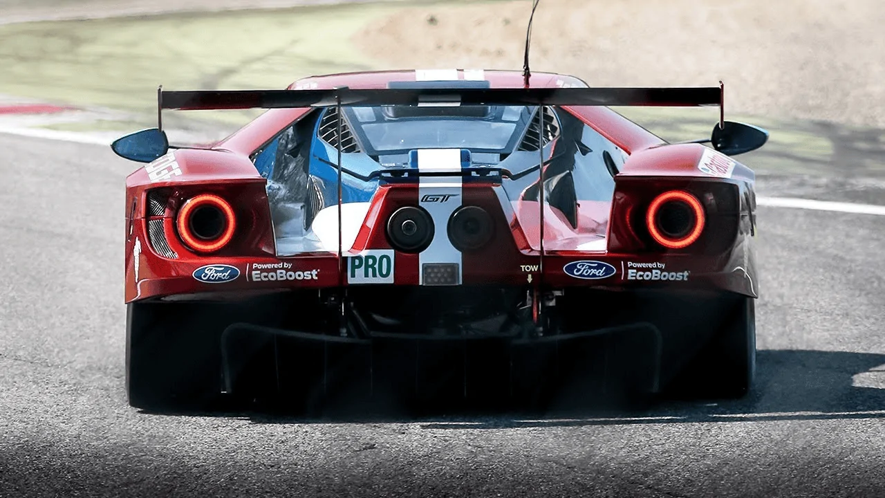

Look at the people who do real testing. They all remove bodywork from behind the rear tires and control the underbody airflow until it's completely behind the car. Rules make them keep the bodywork above the rear axle centerline.
