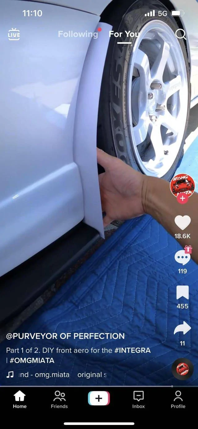

I think something like this would help quite a bit. It really wouldn't hurt drag, because with the big wheels/tires on the car the tire is out in this area anyway. Make it out of carbon and have it pick up with fender well tabs to mount (3mm FHCS with countersunk washers and captive nuts, not the plastic push-pins).
I've tested this in the wind tunnel on several cars and several sizes now. They are not very efficient and always increase drag, BUT do create a good downforce gain.

I'm so ghetto, I would have shoved a chunk of high-density foam (the kind they line server hardware shipping boxes with, or weather stripping) into that hole and called it good. :)
How about flow numbers through side rads and/or brake cooling? It seems like these arch lips should be able to have a reasonably good influence on the under-nose flow. I still go back to venting aft of the wheel-well. If you were starting from scratch, you'd have massive venting or no bodywork at all. The Mustang GT3 car is a prime example of the first idea and the BMW GT3 car is one of the other. Posting the pictures was a pain, so I gave up, lol.
Also, drag be damned, just give me downforce! (with the noted exception of Daytona)
