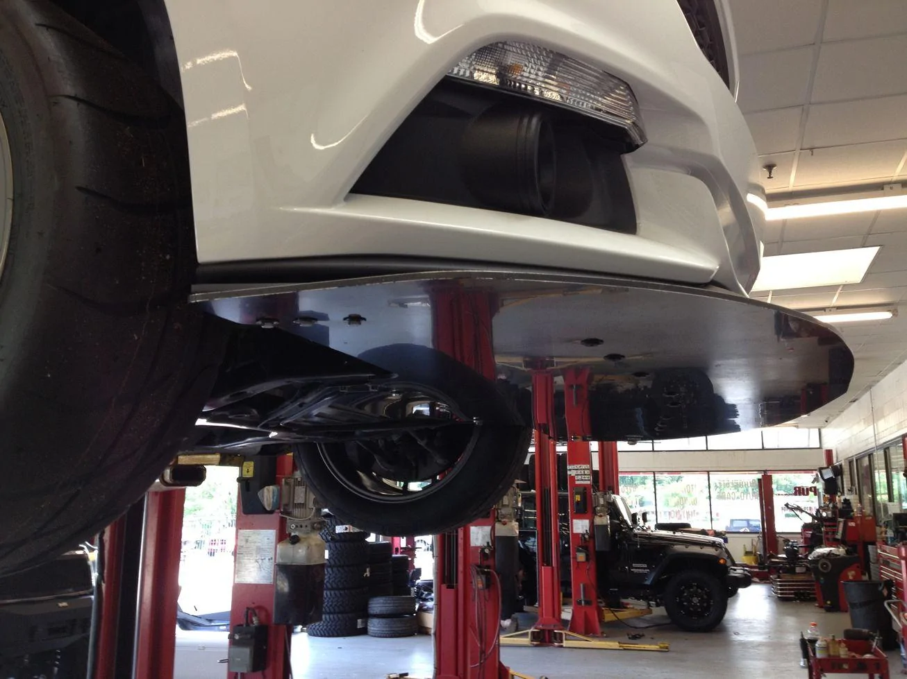

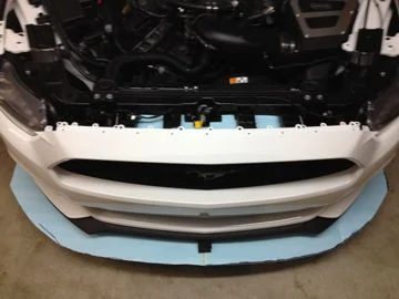

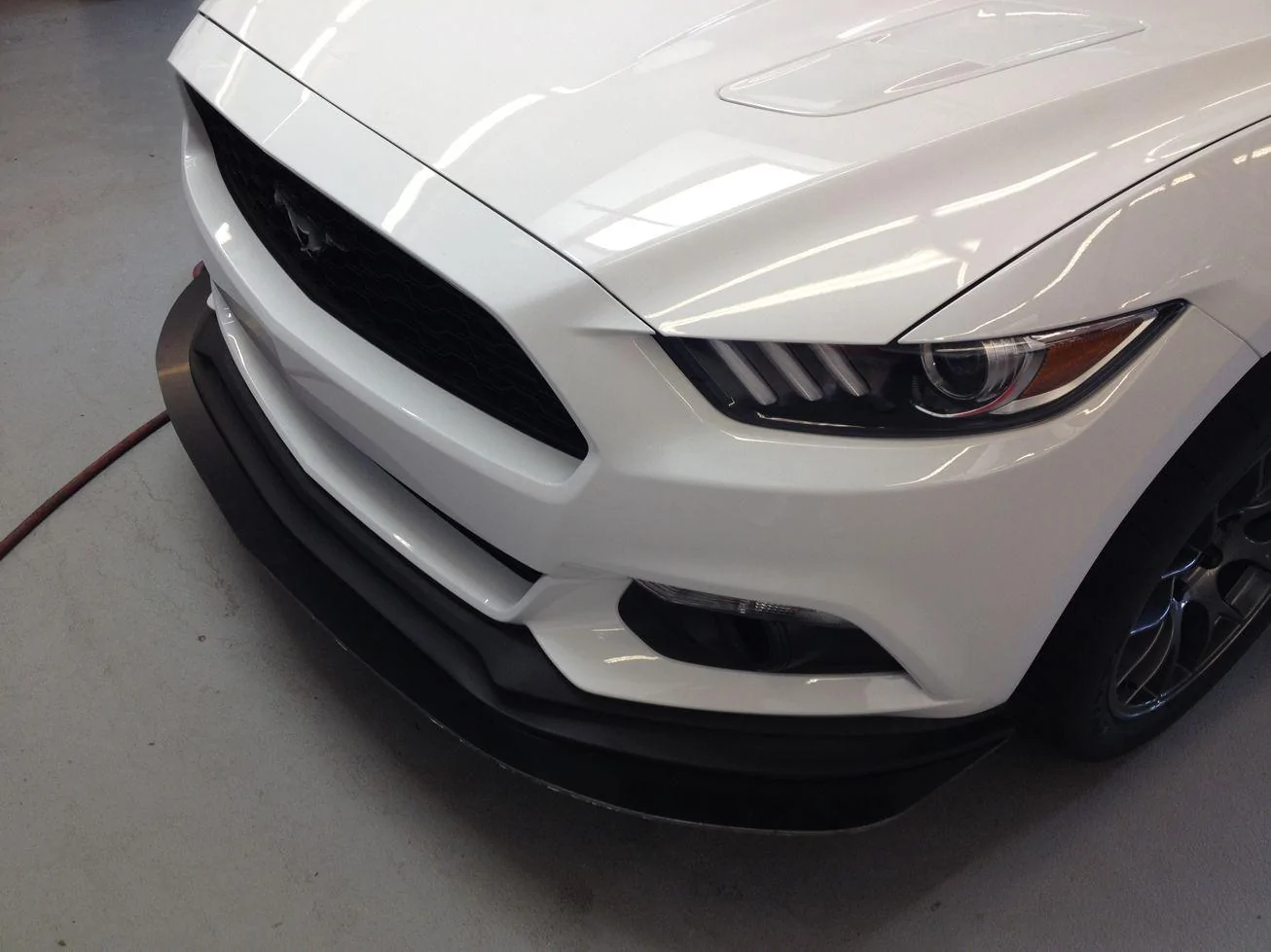

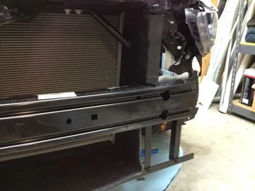

The splitter I run is a design of my own that is built to SCCA T1 rules and is made from an aluminum composite material called PolyMetal. It is cheap and relatively light considering its strength. The material choice was based on price vs weight with an emphasis on price. Other materials like Alumicor or Carbon Fiber sheeting could have been used if the focus was more on the weight of the material and less on cost.
I am making the change from a mid engine track car to a front engine track car and am expecting a learning curve that would likely need more than one splitter to be sacrificed while I learn how the driving dynamics of the two cars will effect my driving style. I wanted something cheap and easy to build and rebuild when the time comes. I needed a design that was strong and effective and could be changed at the track if needed.
I removed the front bumper and used the front OEM plastic valance to transfer the outside shape of the bumper to a foam material to make and easy to shape and light weight template. I then transferred the foam template to a piece of 5/16 masonite press board so I could use that as a router guide to cut the final material.

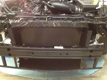

I built a structural frame that tied the front bumper mounts to a mounting system at the splitters final ride height. I used nutserts with floating nuts in the lower mounting rail for the fasteners that attach the splitter to the mount.
While I had the bumper off I removed the fog lights and used a silicone coupler and 3" aluminum tubing to build the brake duct inlets. I used high temp silicone hose to connect from the brake ducts to the rotors.
I also added the GT350R wing to the car to balance the front and rear downforce.
Here is a pictures of the setup:

Foam material for pattern: Easy to cut, sand, and shape
http://www.homedepot.com/p/Super-TUFF-R-1-2-in-x-4-ft-x-8-ft-R-3-3-Foam-Insulation-268413/100322369
Template material for pattern: Easy to sand, durable, perfect for a router guide just do not get it wet.
http://www.homedepot.com/p/MDF-Pane...ual-0-500-in-x-49-in-x-97-in-988531/206821388
Final build material: Easy to shape, rigid, inexpensive, 48lbs for 4x8 sheet, my finished splitter weight was 18lbs.
http://www.rjsign.com/SUBSTRATE-MAT...LYMETAL-PANELS/4-x-8-6mm-black-polymetal.html
Final build material: Easy to shape, leaves an edge that needs to be filled for a finished look, higher price, lighter finished product, 22lbs for 4x8 sheet but 3x price of Polymetal. Estimated finsh weight of splitter using Alumacorr is 8lbs.
http://www.nudo.com/p_alumacorr.php
Here is a good site to compare the finish material thickness and weights. All of these materials are mainly used in the sign making business so check with local sign supply houses for pricing. Also my local guys only stock 4x8 sheets but most of these materials come in larger sizes that may allow you to get 2 splitters from a single sheet. You want to find it local shipping is nearly impossible unless you are buying 20+ sheets.
http://www.multicraftplastics.com/plastics/sheet/sign_panels/sign_panels_sheet.html
