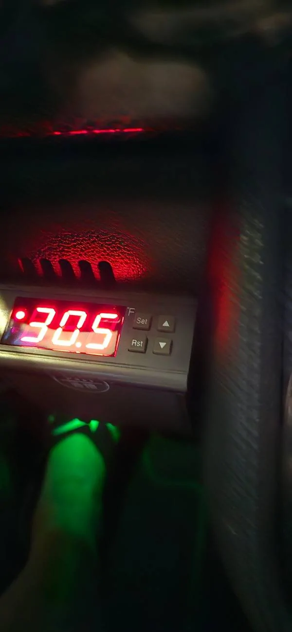

Just took my car out for a test drive with my new FI Interchiller Stage 2. After cruising, stop and go around town, a couple of WOT runs,and the coolant going into the whipple blower was 30° F. Crazy.
