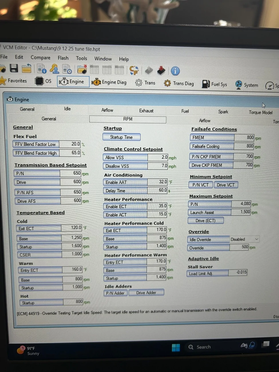

I was able to read and save a copy of the tune using the beta version. Not sure how to tell if it’s a Roush tune or if it’s been changed. Idle is set 650 P/N and 600 Drive. Can it be raised some without needing a separate tune for now. Seems a little low which may be why even before the interchiller it cooled not so great at idle.

You can find a stock roush tune posted in the forums and compare it to yours to see what was changed if anything.

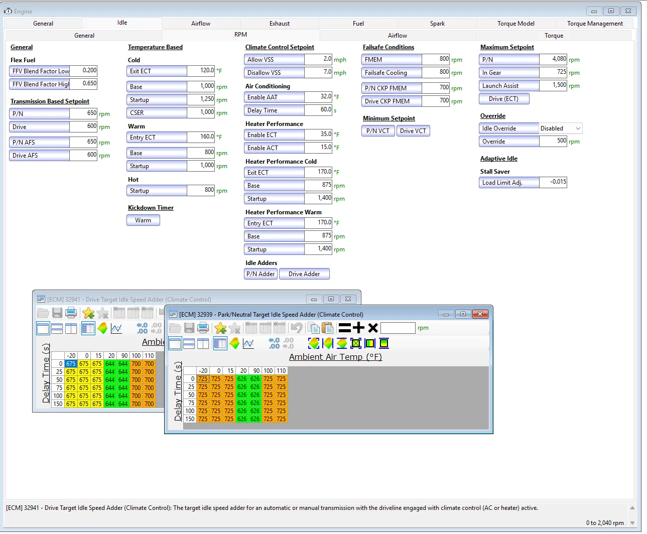

Michael Talley
2019 Mustang GT
I could not find any Roush tune files to compare mine to. At least I have a backup copy now if needed. What rpm do 2019 stock gt cars idle at in park? I found the climate control idle speed adder for park/neutral
