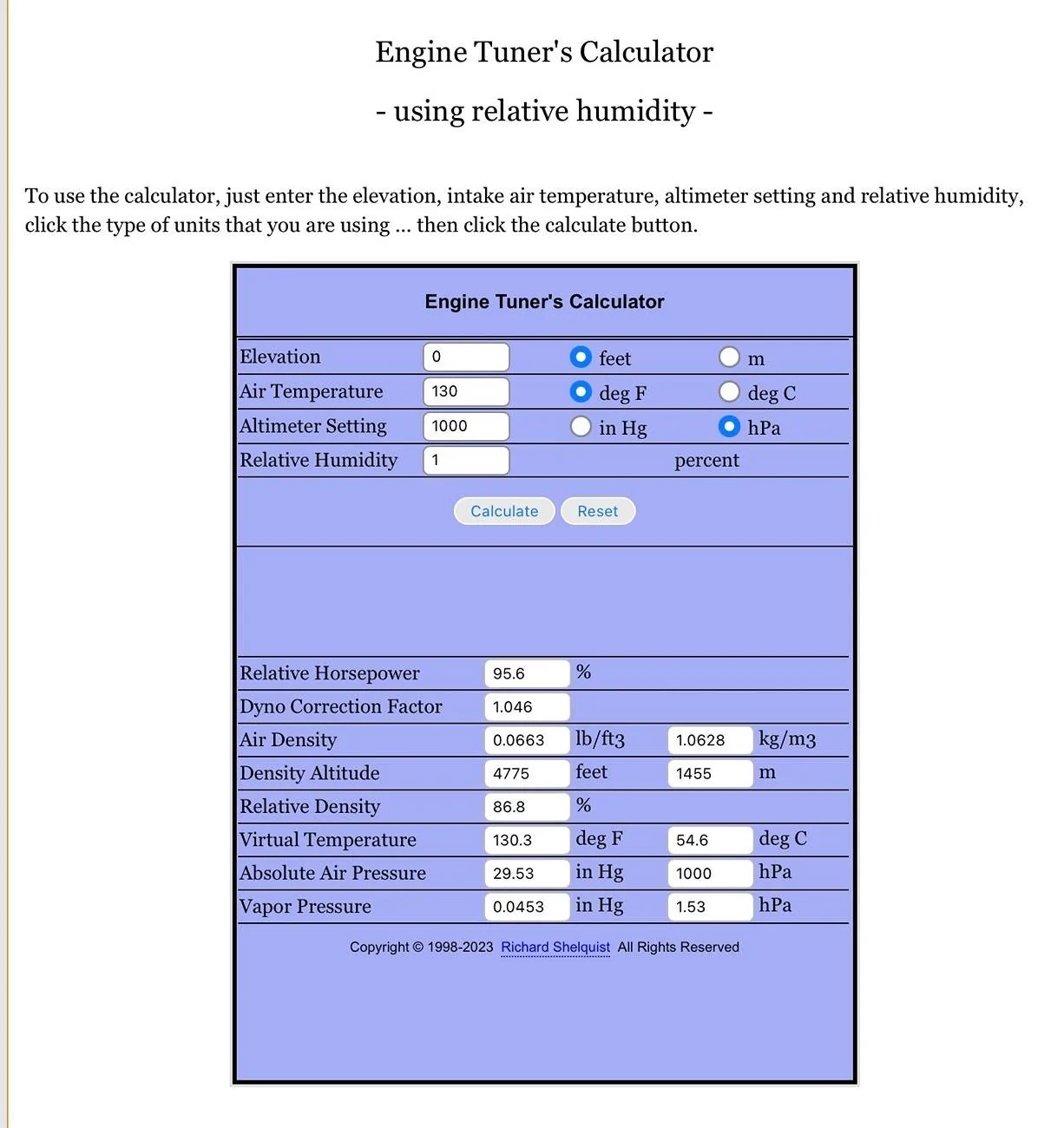

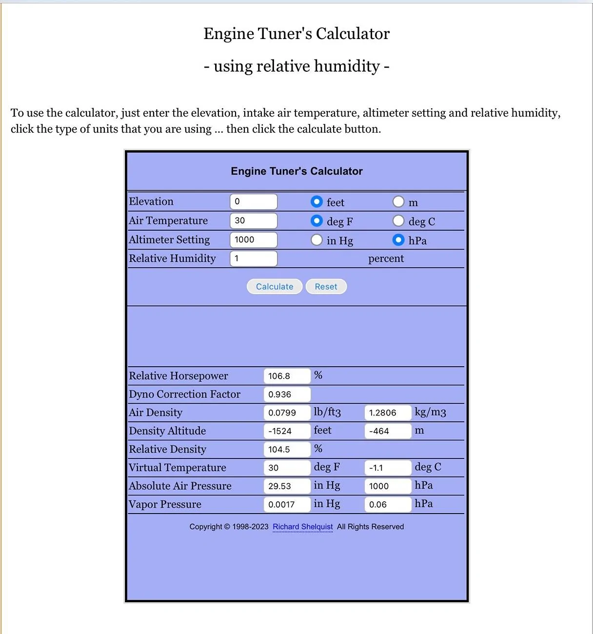

I really like the idea of an Interchiller on my future boosted build. Due to living in Australia and right now just at the start of our spring and yesterday I was ripping through the mountains in over 31‘C temps ( over 100F).
the following morning At dawn , I drove in 12‘C temps(53F). Man cars just feel so much better in cool air , and everything is cooler.
i love the idea of When your just cruising around your inlet temps are zero. Hottest I ever see is in traffic.
this engine calculator gives a good representation of power vers temps.
https://wahiduddin.net/calc/calc_hp.htm
just keeping things simple On my calc inputs , you can see a 11.6% difference in avalable HP from the air with 50F change In the air. Yes it probably less in real world. , maybe 5 to 7% Total ho gain.
still could be 50 HP on a boosted build just from air temp , and then take knock into account. Might be able to add a few degree of timing and gain another 50. makes a 100HP gain not out of the question.
